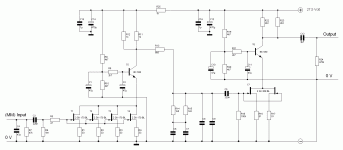

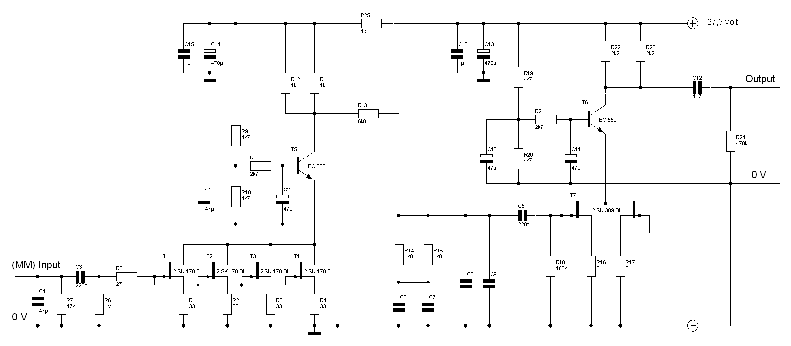

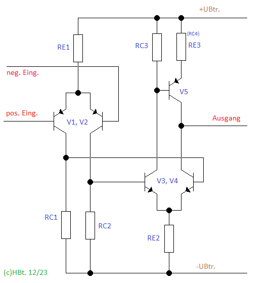

Five transistor OP-Amp.
The module could look like the photo. This topology works perfectly, but it is also not unknown. I particularly like the interchangeability, among other things the input differential amplifier can also be built with two jFets. Calculating the six ohmic resistors is child's play, you quickly have a basis with which you can do a lot. Optimizations for special applications ...
In one of my amplifiers, the jFet variant can be found in two stages as a complete preamp, with the famous LM3886 working as the output stage - I wanted to test this concept and wow.
Enough chatter!
The challenge is +80dB open loop gain, otherwise the EQ has to be set up in two stages - and anyone can do that.
Or the really hard trip follows and we have to correct the time constants, thank God our fathers and mothers left us tables for this.
Enough chatter!

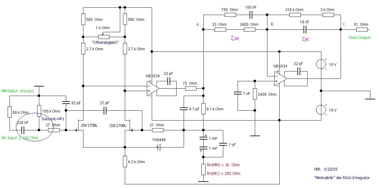

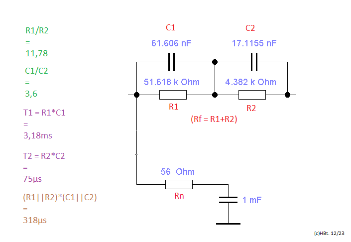

As a working basis, I suggest the following nomenclature among Europeans, see picture.

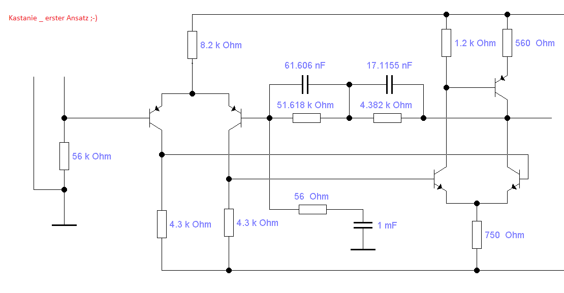

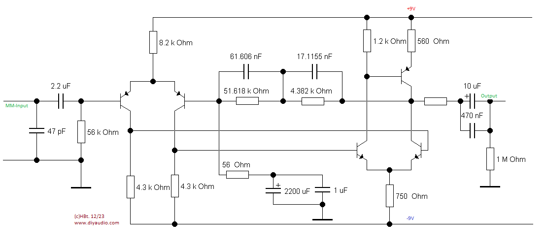

I start a first simulation with:
RE1 =8k6
RC1, RC2 = 4k3
RE2 = 3k1
RC3 = 1k2
(RC4), RE3 = 560
+/- 9Vdc
I won't explain my further procedure (the actual work and art) in detail - this isn't a workshop or anything else.
RE1 =8k6
RC1, RC2 = 4k3
RE2 = 3k1
RC3 = 1k2
(RC4), RE3 = 560
+/- 9Vdc
First results:
Vuo >= 90dB
fog >= 20kHz
rao
high impedance, which was to be expected, but is not a problem for the time being. Currently > 17kOhm (don't be alarmed, this is normal in this case).
RE1 change to 8k2 and RE2 to 750 Ohm.
Just a simulation and first impression ...
Vuo >= 90dB
fog >= 20kHz
rao

this is a pleasure. It works straight away. However, the time constants can still be corrected a little (computationally and metrologically, simulatively ...).
Here is my starting aid, this throw still has limitations - but what the heck.

Please consider what a negative feedback loop does, or what a negative feedback loop basically is.
The network presented is nothing more than a complex resistance of two resistors that feed a fraction of the output back to the input.
The dimensioning rule (cooking recipe) only applies if an ideal amplifier with a differential point is present. Its input resistance is infinitely large, its output resistance infinitely small, its slew rate enormous (and thus also its bandwidth), of course its (open loop) gain must be huge (infinite).
And that is precisely what is not the case in our example.
ra is quite large, re is actually quite ok and still low, Vuo is sufficiently large for our purpose at just under 31623.
Now the closed loop comes into play and we have a control loop, we know the principle of the vanishing input variable - apparently automatically the input resistance increases dynamically and the output resistance decreases.
Unfortunately -
our coupling factor is not linear, it is frequency-dependent because our negative feedback network (Rn forms a divider, a four-pole) is complex.
our ra (also re) is now frequency-dependent and not constant; between 500Hz and 2k1221, ra is 50 ohms (roughly speaking).
Below this it increases linearly, above it decreases linearly - theoretically.
That's why I think it's great that you want to take on the challenge, the old school way.
Our fathers and great-grandfathers mastered this problem, even with just two, sometimes three transistors or two triode tubes.
With integrated operational amplifiers, anyone can do it nowadays and if you plant the RIAA network passively between two linear stages, it's even really easy.

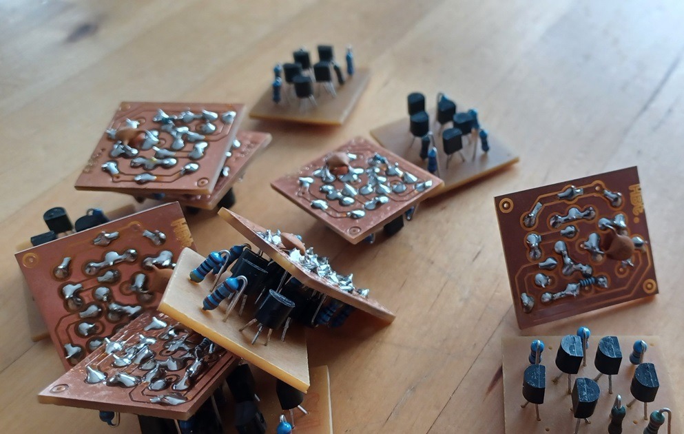

I'm still in process of checking which parts are best suited for the application and are still available.
Somehow I realized I probably need to give up the TO90 body type and except some three/six legged SMD as the LS844.
I'm on the hunt to find something comparable to the OOP LS170 - there must be more than only this little guy.

Deeply immersed in the simulation
I specify
no abnormalities, deviations from the RIAA playback curve in the range between 30Hz and 15kHz less than +/- 0.15dB.
The rolloff of the inevitably occurring fourth time constant is just under 200kHz, which is completely unproblematic. If we want to correct this, we add a 1kOhm and 1nF low-pass filter at the end.
The dynamic input resistance is around 47k,
so everything is already in order. I'm confident that we'll get a handy little EQ up and running - I can do the real measurements.

Then I'll draw a circuit diagram and check the possible noise behavior - my Christmas present.
What name should the EQ have, something mythological perhaps?
R1 = 51k1 plus 511 Ohm
R2 = 4k3 plus 82 Ohm
C1 = (100nF plus 150nF) || 1n5F
C2 = (33nF plus 33nF) || (470pF till 560pF)
plus means in series!
The output noise power in the entire audio range drops (RIAA-typical) from 10^-11 to 10^-15 [V^2/Hz]. At full scale - we can therefore expect an acceptable SNR for MM.

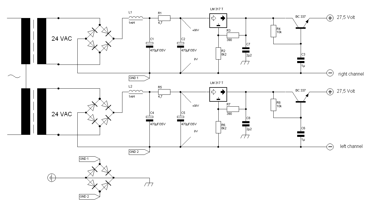

A test setup could start now, but don't forget the blocking capacitors and 4700µF support capacitors.
BC550 & BC560 type C should also work well.
The optimum can be found later, also the best and lowest noise transistors as well as an adapted dimensioning of the resistors.
Have fun with it - everyone is welcome to try it out here and post their results and thoughts. Santa clauses (may) step forward ..!
HBt.

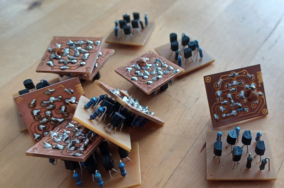

We already know the gain and the RIAA network. We want to do the entire phono pre in a discrete way. For the moment I'm checking the possibilities we got on hand with dual-jfets. Direct thermally coupled pairs with a high possibility to have minimal tolerances.
Somehow I'm already stuck with the ls844...
...but you are right - starting with the bc550/560s on a breadboard should do the trick for proof of concept.

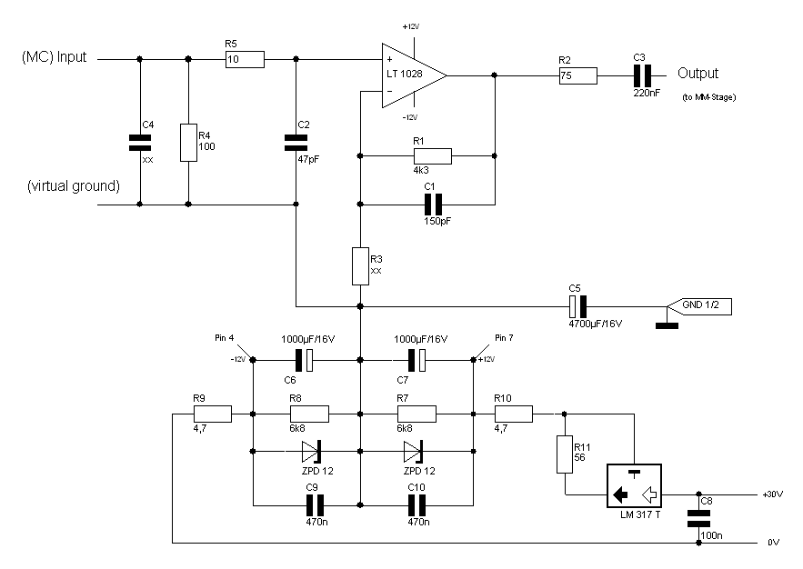

In all my archive and computer chaos, I can't find what I'm looking for. But I stumbled across the plans for my last PEARL 1, the original pearl ... here you can see, among other things, a simple and clever parallel regulator for the power supply ... here is it +/-12Vdc ..! But you can clearly recognize the principle and can use 9.1V Z-diodes.
(The original comes from an NAD-PP2 from 2005)

I'm a bit tired right now, but there was something about FETs or bipolar transistors at the input of MM preamps. At the moment I can't figure it out, we could ask Marcel van de Gevel (he's also active on this board) or search for his articles and papers. There was once something ...
If I understand you correctly, you would also consider a differential amplifier with jFets as your first choice.
This can be done, and is often used in consumer devices, but followed by an operational amplifier - and that's not stupid at all.
The simulations of the last suggestion #94 look really good, it's simply worth a try. I could send you my SPICE file, but you can quickly enter it yourself.
Cool,
it's coming along - all we really need is a layout with the components of our choice - and off we go.
If only I didn't already have 1001 equalizers, what should I do?
Cool,

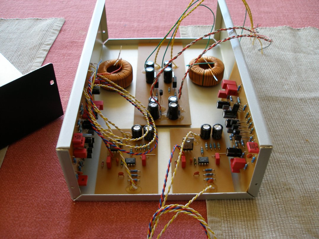

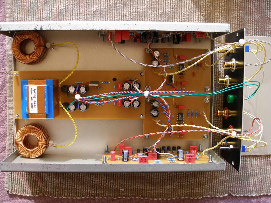

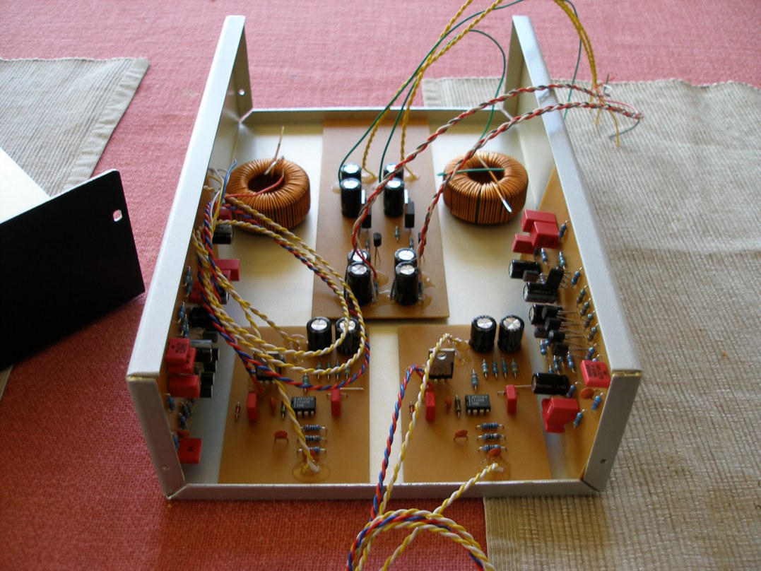

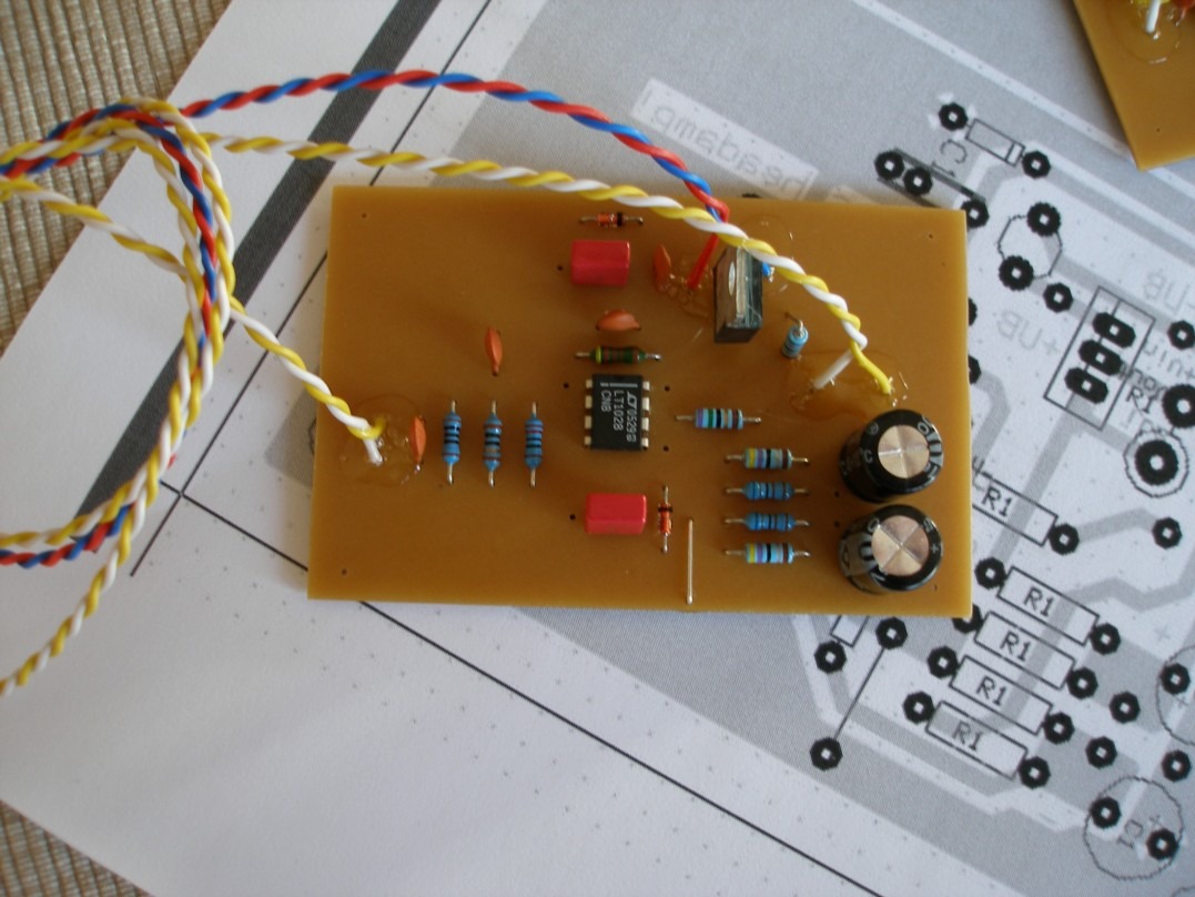

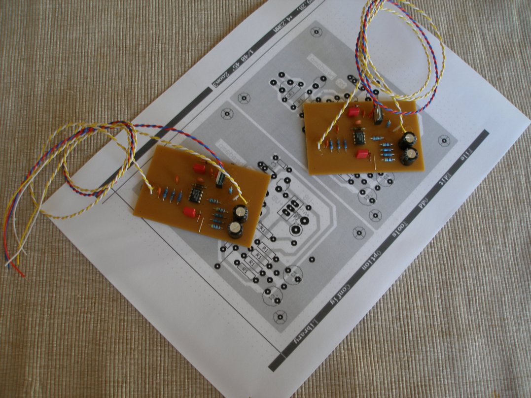

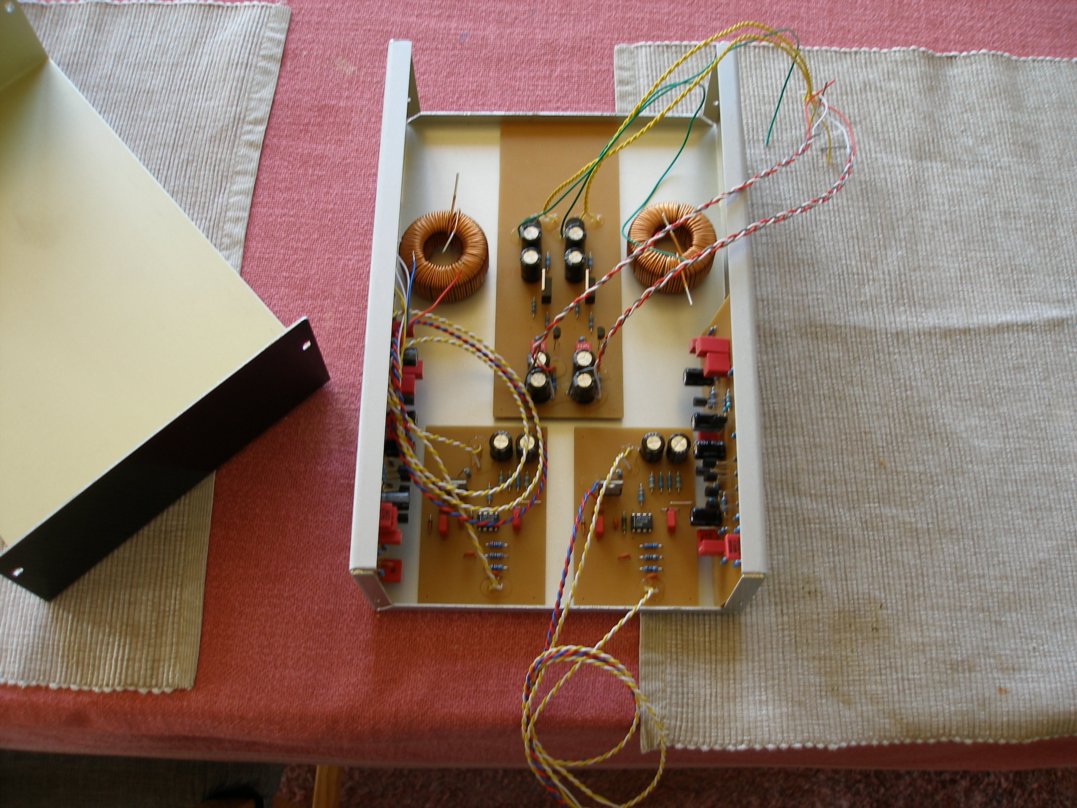

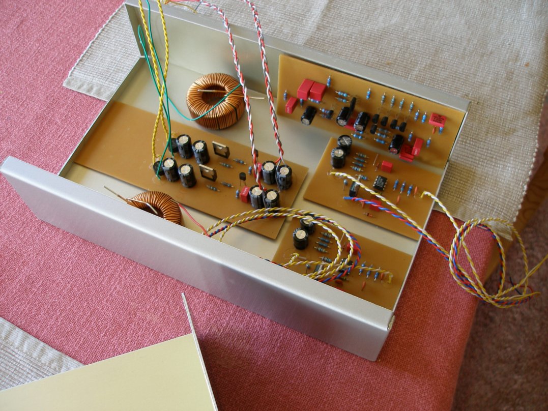

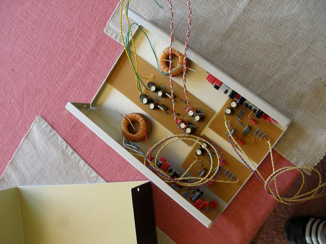

From the photo album of the little Haudegen,
a pearl.
Note from the narrator:
A real handicraft (not the final version) work by our hero,
(look) with this funny record player from the ninth Musical Fidelity CEO (from Vienna).
a pearl.
My god, if you look for something, you might find it eventually:
Between 2010 and 2017, I had an intensive long-distance exchange with a good friend, during which time countless ideas flitted through our heads, followed by just as many analyses ... and that at my age.
Of course, the RIAA approximation can also be implemented as a PID controller. This is not a new idea and it did not come from me, in 1990 I saw it in an application note.
Somehow the idea never left me (and now it appears in a parallel thread...). I didn't want to simply copy an AN and so the equalizer "Minimalistik" saw the light of day 25 years later. With battery supply to avoid any interference ... a really great sound, everyone immediately falls in love with this little equalizer ...
For me, this is first and foremost the "RIAA integrator" par excellence.
Greetings,
HBt.
