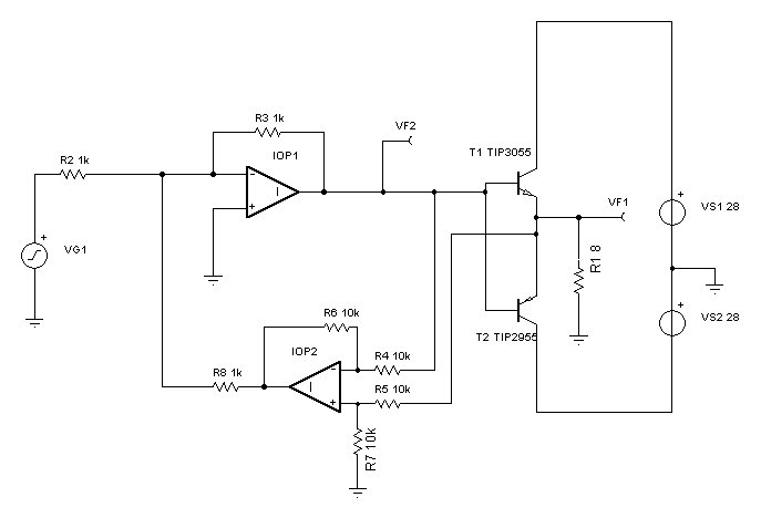

Ahum... I am extremely suspicious of anything that cannot be explained in a maximum of one page (font size 12), but we'll see...
Jan Didden
janneman said:
Note that for this to work the collector current must be exactly correct to develop the correction voltage over the Vas output impedance. If for instance the Vas output resistance is 1k ohms, the collector current variation must be exactly 1mA per volts deviation of the output stage input/output voltage.
How does one deal with this problem? The VAS output impedance will heavily depend on excursion and frequency.
janneman said:
In my experience, the Hawksford correction conceptually works very well, but there are several secondary effects to take care of in practise. On the other hand, the simple implementation already decreases output stage non-linearity by anything from 20 to 40 dB, so it's worth while for a very moderate cost.
Jan Didden
Sorry about this, happens in monster threads: I overlooked something a few pages further.
So Jan, you are proposing to buffer the VAS (which is always a good idea) and then put a series impedance between buffer out and output stage in?
Wouldn't we still be faced with buffer output impedance nonlinearity?

Well Eric, actually you should also buffer the output stage input, because that is also non-linear. I did some sims with such a setup, using 1K for series resistance from the output of the Vas buffer to the input of the output stage input buffer (if you follow me...). The correction circuit had a gain of 1mA per Volt. It worked like a charm, almost a perfect gain of one power stage.
I'm working on a proto pcb for it to try it out irl.
Jan Didden

janneman said:Well Eric, actually you should also buffer the output stage input, because that is also non-linear.
Jan Didden
Correct.
Eric,
This is the concept that takes also care of the secondary issues. Of course, the important question is how in practise you can cut away a lot of the pheripheral stuff while maintaining performance with a simple/small circuit.
That's where good designers make their money..
Jan Didden

PMA said:You have not disclosed much in your circuit, Jan
Oh I wouldn't say that. I've just put this proof-of-concept together in SPICE. It proves that it's workable. (OK, I've used perfect op-amps but it's worth trying with other ways of implementing it).
Well, I have reduced many Hawksford pages to just one drawing. Everything is there. This is the important and difficult part. The rest, as they say, are the boring details.
There must be 1000's of buffers and output stages floating around on this forum that can be used.
Hawksford, and others like Steven, have shown simple V->I converters of just one or two bjt's.
Of course, I intend to be original, but you will forgive me for not putting that up on the forum.
Jan Didden
That's the spirit! Exactly the way I did it. I used a darlington complementary output stage with 'real' transistors, and ideal buffers.
IMHO, this is the way to verify proof-of-concept. You don't want to bother in this stage with non-linear opamps, oscillations etc. First you want to be sure your idea is not flawed. You want to see that the concept really takes care of the real output stage non-linearities. Then you start to put in 'real' components for the other parts, try to keep up the high performance, and even try some simplifications.
YMMV
Jan Didden
