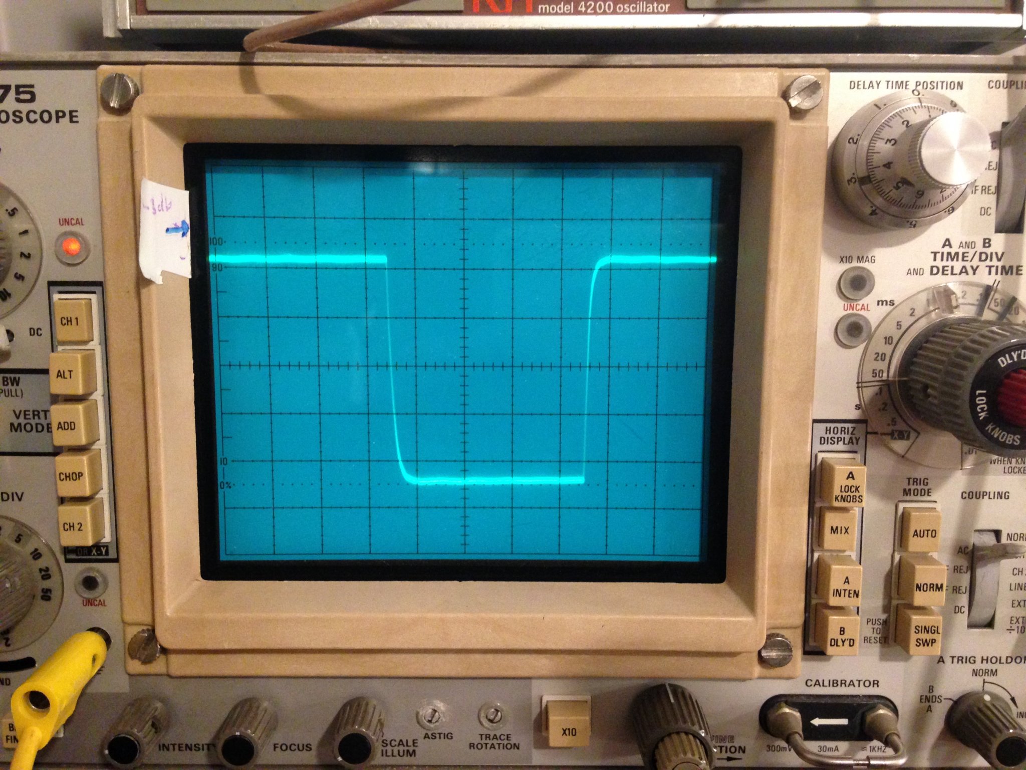

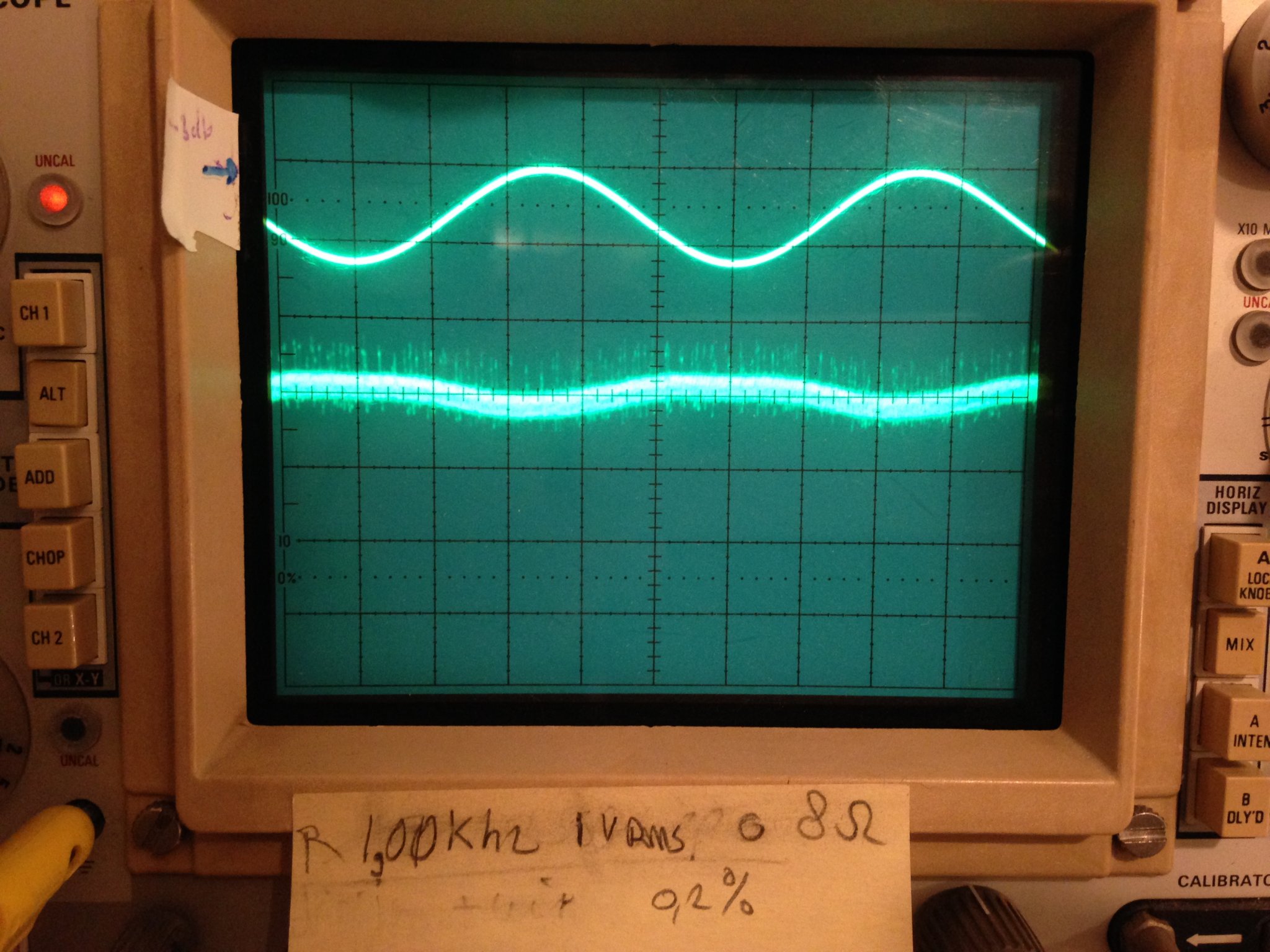

In my latest build I used a switched mode power supply: 220V to 12V6.
It had terrific noise on the ECC88/PCC88. The whole earth line was polluted as seen here in a distortion picture:
I had connected the 12V negative to the earth. It leaked somewhat via the filament.
Then I connected the V- of the fil supply to the plus of my 36V amplifier rail, the average VFil-cath negative became -42V. That stopped all leaking. I connected it with 10kΩ and a 6.8µF to the earth.
(100mVpp) It is clean now.
So the filament barrier of my Tesla tubes is very prone to leaking. I had not decoupled the 150 Ω cathode cap; that should have reduced it a bit.

I found out that with a switched supply you MUST ensure the two power lines have the same polarity and that live is indeed live and neutral indeed so too. It might then not be the Tesla tubes leaking but the SMPS that is leaking and making noise. When all is OK and I ensure the right polarity I have a output noise now of 0,1 mV RMS. Not bad for a tube.

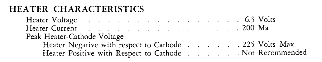

You'll definitely want to reference heater voltage to somewhere very near cathode voltage. The anodes on these beam regulator triodes have their own pin at the top of the glass envelope, for which you'll need a dedicated connector, which isolates anode voltages from everything else.

It would seem obvious that any such circuit would need over-voltage protection on every aspect, with design showing all failure modes are managed, including basic arcing within the tube to any of its base terminals (due to going gassy).

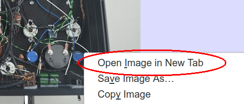

@OldHector that's because it's already at full resolution. Instead you might open it separately and use Ctrl and + to zoom in on it.

Here’s a larger versionI tried to open it in full screen to see a more detailed view but its size is fixed. Maybe just by laptop browser.
