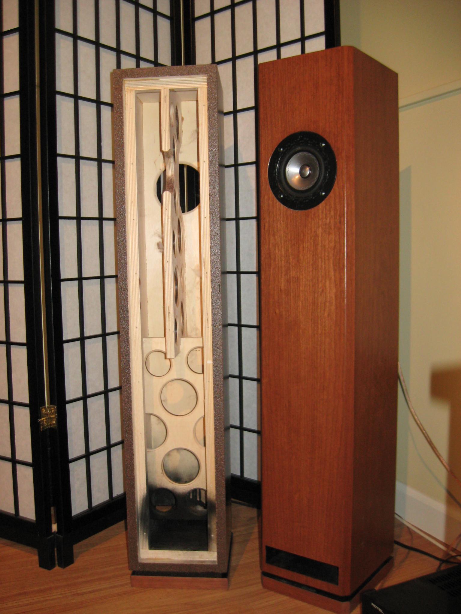

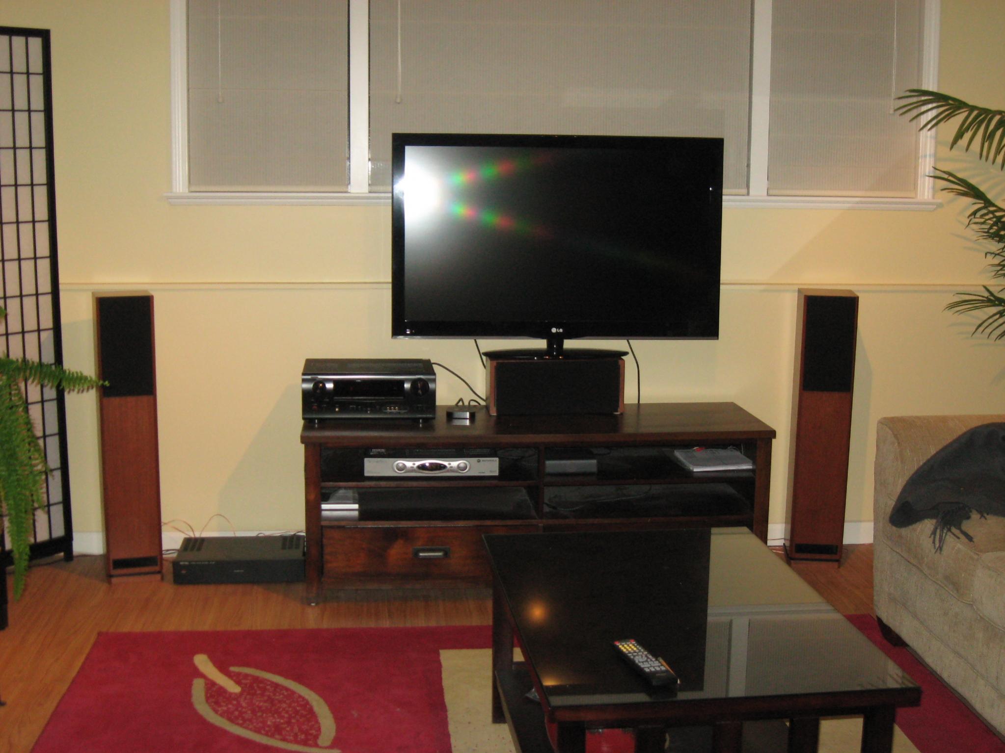

While this is the multi-way forum, since it appears you've nominated the Alpair7.3, the Pensil7.3 can be a fairly inobtrusive WAF friendly enough enclosure that sounds quite decent as well.
I cross mine over at 110Hz via the HT receiver, and run a pair of dual 7" driver woofers for the LFE channel.

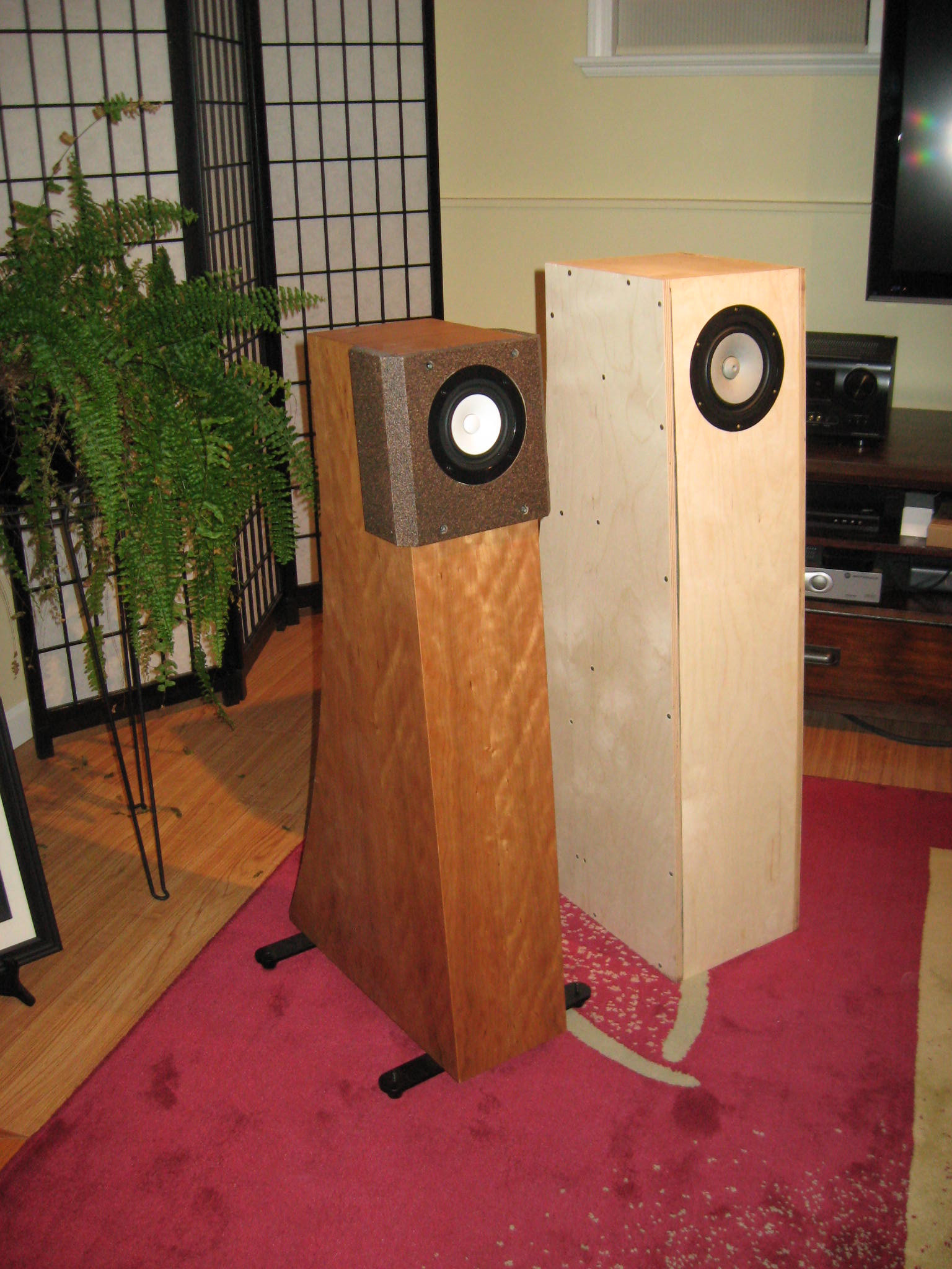

Then there's the FH3 (MAOP7s shown here in cherry veneer with removable supr-baffles) - some gals like them enough

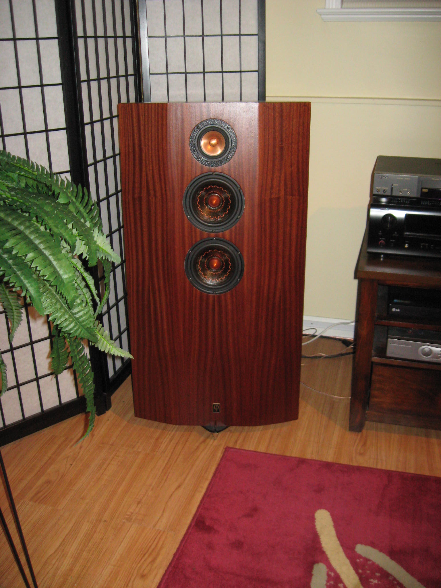

Of course, if you want a true multiway with A7s, that's quite doable as well (these one are active with PLLXO)

That is some gorgeous woodwork (first pic)!
You are right that I should build something that suits me as well, best case is that I find something that we both like 🙂
The B&W diamond series is pretty in my opinion, I'll add them to the list (maybe slim the design down a little).

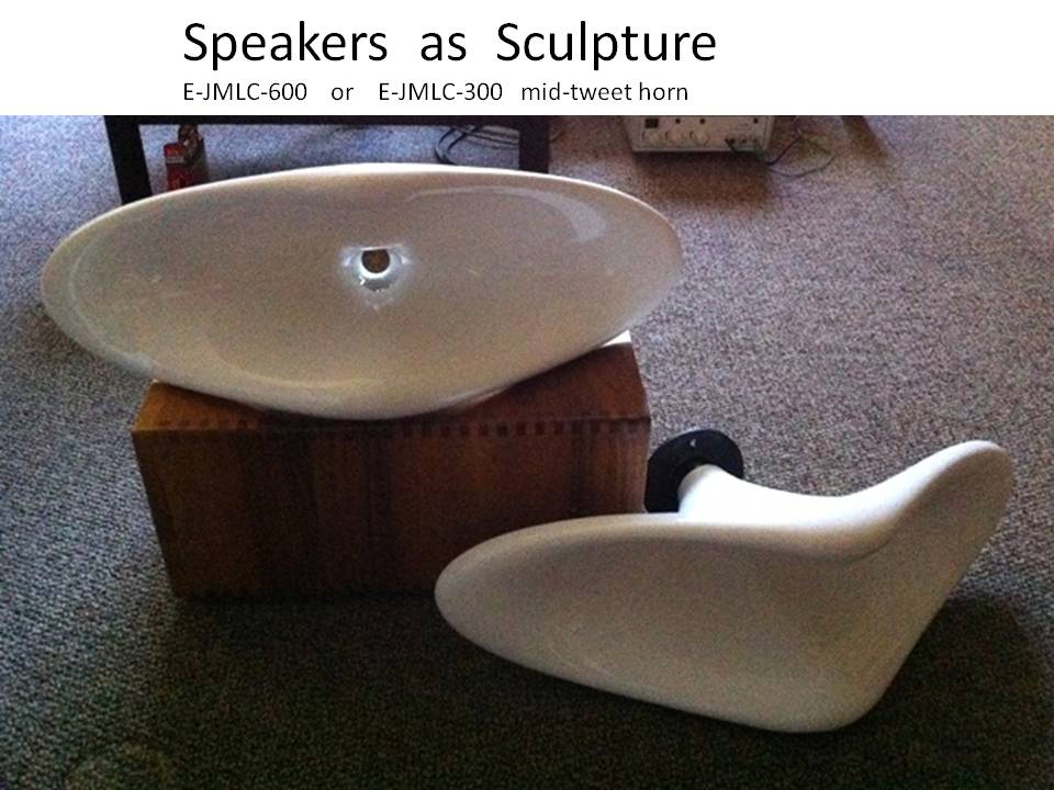

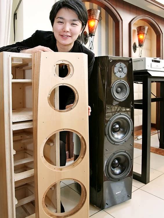

Speaker Sculpture.
Objects of Art.
Designed to be SEEN and HEARD.
(pic of Sony SS-AR1 TMWW construction)
Finish in black, or cover with black nylon sock.
Roll on wall paint to blend in.
Tweeter at 39" - 42" ear height puts TM above cabinet.
