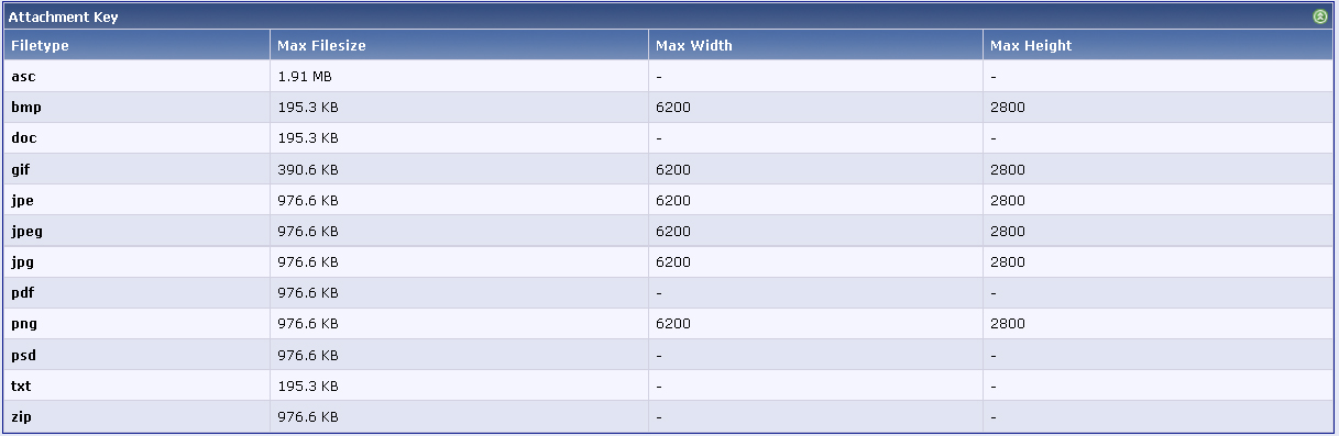

Interesting! I'll check them out. (Why does the forum change the aspect ratio of pictures?)A speaker don't need to be placed descrete to have WAF, if it don't look like a speaker.

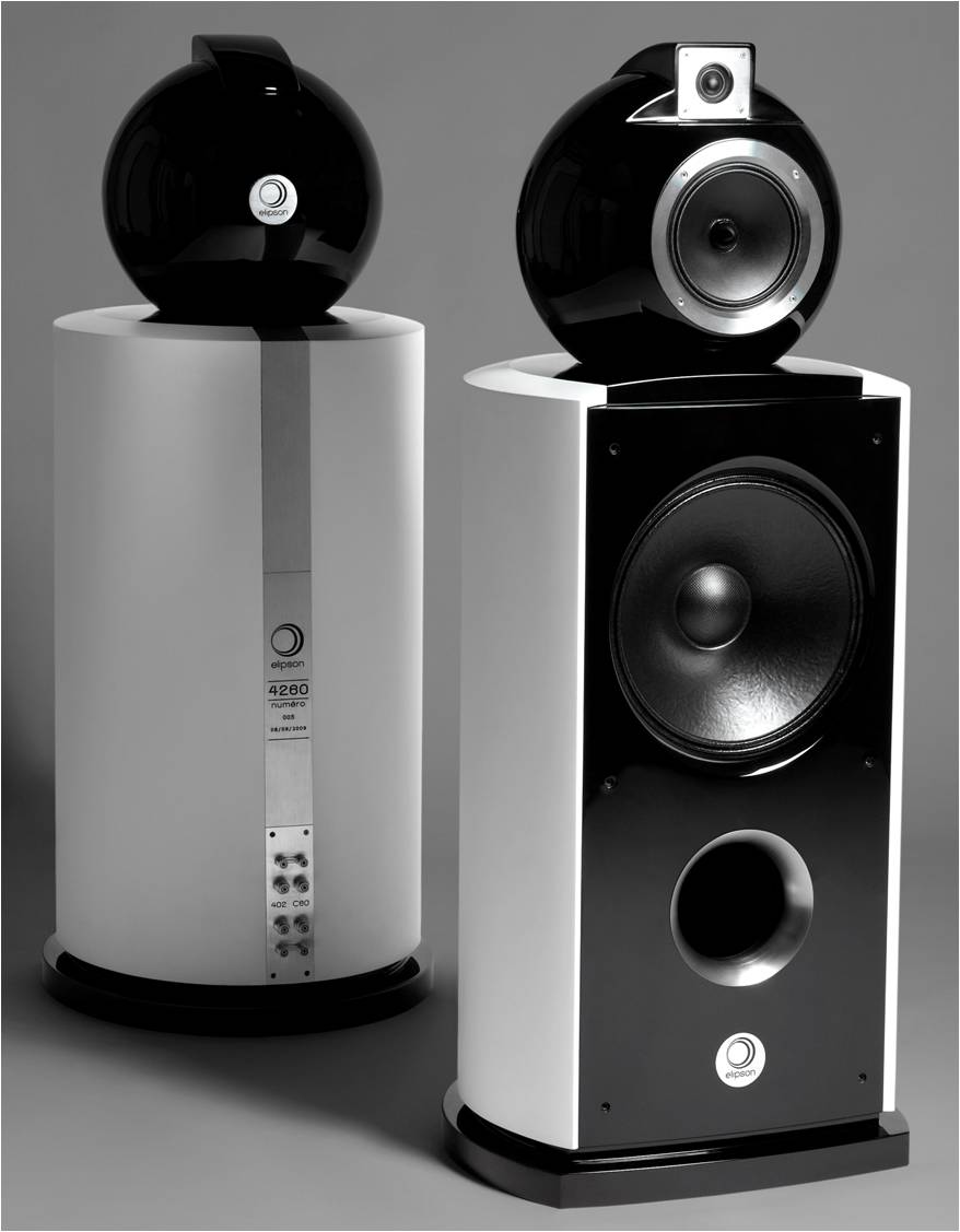

Form Follows Function
Function: Low cabinet diffraction.
Form: Sphere+rear tapered tube.
(white papers at B&W Nautilus)
To gain full advantage of the sphere's minimal diffraction requires an almost free standing sphere. Lose some value when near rear wall.

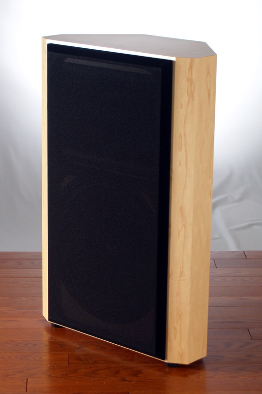

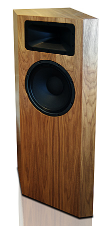

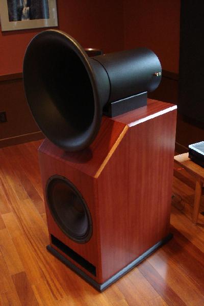

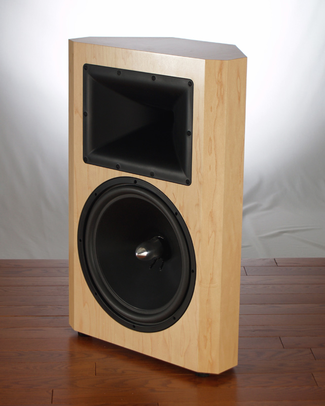

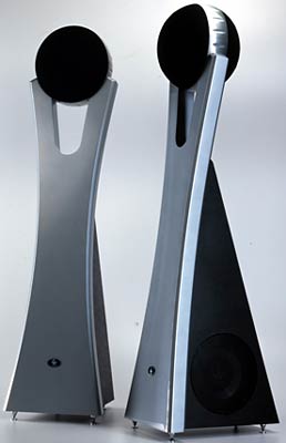

What design is depicted in the bottom left?
Robert Miller of WW Speaker Cabinets and Mark Seaton built the HQ-15-Maple speaker pictured in 2007. I think it was only in production for a couple years. sales@seatonsound.net
Duke who owns Audio Kinesis has a Prisma cabinet shape with a 45 degree angled rear joint. AudioKinesis - sound that moves you
Several diy clones of this cabinet shape were clean sheet designed and constructed in the AVS group. The SEOS18 and SEOS24 waveguides have launched new designs with this cabinet shape, a TD15M sealed midbass, plus a TD15S woofer (~53" high with 42" ear level SEOS24)
