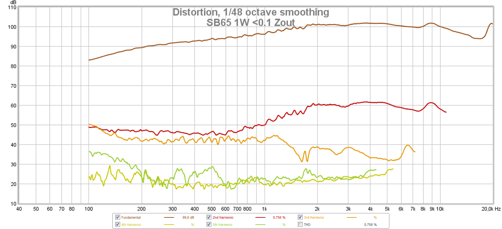

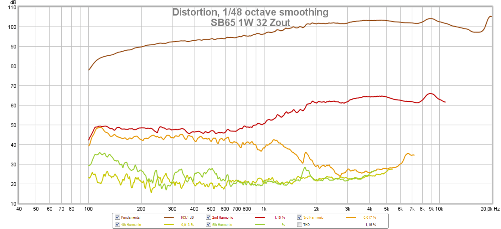

A more reasonable example is the SB65WBAC25-4. It has copper in the motor to linearize inductance but a more reasonable amount. The benefit isn't as big as the 6ND430 but still a reduction on the top end.

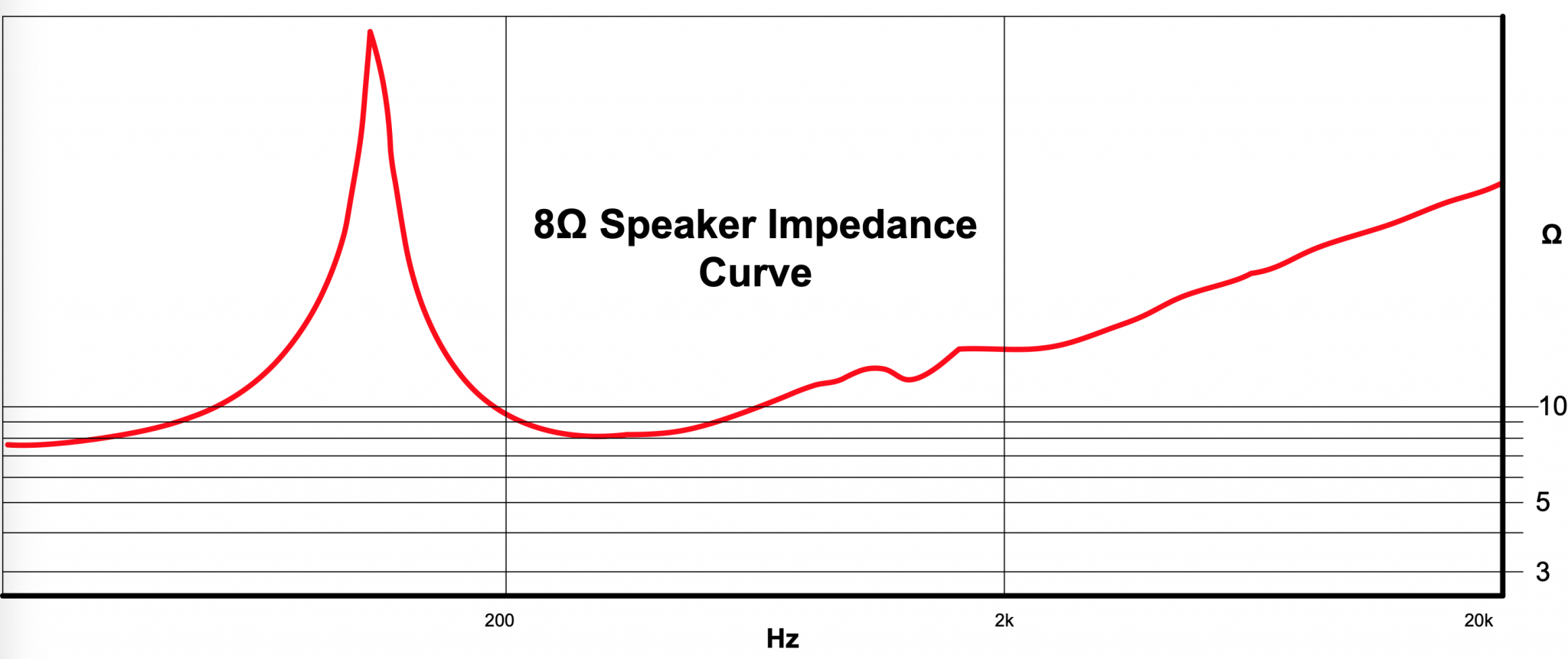

Now in a 2 or 3 way system, impedance varies wildly across the audible range, unexpected peaks and dips within the passband can become ugly
You sure you want that huge peak around 1500 Hz?
Even worse in a 3 way.
