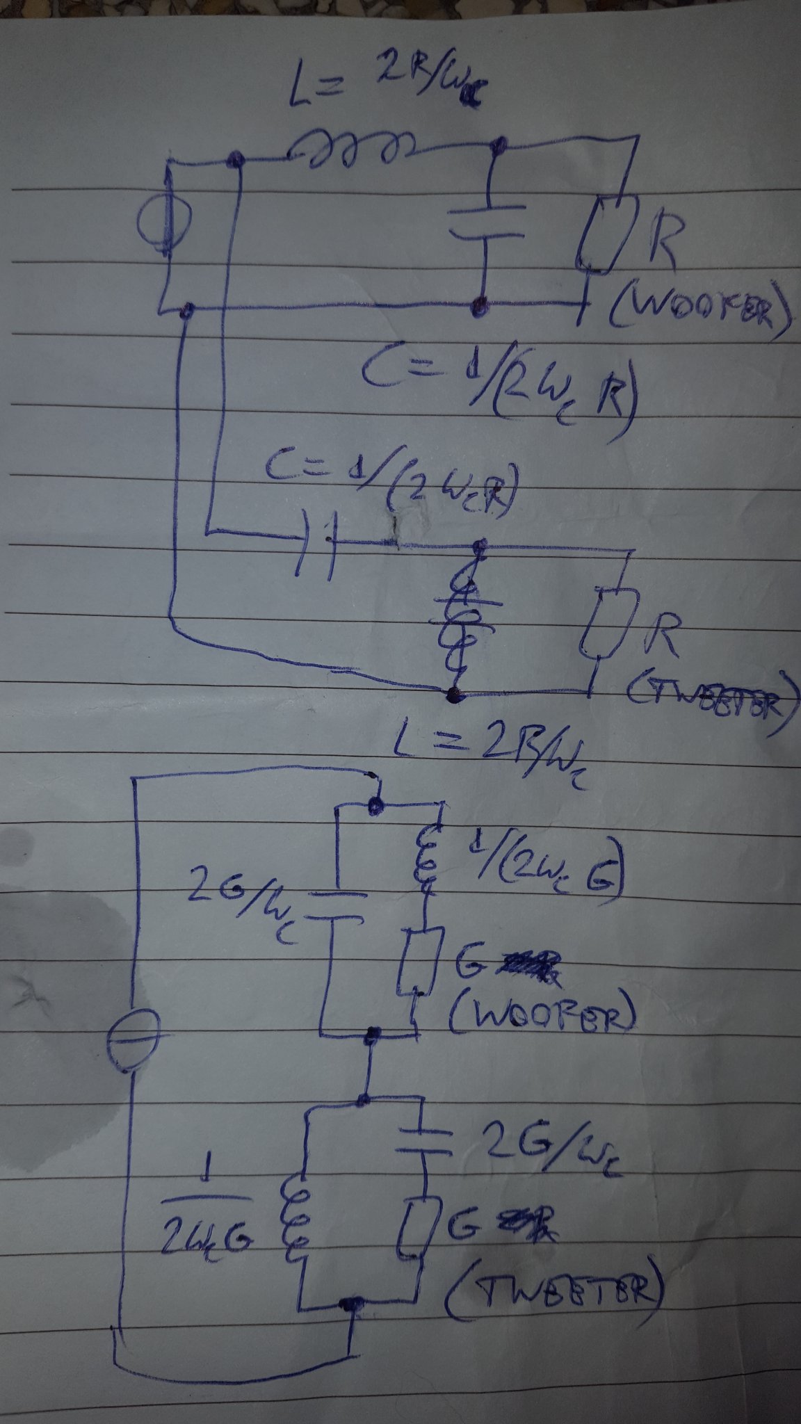

Do you mean an impedance correction network or something else? A loudspeaker with an LRC series network shunted across it driven from an amplifier with current output would effectively have mixed drive: driving impedance R at resonance, large far from resonance.Only if their is a rise in loudspeaker imoedance at resonance. If it is flat a current drive amo works fine. Elsinore Mk6 is a rare example of such a loudspeaker. He has a brute force electrical bit in the XO (could be called EQ i guess).
Regarding passive crossovers, you can design those for current drive. Of course the admittance of the crossover components will spoil the current drive to some extent, just like the impedance of the crossover components does with voltage drive.
If I didn't make any mistakes, the upper part is a voltage second-order Linkwitz-Riley crossover and the bottom part its dual, a current second-order Linkwitz-Riley crossover. Substitute G = 1/R and you see that the inductances are four times smaller and the capacitances four times larger for the current version.
Hello Jan,That's what I thought. We know that with a voltage drive amp, the output impedance determines how well the EMF is absorbed by the amp so as to damp the speaker motion resulting from its own resonance. Damping factor - and ideally the output impedance is zero so the speaker EMF is 100% absorbed and the speaker tightly damped.
With current drive, the output impedance is (ideally) infinite and there is no damping of the speaker movement by absorbing the EMF.
You can see this in for instance how the speaker freq response follows the speaker impedance response, necessitating (sp?) response equalisation.
A speaker under current drive will ring like a bell when excited mechanically. The same when excited electrically due to for instance a transient signal.
No?
Jan
