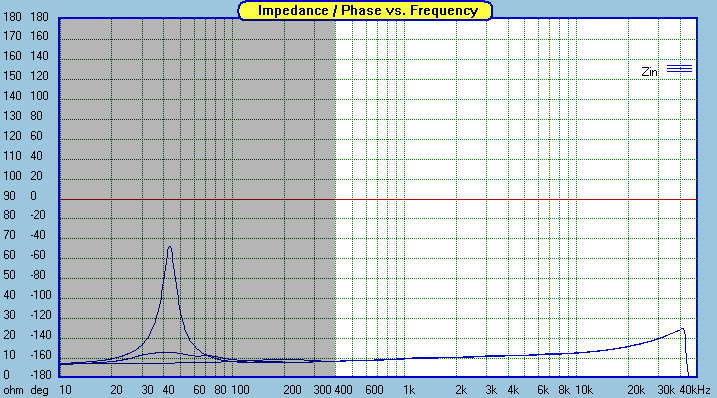

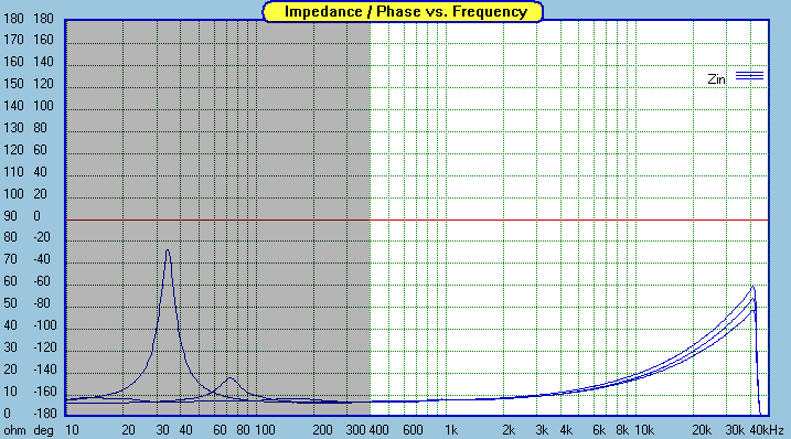

They are exactly the same if the 8Ω speaker is purely resistive, like a planar.
Most dynamic drivers are far from that They usually vary in resistance on the + and - stroke. Usually depicted as le(x) as in the inductance with respect to stroke position. If they spend $$$ on the motor they can, however, get quite close:
http://www.zaphaudio.com/Le(x)/
Compare the Scan-Speak 18W8531G ±6.5mm
To the Scan-Speak 18WU8741T00 ±8.0mm (mfg spec 6.0mm)
And notice that the 18W8531G impedance is not as linear in impedance throughout the stroke.
With a voltage amplifier, the 18W8531G will reduce output when the impedance increases, since we have a fixed voltage. The current will vary and this variance in current is extra distortion.
With a current amplifier the current is fixed. The driver will just get a little bit hotter when the impedance increases but the current will stay the same. Less distortion. Or at least less if we ignore being close to fs.
