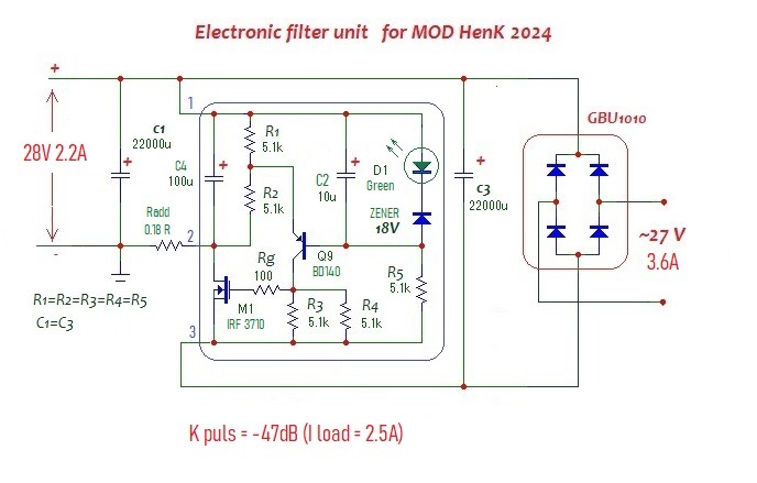

I decided on a filter/supply voltage stabilizer circuit for the unipolar version.
The filter circuit in the attachment is essentially a small board with three terminals 1 - + power supply, 2 - output to Radd, 3 - minus input from the rectifier.
The rectifier itself is made “isolated” relative to the gnd.
The power transistor used IRF3710 (max current 59A)
capacitors C2 and C4 are of small ratings, because large ratings interfere with the operation of the stabilizer filter and distort the shape of the ripples on the load.
Instead of diodes, I installed an LED to make it convenient to see that the power is on.
The ripple suppression coefficient is -47dB at a load of 2.5A, the ripple shape is almost sinusoidal. This electronic stabilizer filter is enough to connect two amplifier channels simultaneously.
if instead of an electronic filter you use a passive filter C=22000 μF + R=0.18 ohm + C=22000 μF, then with a load of 1.3 A only -12 dB is filtered and the ripple shape will be like a distorted sine wave. This means that for two channels it is advisable to use two separate such CRC filters.

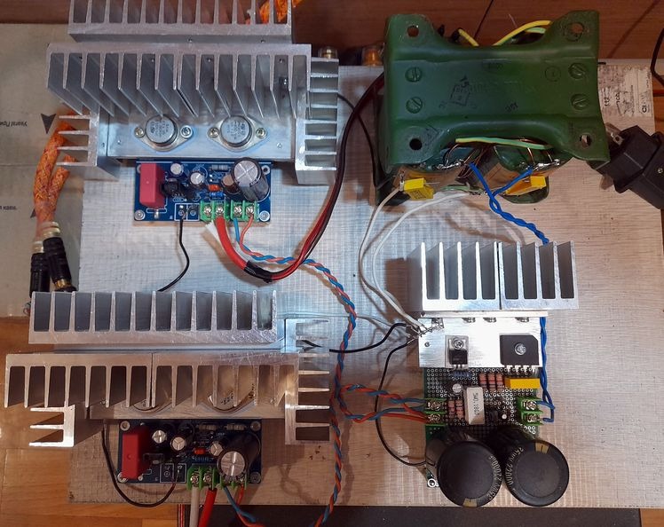

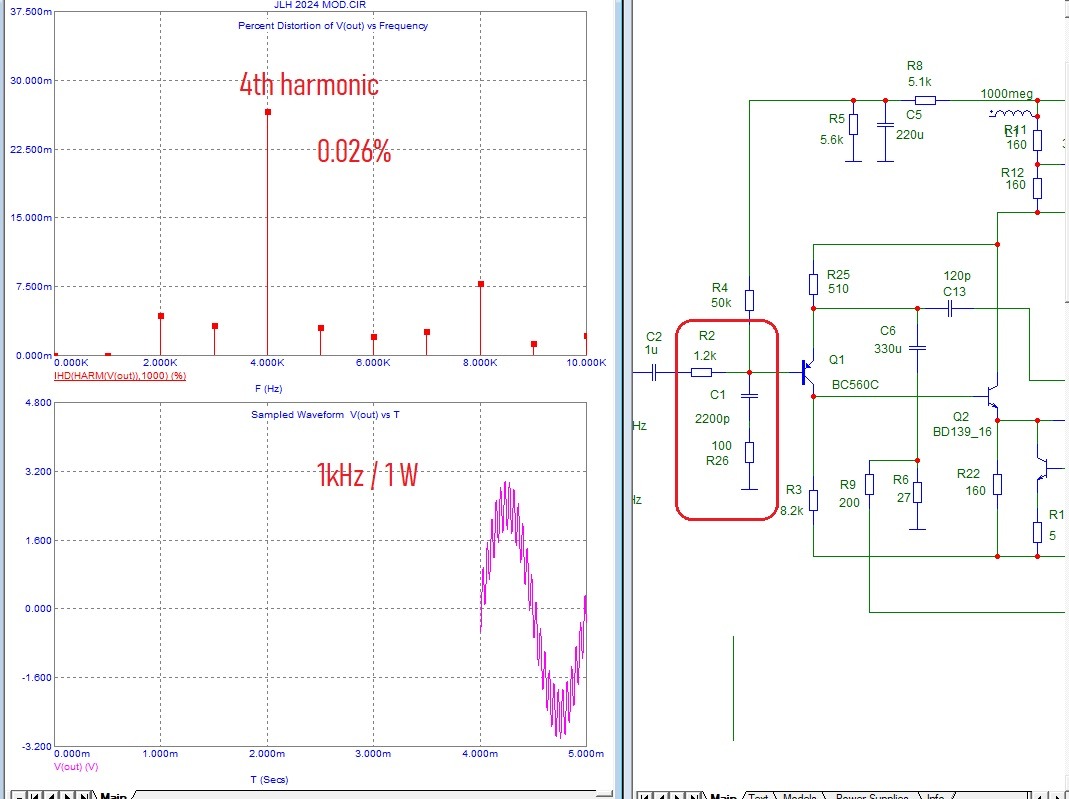

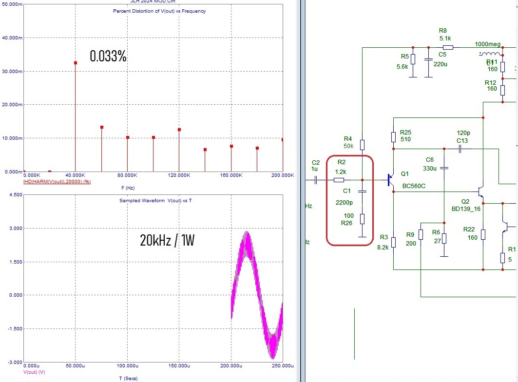

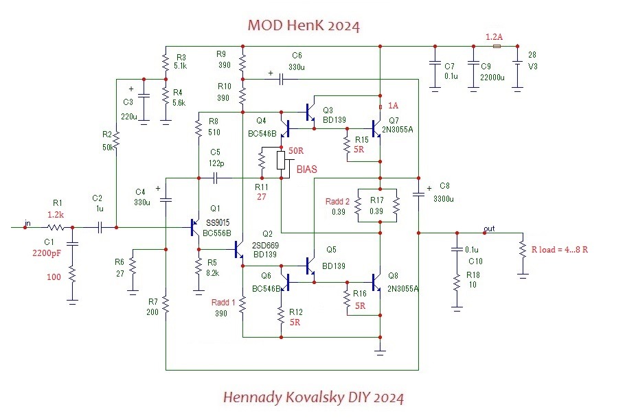

So I assembled 2 channels and connected them now and am listening.
The input filter has been adjusted to ensure minimal IMD distortion.
To adjust the BIAS, I added trimmers in parallel with resistor R11 (27 ohms)
The left and right channel amplifier blocks are connected through one power supply, taking into account the electronic filter/stabilizer, which I consider necessary.

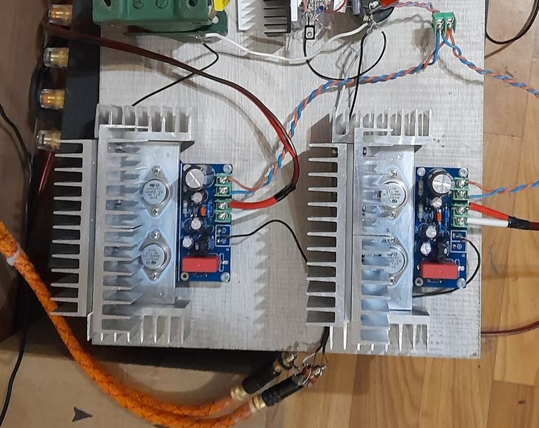

Attached is a photo of a working layout and the actual circuit of the amplifier. The circuit of the electronic filter is higher in the post.

From the initial topology, probably only the resistor R5 = 8.2 kOhm remains; it determines the linearity of the gain of the input transistor.Hennady it could be fun if you highlight the original part of the circuit in another color along with original part. -When its final off course.
Now I’m listening to the assembled amplifier - I’m very pleased with the sound, good soundstage, wide stereo base, reverberation (echo) on compositions is more audible, light powerful sound - volume slider at 20%, dense clear Punch Bass, soft highs. It will become clearer after comparative listening tests.
Thanks for the tip on adjusting the compensation for IMD distortions.Cheers!

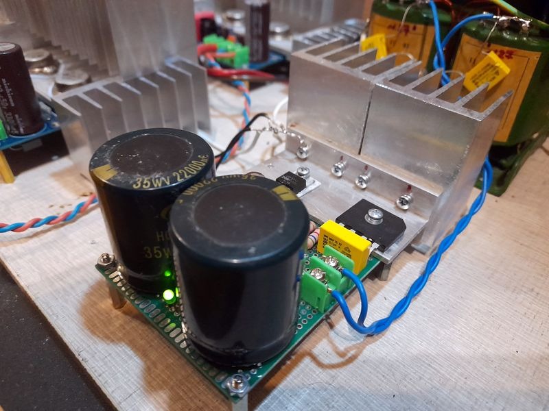

But I was able to finish the electronic supply voltage filter and now the design looks like this:
![20240324_185352.jpg 20240324_185352.jpg](https://www.diyaudio.com/community/data/attachments/1198/1198098-5383141c4186cb790c14519a0b78f1e9.jpg)
![20240324_185402.jpg 20240324_185402.jpg](https://www.diyaudio.com/community/data/attachments/1198/1198099-385294a4ce58ef6de78e45d6de8e9c7b.jpg)

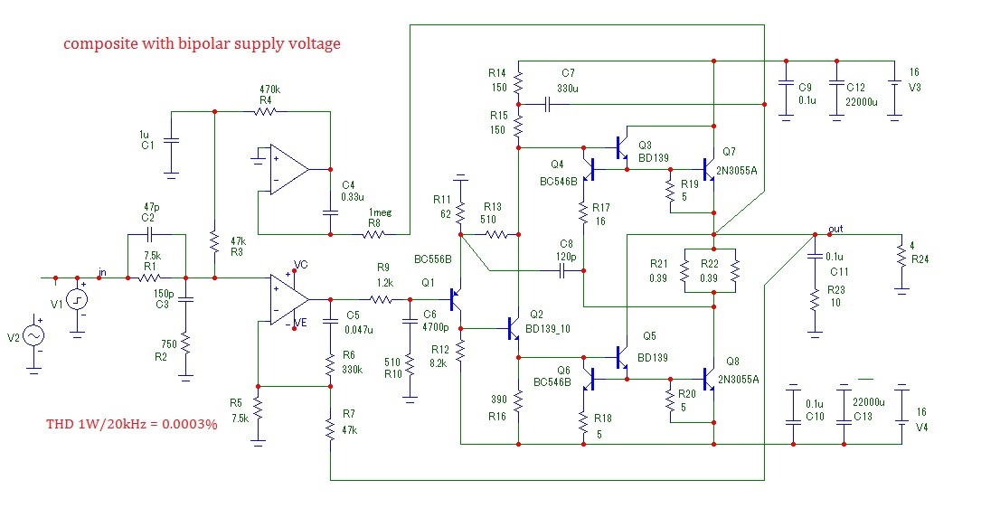

Did I understand correctly that we are talking about a composite?I'm hoping you will get back to your op-amp version you mentioned a few posts back. Very interesting concept.
I modeled this option, the main thing is linearity in the audio frequency band and the absence of electrolytic capacitors, except for the tracking load in the driver - it should not be removed or replaced with a stable current generator, because The maximum output power is reduced.
a milked operational amplifier TL072 was used, its gain of 30 dB was made as linear as possible due to the R8C5 circuit.
![COMPOZIT.jpg COMPOZIT.jpg](https://www.diyaudio.com/community/data/attachments/1198/1198103-e800585b5458d9b4e2fc969156298c62.jpg)
Few questions regarding the composite amp:
1) Servo is actually needed? I guess it is, with this single device input instead of LTP...
2) If we replace 2N3055 with some more decent devices, will this improve the amp?
3) Can we increase rails to say 25V, and power op-amps via 15V Zeners?
Initially, the purpose of the serv was to exclude the capacitor in the circuit of resistor R5, because in this circuit such the capacitor increases the level of distortion at mid frequencies. Such distortions can be combated by endlessly only increasing the capacitance of this capacitor. Also in the circuit there is a circuit of local NFB R6C5, thanks to it the negative influence of the servo is not noticeable, neither in phase nor in frequency.1) Servo is actually needed? I guess it is, ...
Balance compensation R13C8 has finally been introduced into the JLH circuit; with it, the frequency properties of the output transistors no longer affect the parameters of the circuit))), so use any modern transistors.2) If we replace 2N3055 with some more decent devices, will this improve the amp?
The issue with powering the operational amplifier from the zener is ok, no problem there. But the supply voltage of +/- 25 volts for the output stage is more serious. Those. At this supply voltage, at least 3 pairs of output power transistors are required.3) Can we increase rails to say 25V, and power op-amps via 15V Zeners?
Precision assemblies Q3Q4Q7 and Q5Q6Q8 assume theoretically infinite parallelization of Q7 and Q8, respectively. Therefore, you can parallelize without problems (patent).

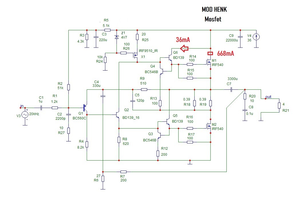

In a modified version of the circuit, Mosfets can be used as power transistors.
What additions:
*The supply voltage must be increased to 36 volts,
*Additionally use a stable current generator in the driver load, i.e. Mosfets are voltage controlled; they have no internal local feedback - it is necessary to eliminate the dependence of the initial current on the supply voltage.
* Move the feedback resistor to the output of the amplifier to control symmetry, for the same reason as in the previous paragraph
![MOSFET MOD HENK 2024.jpg MOSFET MOD HENK 2024.jpg](https://www.diyaudio.com/community/data/attachments/1198/1198351-9ea8352c88b288cd3fc79eeeedc4145c.jpg)
What additions:
- The initial current of power transistors may be less, because it is the power dissipation that is important and not the value of the initial current, here it is 668 mA.
- I also lowered the HF cutoff frequency at the amplifier input to reduce IMD distortion.
