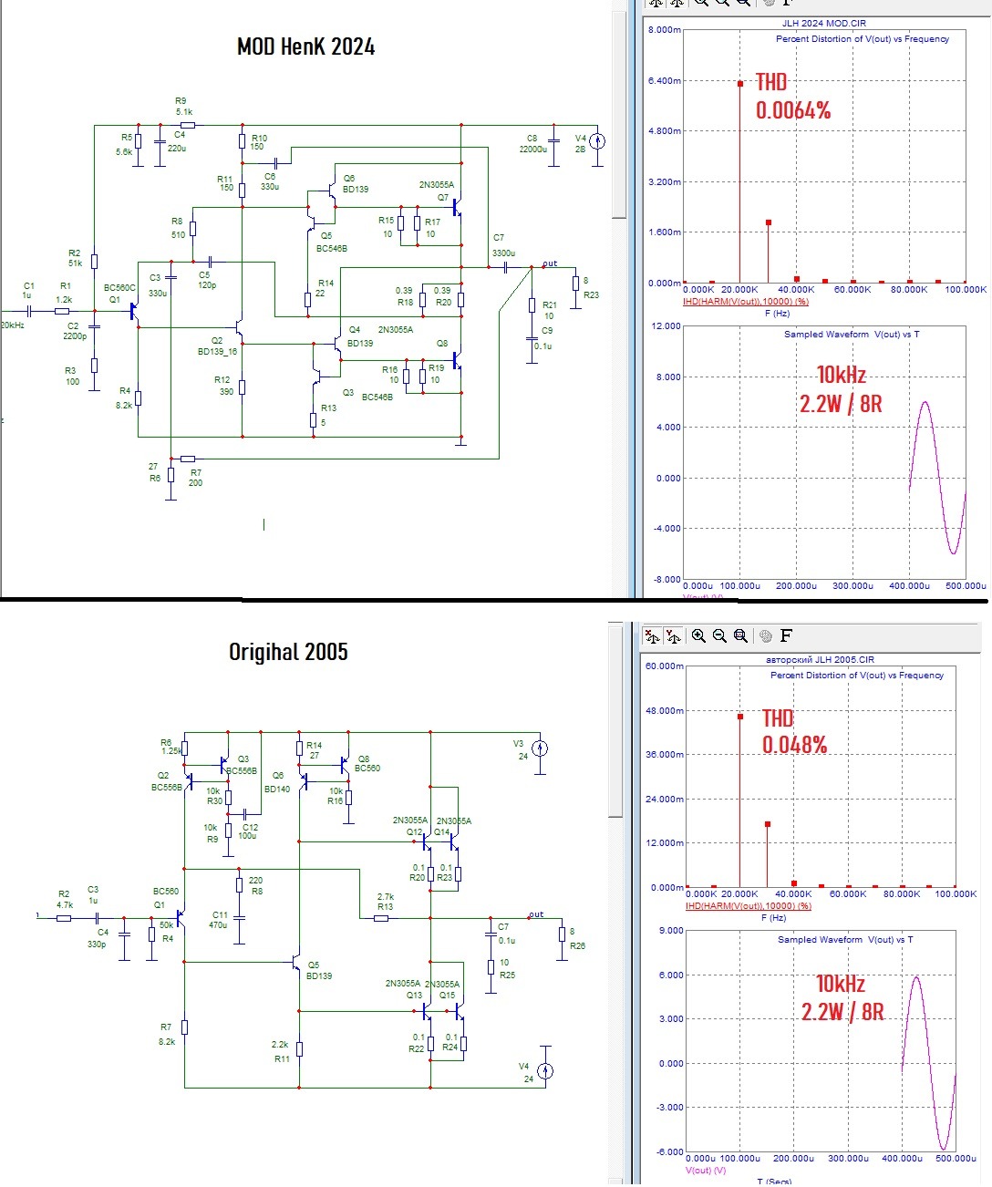

the reason for the question was that the modified version of the amplifier sounds different from the original version from 2005, which I assembled earlier, and I still remember how it sounded.
Here is a comparison in the attachment, and this is an option with an output capacitor versus a bipolar one and almost twice the supply voltage:
And here it is naturally not a matter of “sticking” keys on the keyboard))).
And the fact that the modified version with an output capacitor and unipolar power supply in the model already “outperforms” the original 2005 version in terms of distortion level is a real reason to think about the prospects of the modified version for improving sound quality.

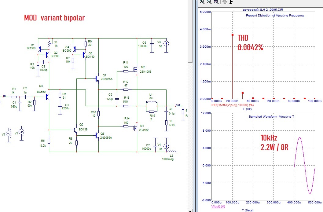

as well as the option with a mosfet output with a "current dumping bridge":
![MOD HenK 2024 bipolar.jpg MOD HenK 2024 bipolar.jpg](https://www.diyaudio.com/community/data/attachments/1198/1198787-212f94c8926a19e3a89ba3ebee838a46.jpg)
![MOD HenK 2024 и Original 2003.jpg MOD HenK 2024 и Original 2003.jpg](https://www.diyaudio.com/community/data/attachments/1198/1198783-b4ff0da412cecb64b6e434099de90c30.jpg)

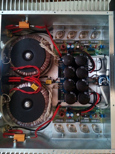

Option 1 is now assembled:
How it turns on and off is absolutely inaudible.
the sound appears as if from nowhere, because... I can tell that the amplifier is turned on only by the LED, which is actually why I installed it.
Subjective sound -
*voice is highlighted and in the foreground, all the small nuances can be heard,
*in one of the compositions I heard a xylophone in the “background”, and only in the right channel, which only played along; I did not pay attention to this on other amplifiers.
* reverb processing is very audible, if you don’t pay attention it doesn’t distract at all, I just noted the greater intelligibility of this effect compared to other amplifiers. ,
*very “subtle high frequencies, which are rather synthesized artificially, because I myself have a musical education and played in a group, so I know how the instruments sound and how the sound engineer sets them up.
listening power rarely exceeds 4 watts
Acoustics 2-way, reference, sensitivity 91dB, impedance 8 ohms, low-frequency speaker with phase-equalizing "bullet", tweeter - silk, wires 2x2.5mm.sq. Supra Classic.
See photos of the assembly of the blocks of this amplifier and its modifications earlier in the topic.
Subjective sound -

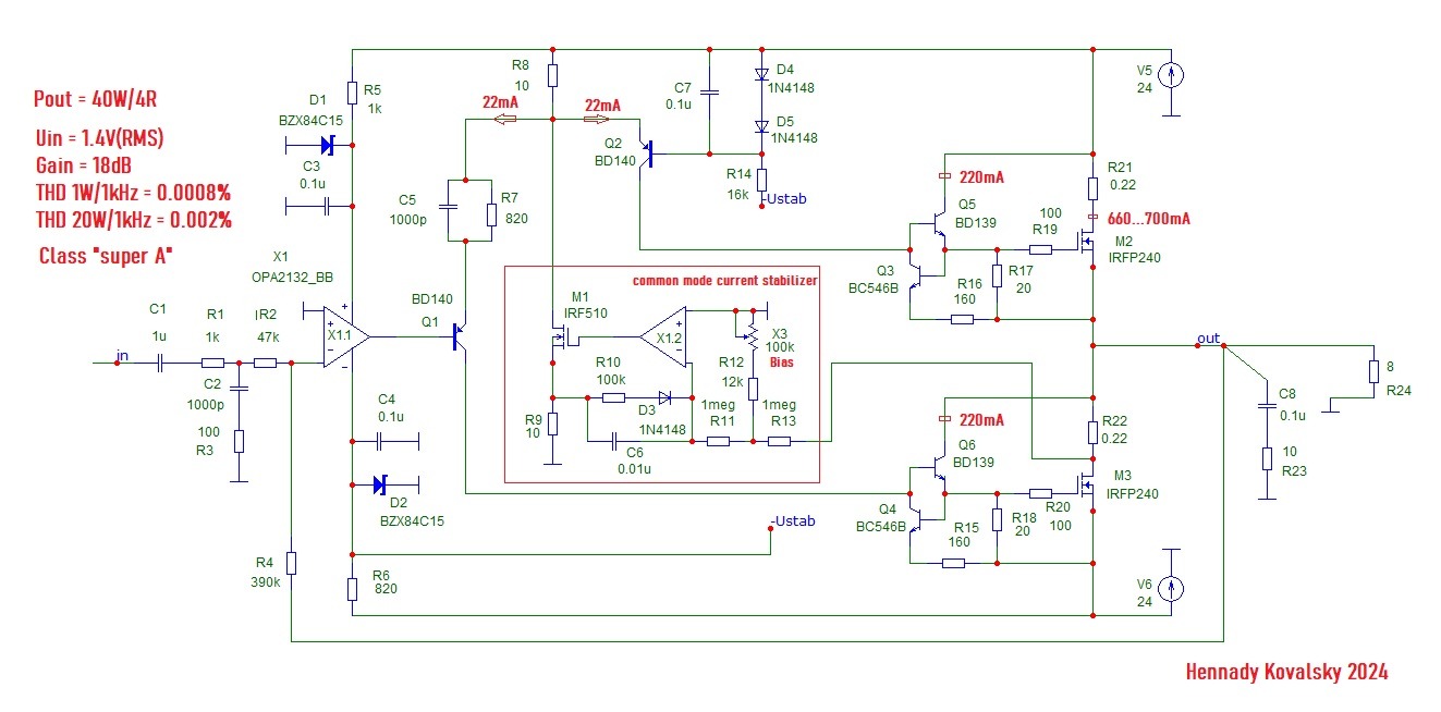

I will present a slightly different type of circuit that implements the most symmetrical control of power transistors of the same conductivity.
Adding a common-mode current stabilizer allows you to reduce the current of the output power transistors by 30%.
The common-mode stabilizer is implemented on the second operational amplifier of the OPA2132 assembly; the task of the common-mode current stabilizer is to monitor the symmetry of the initial current of the output stage for high-level signals. In pure A class, for this it is necessary to increase the initial current with a margin. There is no need to do this with in-phase stabilization.
No matter how strange it may be, in terms of its parameters and operating algorithm, the circuit is similar to the JLH topology with the difference that the main amplification is carried out by the operational amplifier, and the common-mode stabilizer eliminates parasitic current modulation at high signal levels. In principle, this can be seen from the distortion; an increase in power does not lead to a significant increase in distortion.
According to the scheme itself:
- operational amplifier high-speed dual
- X3 - current adjustment within 660-700mA
- resistor R14 is connected to the stabilized negative supply of the operational amplifier. ( R6 denomination reduced into account the load through R14).
- output power transistors Mosfets IRFP240
Of all three, I only know Mikhael Wiederhold))This schematic looks like a cross between Lomakin/Parshin/Wiederhold topology (input)
The input of the output stage is probably similar to Nikitin's version from an English company, but our implementation is different.
I came up with the common mode stabilizer circuit myself while I was having lunch)))

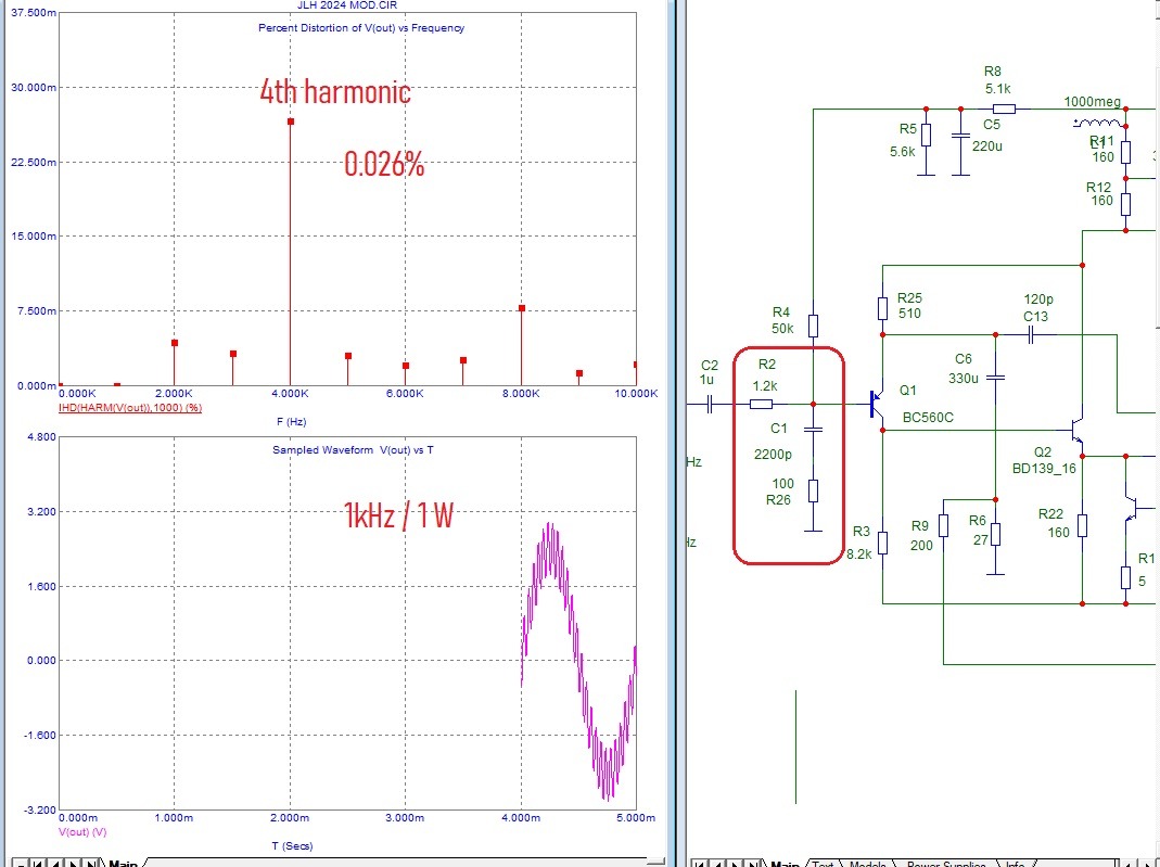

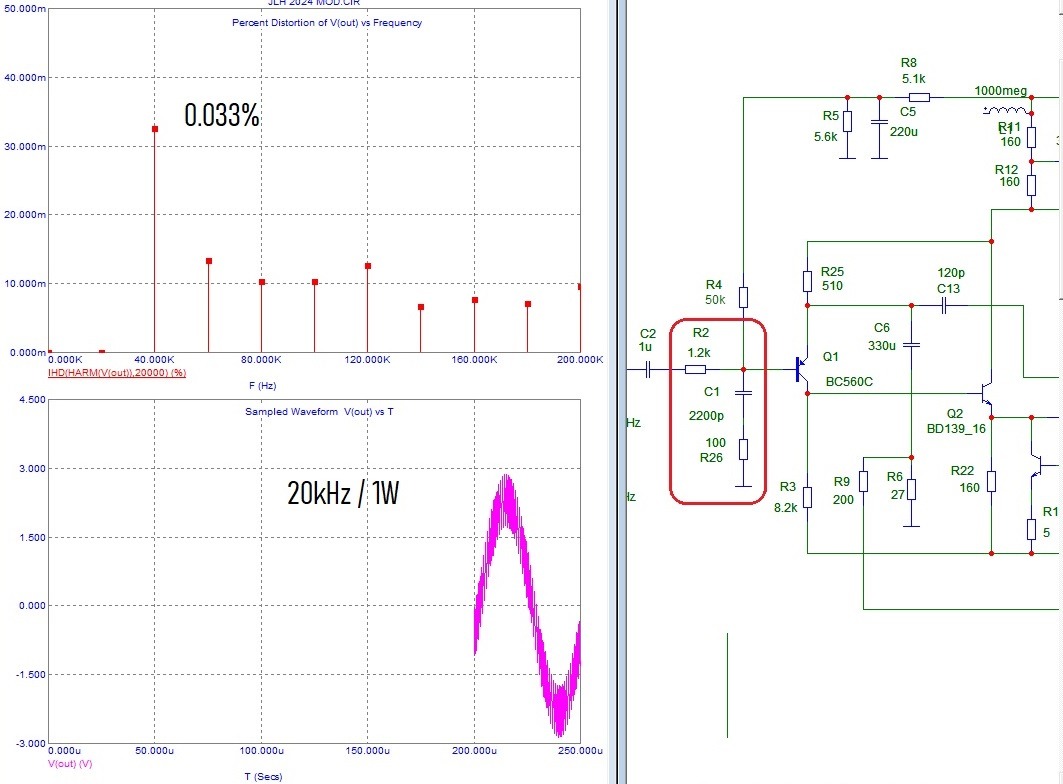

Sorry to go back to this post, but could you explain what happened here? Input filter affecting IMD?see attachment.
and yet it was necessary to change the input filter, while Fo remained unchanged.
This is for the unipolar option.
View attachment 1288819 View attachment 1288820
The reason is the use of old-school 3055 power transistors, their slowness must be taken into account, namely, to reduce the frequency spectrum at the amplifier input. It is also necessary to take into account that the input transistor operates in an ultralinear mode and broadband negative feedback is introduced through a low-resistance divider. Those. theoretically it follows that it is necessary to install more modern power transistors, but this needs to be checked in the model - I did not do this, because the goal was to modify the finished kit. The input filter frequency has now been reduced from 248 kHz to 73.5 kHz.Sorry to go back to this post, but could you explain what happened here? Input filter affecting IMD?
During the simulation, it was clear that as the cutoff frequency at the amplifier input decreased, the IMD distortion decreased and reached a frequency at which further reduction in frequency does not affect the reduction of IMD distortion.
In the original JLH version, the input capacitance of the power transistors shunts the collector of the driver transistor in frequency, and replacing it with modern transistors will further increase IMD distortion, although many will argue that high frequencies have been added and this is good, but at the same time the integrity of the sound stage "sound reproduction picture will be disintegrate, and this is not very good.
In general, I consider it optimal for an audio amplifier to select the cutoff frequency of the input filter in the range of 64 kHz - 88 kHz.
A higher cutoff frequency is necessary where the slew rate of the signal is important to reduce switching output Stage interference, for example, for an output stage operating in class AB, but this always leads to a subjective “hardness” in the sound of high frequencies, sometimes such hardness is called “transistor” sound.

What I managed to find out:
This “surround sound” is obtained due to the presence of tracking feedback in the load of the driver stage. Its use increases the output impedance of the amplifier at mid frequencies; and for its high-quality operation, a supply voltage with minimal ripple and as close in shape as possible to a sinusoid is required; this immediately eliminates the use of a circuit from an unstabilized power source using a simple circuit: diode bridge + high-capacity capacitor.
A CRC filter circuit after the bridge is preferable, but is not sufficient to reduce the ripple level.
It is advisable not to use CRCRC or RCRCRC filtering schemes due to significant phase shifts, and the selection of coefficients for its equalization is difficult, because will depend on the magnitude of the load.
- Hennady's take on the 1969 JLH
