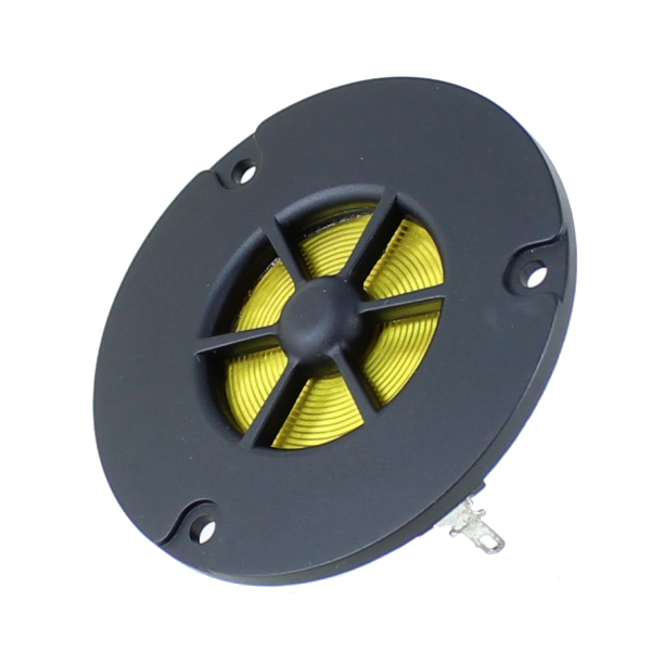

I'm trying to measure the exit angle of the HF1440. The angle is definitely negative: the exit throat is narrowing towards the exit. Unfortunately, my caliper's extension wasn't long enough to measure the exit cone inside it. Assuming a constant wall thickness of the exit cone, I measured it from the outside. The exit angle of the HF1440 is -0.86° measured over last 10mm.

HF1440 looks smoother at high end than HF146, the drop can easily handled by EQReally nice driver, indeed!
But you have to keep in mind that the driver efficiency above 10KHz is only 100dB; while the HF146 is much better above 10KHz:
HF1440:
HF146:
Please note that the scales are way off:HF1440 looks smoother at high end than HF146, the drop can easily handled by EQ
This is a much fairer comparison.
