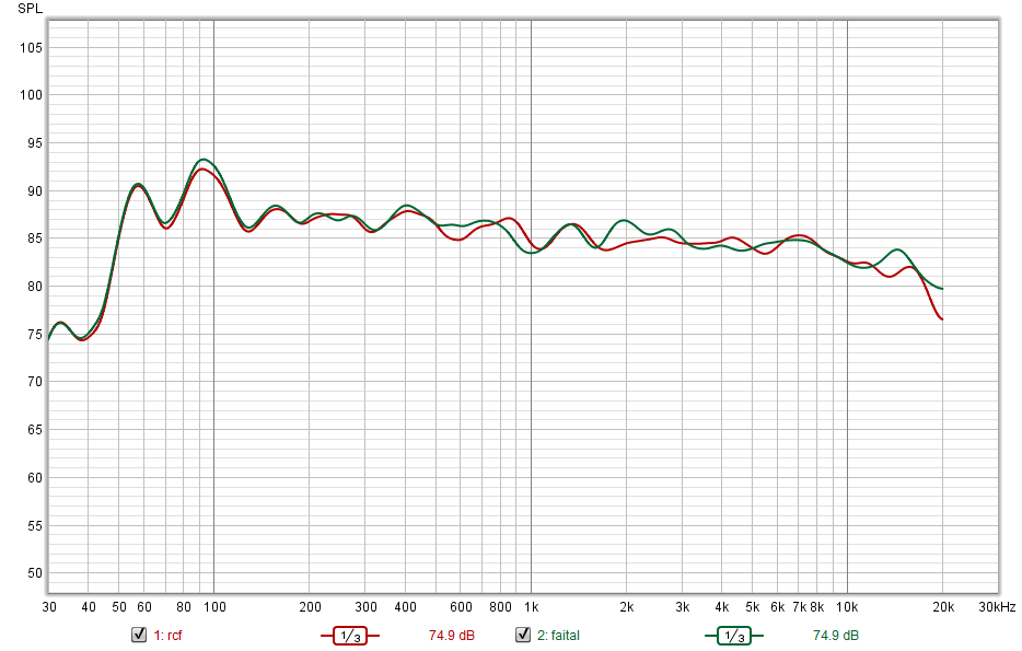

Did you eq both of them as similar as possible?
It was quieter at home (no kids), so I re-equalized the speakers for a more valid comparison. I better matched frequency response of driver combinations. RCF was much easier to equalize. Just 4 peak filters with Q of 1. Faital required 6 and of higher order.

Also, I listened to RCF drivers in this configuration to refresh my memories of their sound.
RCF have more weight in their sound. Images of musicians are more physical. Faital sounds softer and more weightless in comparison.
Both colour the sound. Faital colour less.
Guitar strumming sounds more spontaneous with RCF drivers. There is more "oh sh*" impression when a guitarist suddenly strums all the strings.
After re-equalizing both drivers to the same frequency response, metallic strings sound like metallic strings with Faital. Probably, I made a mistake equalizing the Faitals last night.

wow, quite a good spl curve 🙂
So resitor on the light side (I don't like the word bright that means nothing) and good as //...
It really means something for you is laking with the Faital with this horn combo. I surmise here a Mundorf Supreme will not bring you enough the clearness and subjective tonal balance it brings to be enough... At the opposit I will in your shoes really listen to the not Faital horn with two cements // to have an idea if it can tame little things... Not an expensive test to perform.

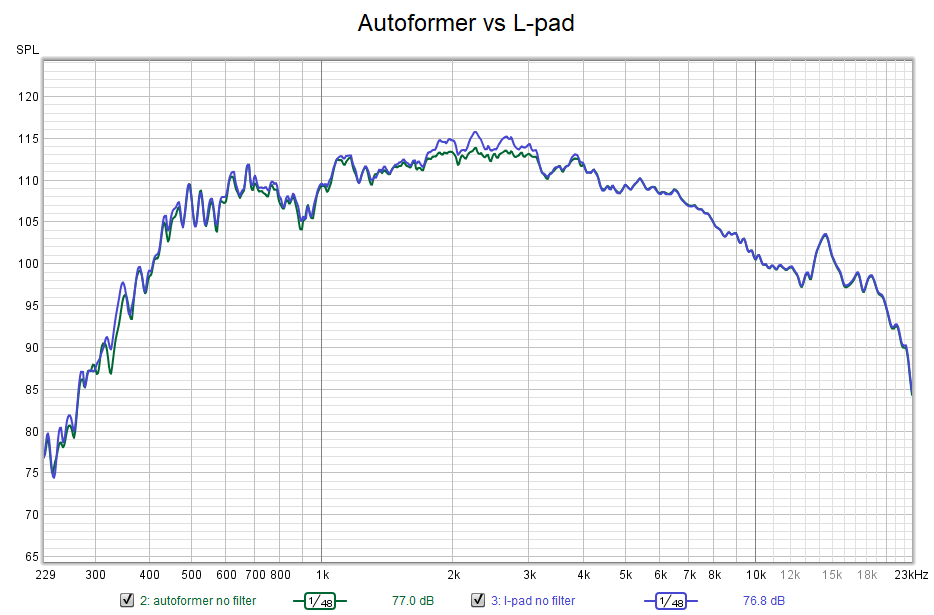

Did you try it without the resistor - or alternatevily with an L-PAD before the drivers? A single resistor in series slightly changes Q values, this might have an effect in your case..
No, haven't tried yet. Resistor is soldered inside the cabinet. I didn't want to disassemble it.
There is an auto-former between resistor and driver. So, from the driver side the source resistance is ~0. Afaik, this configuration shouldn't affect the frequency response.
I re-assembled the system with an L-PAD instead of autoformer. The frequency response is basically the same as before.

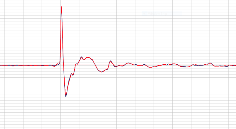

Step responses are almost identical as well.
attachment.php
Yet, L-PAD and autoformer sound differently. L-PAD is stiffer, while autoformer sounds softer. Was it expected?

A resistor is a (much) more linear device so a more truthful signal transfer could be envisioned. But the sender and the receiver characteristics also com into play so one could see a situation where a transformer might create a more advantageous impedance situation for e.g. the sender. Many aspects come into play. If you don't need DC blocking or impedance adaption, a constant impedance resistor attenuation NW would be the most ideal electrical solution.
