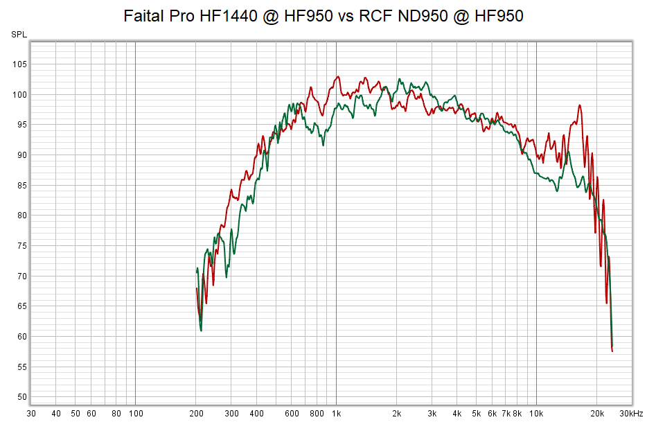

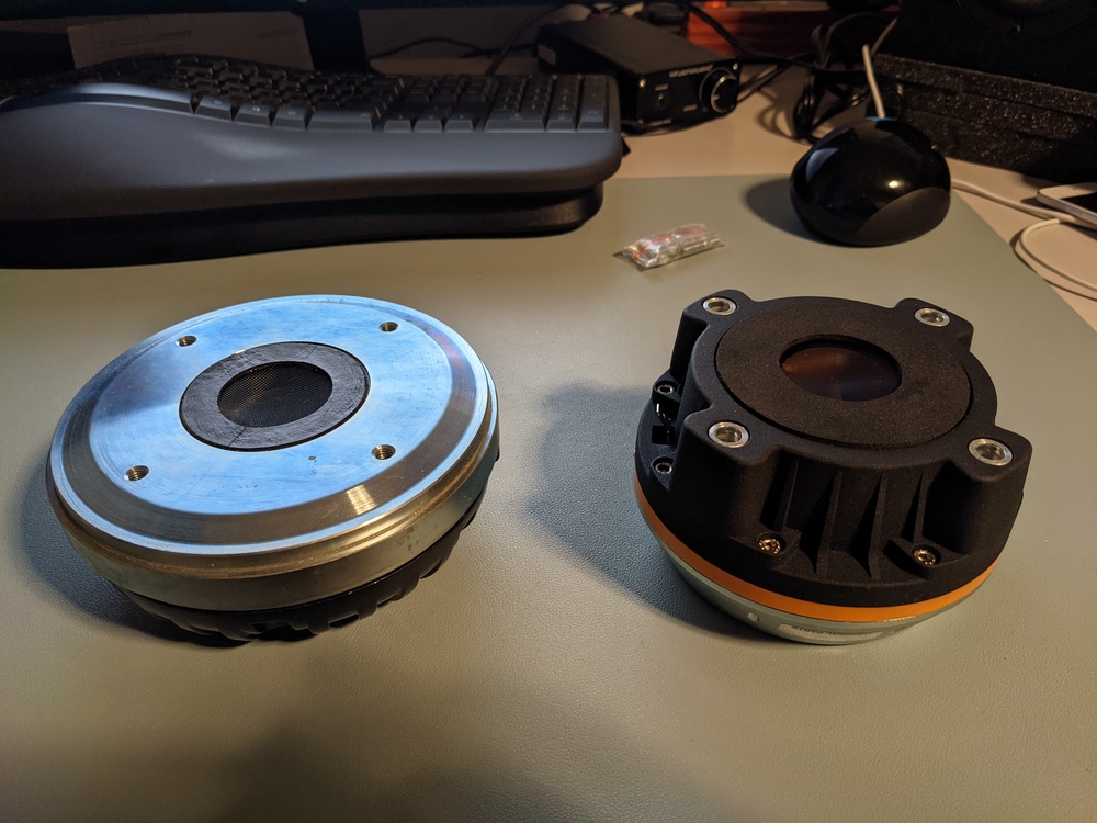

Re-configured the system. These driveres definitely play differently. RCF plays harder, Faital is more weightless. I will not undertake to assert which one is more correct.
On Dave Weckl - Higher Ground, the individual drum beats are better separated with the Faital. With RCF, due to their heaviness, they tend to be less separated. Like if the drummer hits harder and correspondingly slower.
Sophie Zelmani - All About You. With Faital guitar strings sound like a nylon. There sound more metallic with RCF and even my phone's speakers.
Sting - Shape of my heart - I can better hear the recording space with Faital.
George Clinton - Maggot brain - Faital has less drive. There seems to be a little more depth. With RCF you are on stage, with Faital you are more like in the fan zone. The drums are more legible with Faital.
In general, the feel of space become better with Faital, but I am missing something with them. Probably, I need to raise some frequency range?

Which driver is which on the graph?Put both on RCF HF950 horn.
Yes, pretty close. FusionAmp allows up to 15 biquads so it wasn't very difficult. Equalized them to the same room curve.Did you eq both of them as similar as possible?
RCF is redWhich driver is which on the graph?
No doubt)Pretty sure that the guitar on All About You is steel stringed.
