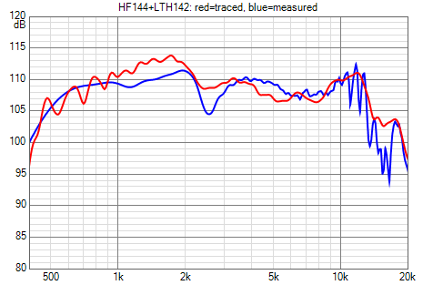

Quite worthless to trace HF driver+horn curves from datasheet no matter is frequency axis decade(s) wrong while exporting FRD/ZMA or not
For example HF144 with LTH142, traced vs. measured.

Quite worthless to trace HF driver+horn curves from datasheet no matter is frequency axis decade(s) wrong while exporting FRD/ZMA or notFor example HF144 with LTH142, traced vs. measured.

Both measurements seem (inversely) averaged / smoothed. The traced curve shows ripples at the low end and 'smooth' top octave, while it's the other way around in the measured response.
Taking this into account, they are quite similar.

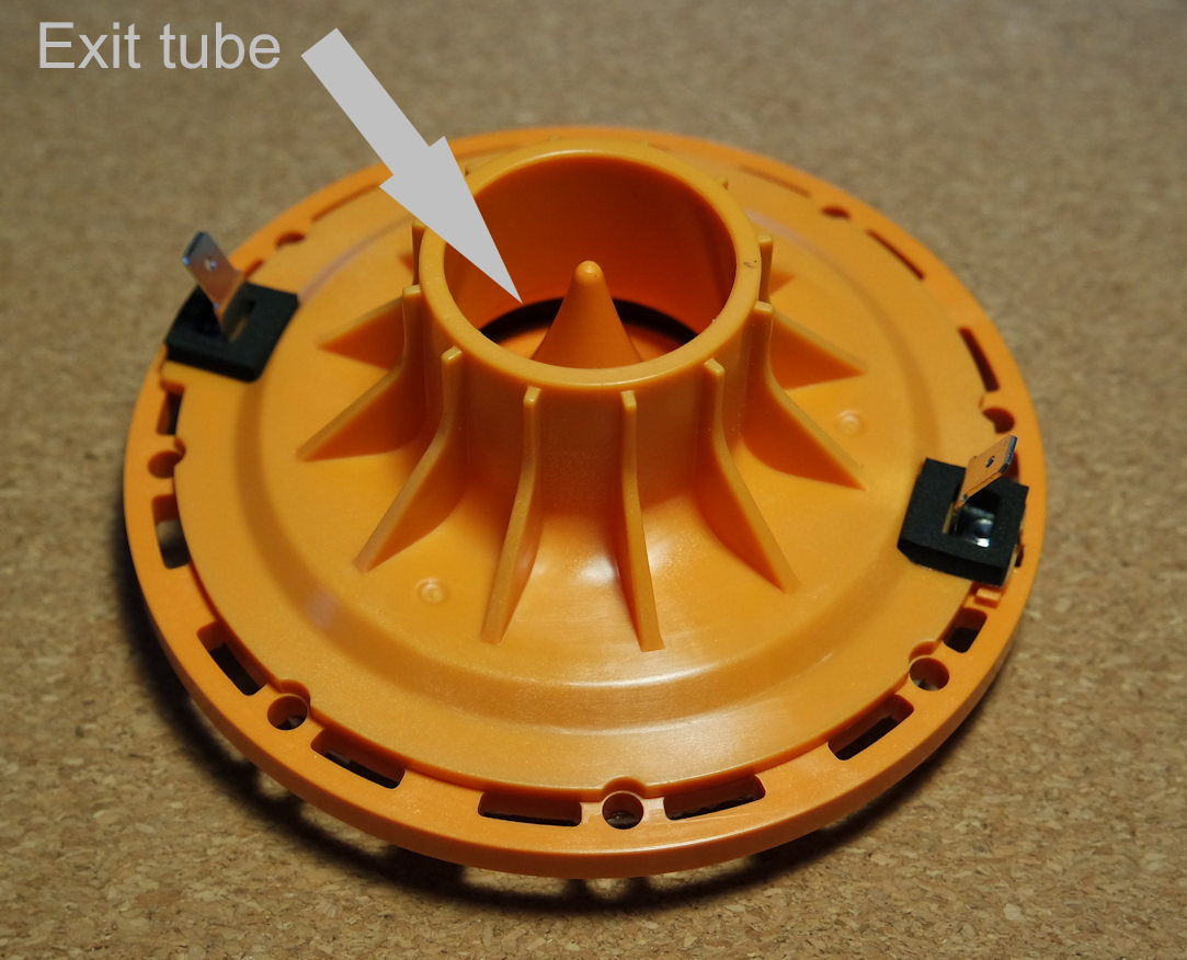

Does anyone have an opinion regarding the best 1,4" to 2" adapter for the HF1440 driver to be bolted to Yuichi A-290 horn?
For example, I calculated that in 18Sound adapter the flare rate is 11,5deg conical (37mm thick, 1,4" --> 2").
Now the Yuichi A-290 horn is "optimized" for TD-4001's internal flare rate. What I was able to find was that in TD-4001 the internal flare rate of the driver is closer to 5,5-6deg conical (64,5mm long path and from 1,5" to 2").
Should I be looking for a longer adapter because the Yuichi is optimized for Tad? Or would some faster flare rate be better for the Faital's radial phase plug design? What I understand that in Faital there is no "internal flare rate" and the driver is (acoustically) more like a pancake driver. Or is it... Who the hell knows this stuff
18sound adapter looks solid and has nice felt pads etc. quality stuff and looks tempting otherwise. Also there is not that much of an alternatives in the market and many do not state the exact lenght of the adapter. Should I tell my carpenter to make a ~55-60mm long wooden adapter![]()

Usually pancake drivers don't go well with classic horn types that have slow initial expansion, but this largely depends on the design of the phase plug.
The 'radial design' of the HF1440's exit section does indeed include a conical tube, despite Faital stating "Combined Exit".
Like BMS, B&C, Celestion, JBL etc., FaitalPro more or less adopted Blattner's ancient (WE) patent of a compression driver with an annular diaphragm.
Yes folks, nothing is really new.
I believe Faital might state it correctly because the phase plug ends at the mouth of the driver, ie. no flare after the phase plug? But the phase plug is different than "3-5 slit" type. Conventional slit phase plugs also have a flare rate/expansion but I have never seen them taken into account in horn matching, why should we take it into account with Faital... So does this different phase plug design matter from flare rate dilemma POW, I dunno.
If I believe Faital I should go with 77mm long throat adapter which would have the same flare rate than TD-4001's inner flare rate.

As for the exit wavefront, it can be deceiving. I fully realized that with CDX1-1425, which has a tapered exit (a narrowing one), yet it is properly matched by a horn with diverging angle of 20 deg or so at the throat (i.e. the wavefront at the exit is designed to be spherical and diverging) - it's really the phase plug that makes all the difference. I believe with HF1440 there would be a flat wavefront at the very exit of the driver, but who knows.
BTW, I still don't understand what this "pancake drivers don't go well with classic horn types" means.
"BTW, I still don't understand what this "pancake drivers don't go well with classic horn types" means."
Old style driver with buil-in flare is loaded better at low freqs and the transition to "old style" horns that have slow flare at start (expo, hyperbolic etc) is better matched ie. no sudden changes?
What you say is that there shouldn't be a mismatch of wavefronts (or the flare) at the driver-horn interface. I agree but then I still don't understand what's wrong with using a "pancake driver" with about any horn. But maybe I just don't understand what a "pancake driver" is. Is there a definition?
In my understanding a pancake driver is a driver without any inner "matching conical flare" after the phase plug.
Pancake is more versatile as it can be matched using different lenght mouth adaptors to any given flare rate (i think), provided that the throat of the horn is bigger than drivers exit.
Might be something to do if the horn has been matched to specific driver, ie. the designer has taken into account that the driver has "part of the horn" inside it. Without it the low freq loading isn't the same.
