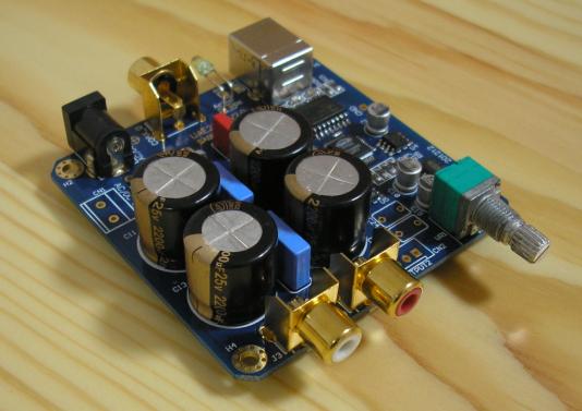

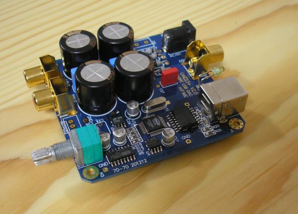

Thank you guys, here is the toy.
We call it UAE23+, which is usb isolated and need a external power supply. It will be bigger than UAE23. I think UAE23 is very convenient to use but UAE23+ will be little more high-end.
We still use ultra low noise regulater to make es9023 work the best.

Hi, ES9023 will output more than 2Vrms when 3.6V supply, and only 1.9Vrms @3.3V. we suggest 3.6V for better voltage swing....

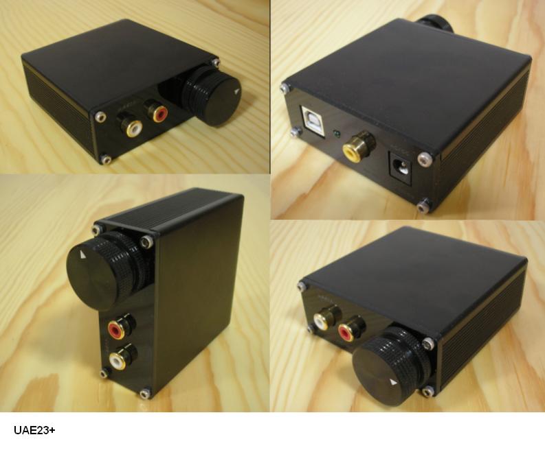

We call it UAE23+, which is usb isolated and need a external power supply. It will be bigger than UAE23. I think UAE23 is very convenient to use but UAE23+ will be little more high-end.![]()

Yubing, I see UAE23+ got volume knob, how it is implemented? does it have output buffer opamp, which one if yes? Thanks.
Yes but the output is still direct from es9023. Just leave the potmeter at maximum if not use it.

Hi Yuri. Yes we use a output attenuator but it's not low resistance. so I think it's better to use a short RCA cable if the potmeter is using, because the signal after it will be weak.Excellent, guess I need one as a gift for myself... for the Chinese New Year probablyAny hint of price and time will be appreciated.
