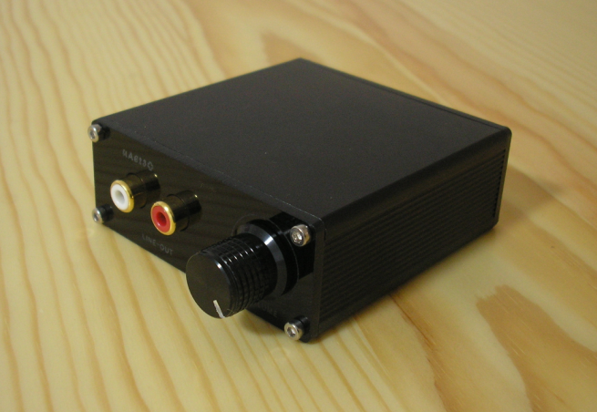

I modified a UAE23 over the holidays with
- separate regulation for the ES9023 + caps
[I used a 5-lead TPS series 3.3v since I do not use headphones, that regulator has a pin for a bypass cap, so that got it's own cap too, on pin 5]. I only wish I had some tiny coils around for the 5v V+ into regulator #2
- bigger pre-filter 5V cap, low ESR
- Fox 924b 3.3v TCXO 4-pad SMD clock
FOX924B-12.000 Fox Electronics | 631-1068-1-ND | DigiKey
it would be nice of the PCB artwork in UAE23+ would support an etch-cut and spot for addition of secondary 3.3 or 3.6V regulator, a 3.3V TCXO... 12V in with 7805 or so pre-regulator [leave the diodes so can feed in AC or DC or battery], and spot for USB vs 12V power switch [for coaxial power jack vs USB]
I may rebuild the second UAE23 I bought into a large enclosure and add a 1/2 level switched attenuator, or switches for a few steps. I feed it now with Opticis m2-100-03 3m fiber-optic USB isolator [12Mbps rated] with far-end 5V injection port. I have 30 of those isolators left at less than 1/2 $ you will find anywhere, I prefer to ship to USA [easy]. PM me if you want one.
I have no idea if it sounds better, it's "nice". I'll have my second UAE23 soon so I CAN then compare, before I mod it and give to my Sister. I wrapped the UAE23 in foil HVAC tape [mostly because cover doesn't fit now hah]

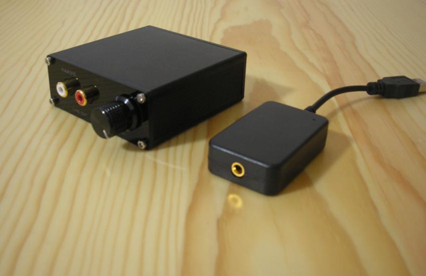

We call it UAE23+, which is usb isolated and need a external power supply. It will be bigger than UAE23. I think UAE23 is very convenient to use but UAE23+ will be little more high-end.![]()
We still use ultra low noise regulater to make es9023 work the best.

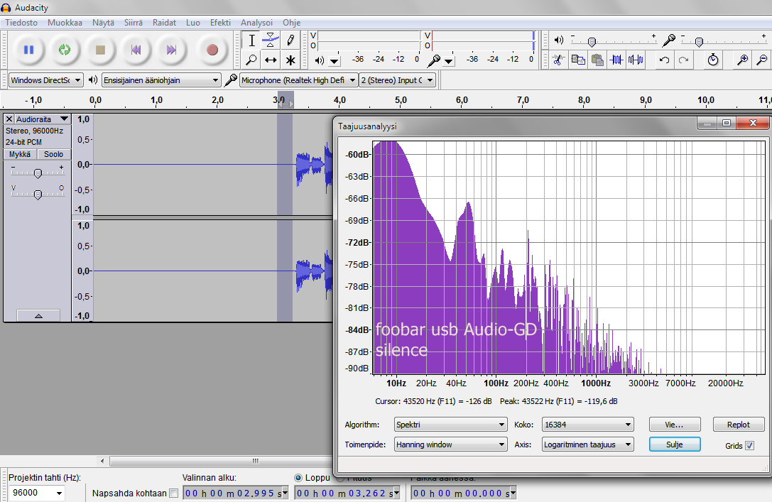

Not related to RF problems but ground hum. It,s very difficult to eliminate AC hum (50/60Hz) even from a USB driven system. This hum is easily -30 to -50dB at nominal Freq and some 20-30dB down at multiples.
I can demonstrate this by sowing some Audacity recordings and graps. Even the laptop driven by it's battery is not free of it. At least you will get it in your power amp. The attached graphs shows mainly the hum from a phono cartridge. The Terratec ADC itself gives some -50dB AC-hum
The recordings always have low fq noise and AC noise. Here is a flac 24/96 from HDtracks, you can see the 60/120/180Hz AC-hum and low fq noise propably from microphone amps. Usually this is highpass filtered off (subsonic filter @25Hz)
If you have a laptop, please download the free Audacity and make your own (uncalibrated) measurements. The spectrum of noise is more interesting than the dB of certain specified mV/fq to us non-engineers.
When I connected my Audio-GD DAC via usb and recorded RCA-output to the same PC, there was practically no hum at all. The ground loop did that. But there was more noise from the soundard of the pc.

The last is PC/usb to dac/Tenor 7022, dac/RCA-out to the same PC/line in (back panel, motherboard/Realtek HD) My mic-in is mono, noise is about the same. The sample is a 24/96 flac played with foobar, silent section.
Yes, there is a ground loop. But I get almost the same when I measure the PC-driven dac with a laptop. And much more AC hum from any other configuration or AC-powered appliance. (I haven't tested the output of my Logitech X-Fi player yet.)
DAC is Audio-GD NFB-12 set to 4x and minimum phase filter.

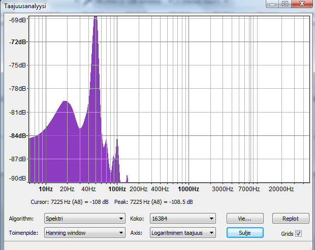

Here is my Terratec ADC box connected by usb to the same AcerPC. No signal (input disconnected) Level set for recording a LP.

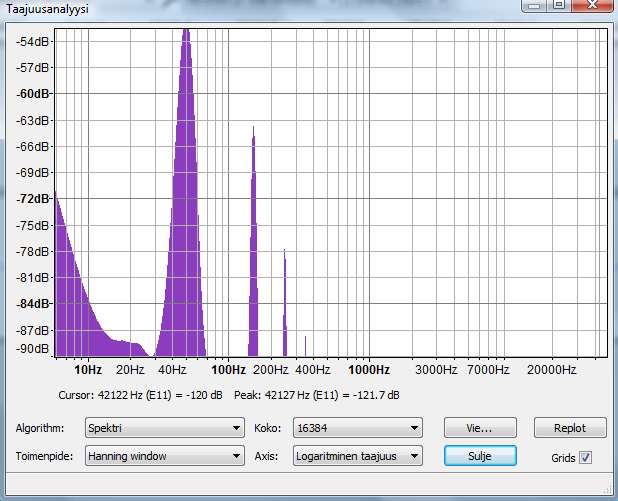

And here tne same TErratec ADC with phono cartridge connected, player not running. The AC hum now -50dB
I just want to demonstrate that AC hum is a real problem. You will get minimal (no?) hum only if you play a battery-driven player and dac and amp (portable player)
