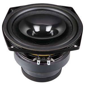

Any thoughts about running the Faitalpro 8Fe200 without Crossover?

Any thoughts on whether you can forsake the low pass Crossover for the faitalpro 8fe200. Thanks

I mean using the natural roll off of the woofer. The natural roll off is already -20 db/octave...Of course.
It is very easily done with DSP.
Sent from my D6653 using Tapatalk
At 2KHz 8fe200 is about 5-6dB down which is about maximum that you can use it if you want to combine it with some waveguide loaded tweeter.
It is -20dB at 5KHz and shows nasty breakup - i'd never use it that high nor would i recommend it to you.
DSP and say Umik-1 is a valid option if you want to have fun and not spending bunch of money on drivers that will not sound good.
I don't know of any driver that can work with no crossover ... except maybe Dynaudio 22W75 - that is about last Dyn that sounds natural to me, but they stopped making woofers with paper cones decades ago.

Not sure which driver you looked at but I think you must have looked at the wrong driver. Frequency response is actually flat to 5kHz. There is a small sucks out off axis at about 3kHz. But that doesn't bother me too much.
Anyway I have a minidsp so I could play with that. But I just want to hear opinion from others who have played with pro woofers....
BTW there is also the SEAS A26. Not really true that most speakers have lousy break up. There are many speakers with well controlled break up.... But generally you find them in the full range forum.... After all that is how they work...
With a smoothed graph, you have to read between the lines a bit.
See this example, where the off axis bump on the factory graph is the best hint of the sharp spike that is revealed on the "real" graph - Troels fixes this bad boy with a crossover that weighs and costs more than the driver 🙂
Fostex FE126E +
For the Faital 8FE200:
a) That combo of notch followed by a peak is usually a bad sign
b) The on and off axis curves are ideally smooth & near to parallel, but here the off-axis response shows a big lump @ 4kHz
Again, compare this with the Faital 12FH500, which looks like it has smoother roll off. I think it would be a better choice with no crossover - and use it a bit off axis, since it has pretty good dispersion to 2kHz and not much above 2kHz.
Or just use your DSP!
Full range drivers are used right through their (sometimes lousy) break up range. Generally the less efficient ones have better controlled break up, and the smaller drivers have break up at a higher frequency, where our hearing is less sensitive.
The 8FE200 is neither of these.
[Frequency response is actually flat to 5kHz. There is a small sucks out off axis at about 3kHz.
Hmm, look at the vertical scale, it's in 10 dB increments, so it's anything but nominally flat [+/- 3 dB] out to 5 kHz except maybe around 20 deg off axis.
Anyway, like most 'FR' drivers it ideally needs to be tweaked and listened to off axis to use it beyond ~Fs*8*pi = ~2010 Hz or whatever it is with its actual Fs.
