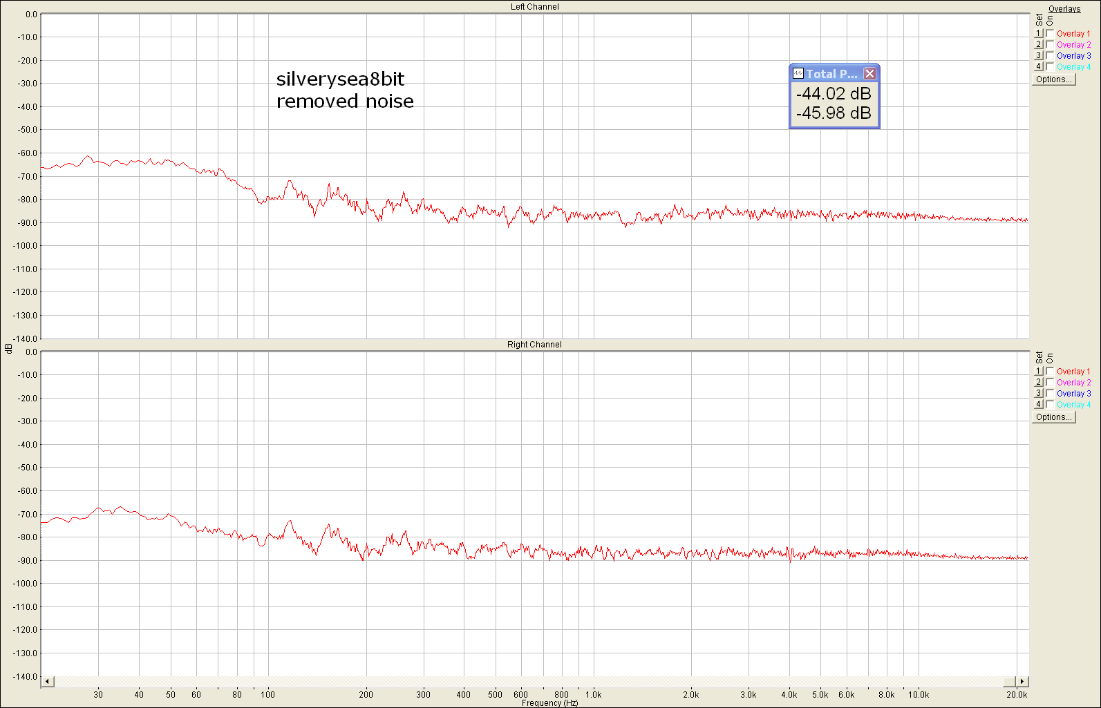

Marcel, BTW, I have played a bit with your 8bit file, would you mind to listen to the result?
http://pmacura.cz/silverysea8bitnr.zip
The original recording might have been quite nice.
Edit: attached is the removed noise spectrum
It sounds OK until the women start singing, then you hear all the artefacts of the noise removing algorithm.

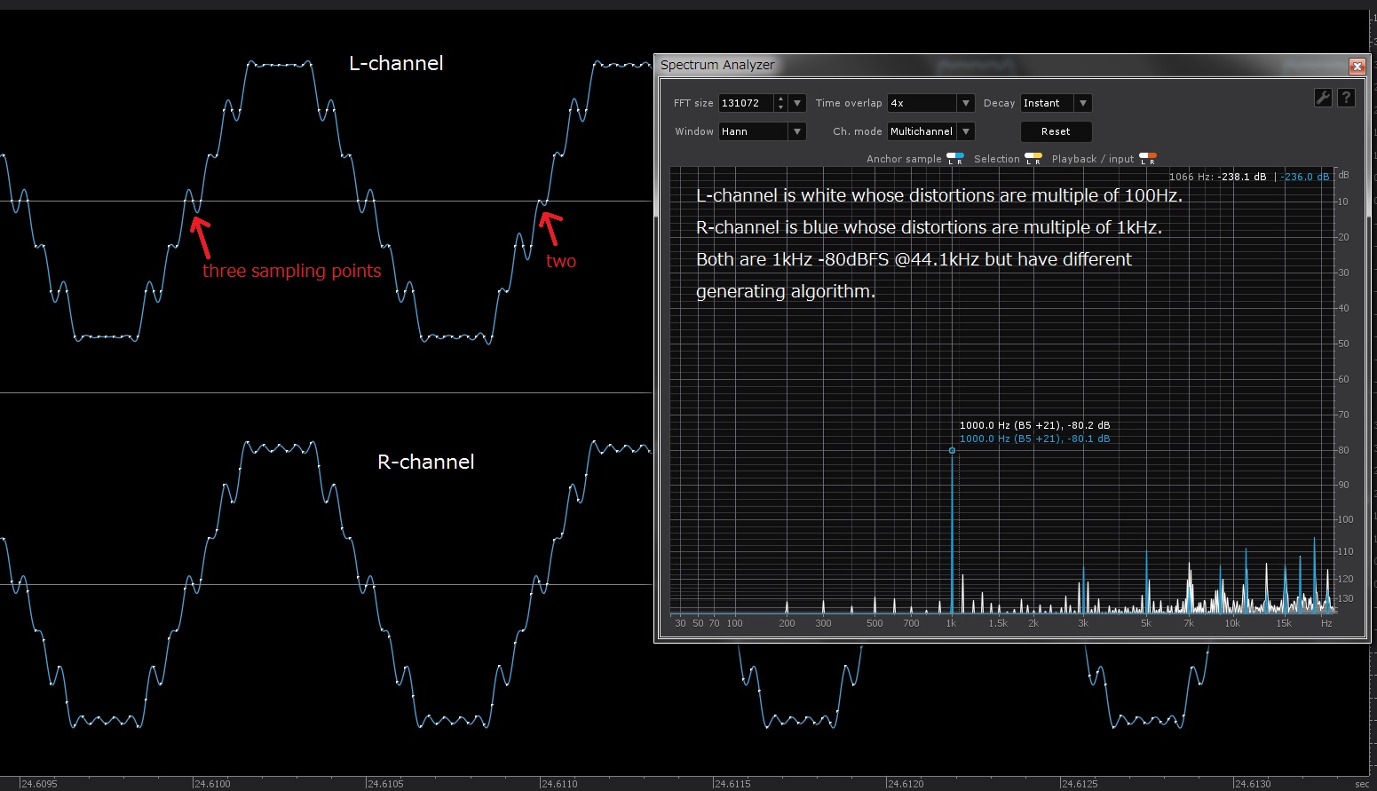

I agree with you that the quantization error is not white noise. But the standard software usually uses to generate sine wave has some odd character(you may say it has a bug). 1kHz sinewave generated by this has the quantization noise of multiples of 100Hz as you wrote. This is because of the greatest common divisor between 1kHz and 44.1kHz. It's also true.
But I found this was an algorism oriented issue. Another algorism can have distortions of multiples of 1kHz like the attached. The standard software probably took the easy way to generate various sinewave. 1kHz sampled by 44.1kHz has 44.1 sampling points in one period. But a fraction can't be used. Then it used 100Hz to generate 1kHz; nine 44 sampling points and one 45 sampling point(44*9+45=441!). That's why it generates multiples of 100Hz instead 1kHz. The fundamental is not 1kHz but 100Hz. I think you can theoretically have multiples of 1kHz like R-channel.This is more preferable.
This is a very interesting thing for me. But few people think so. I guess you can enjoy the story.

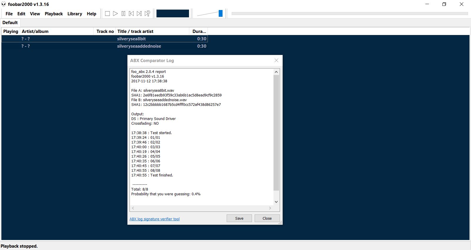

Wow! You've just shown that you can hear the difference between a dithered quantizer with triangular PDF dither and real additive noise, even when the RMS value, peak value and probability distribution of the additive noise are made as similar as possible to that of a dithered quantizer with triangular PDF dither!
What did the difference sound like to you?
The difference was quite noticeable to me. If I could liken the second sample to placing a gramophone stylus in a plain groove, then that is how it came across. There was a different audible component to that track, more sort of midrange (in frequency) grungy noise. Quite pervasive and noticeable.
