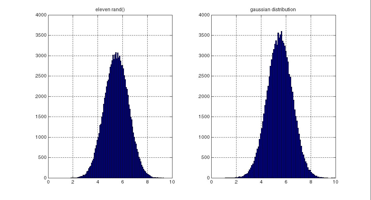

According to the GoldWave manual, rand
I've checked several times in several ways whether it's uniformly distributed and as far as I can tell, it is.
Is the addition of 11 uniform distributions a quick hack to simulate a gaussian distribution?
The figure shows the resulting histogram.
That's the central limit theorem at work, but no, according to the theory you need the addition of eleven uniformly distributed numbers to make the first eleven moments of the total error independent of the signal. You might consider using a Gaussian distribution as a reasonable approximation for the addition of eleven uniformly distributed numbers, though.
How many LSB of noise is ideal in the case of 11 uniformly distributed rand numbers?
In your goldwave example the SNR would suffer badly in comparison to
a rectangular noise of 1 LSB.
Each of them has to be 1 LSB peak-to-peak, so you loose 6.02 dB (or 10 dB*log10(11+1) - 10 dB*log10(2+1) to be precise) compared to normal triangular dither and 7.78 dB (10 dB*log10(11+1) - 10 dB*log10(1+1)) compared to 1 LSB peak-to-peak uniform dither.
The reason that I chose 11th order dither for my first experiment and not some other order was that you can exactly compensate for the difference in RMS noise level with triangular dither by adding 1 bit.

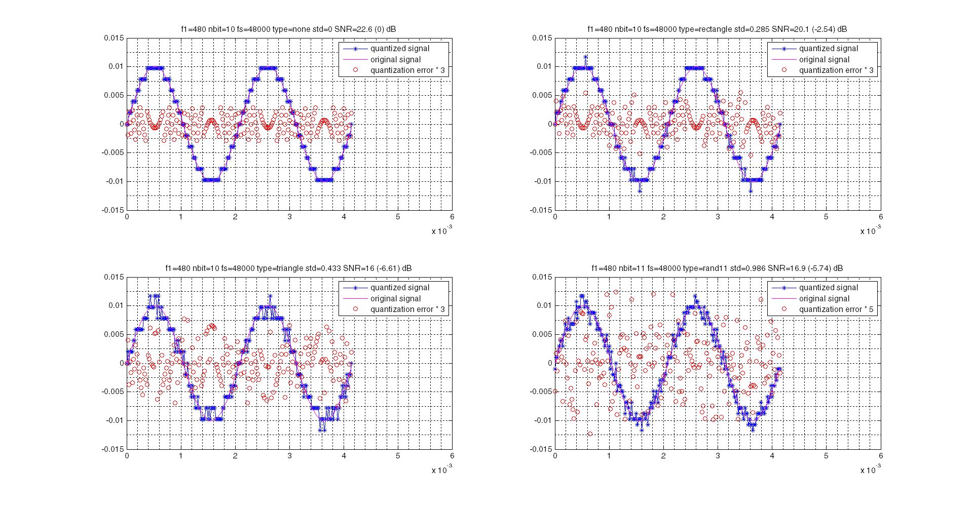

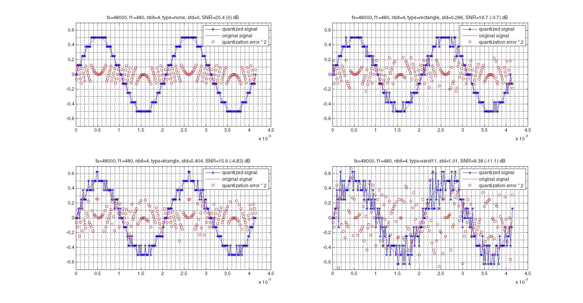

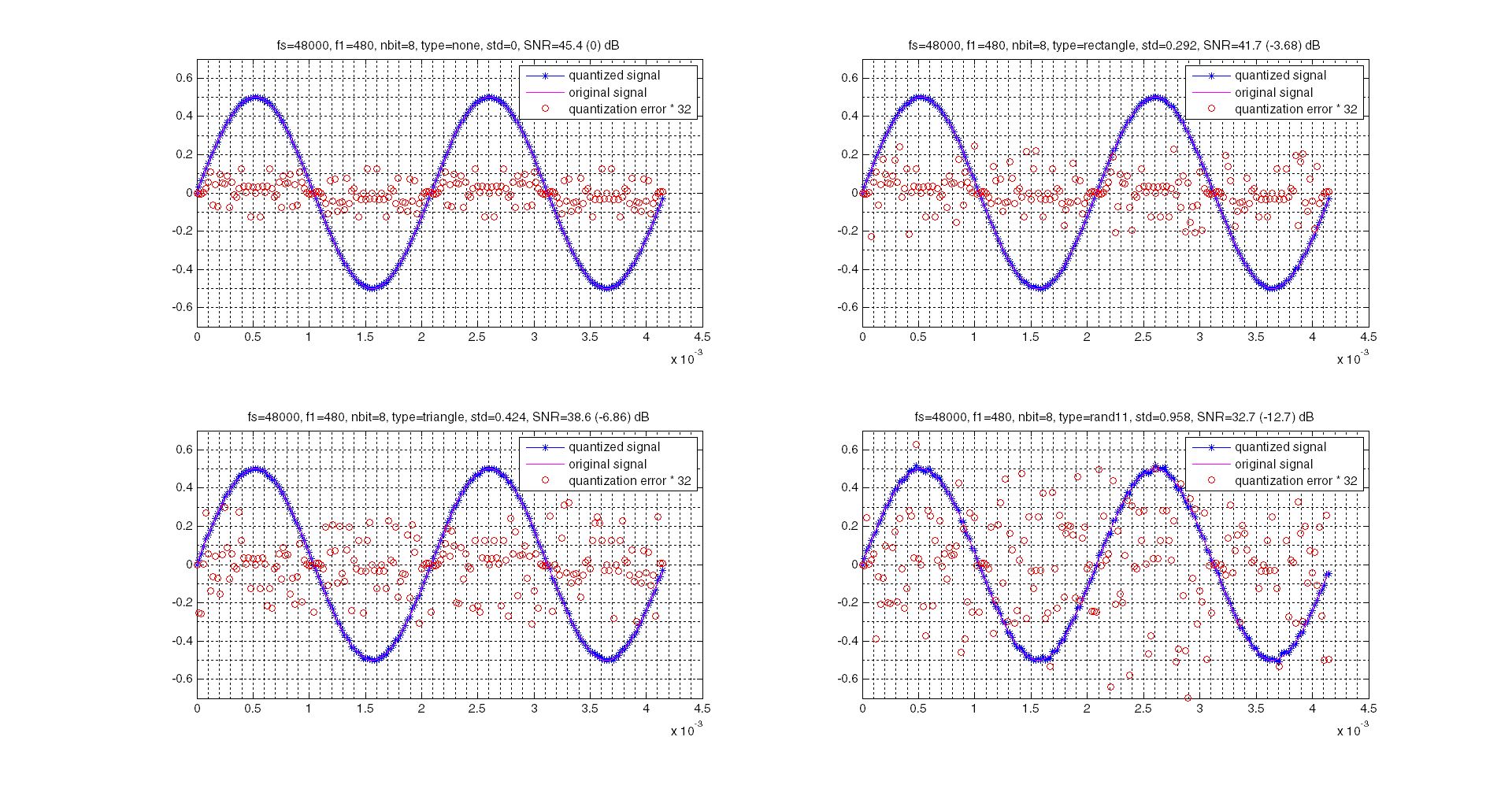

I simulated the dithering for 4 and 8 bits in Matlab to better understand
what is going on (see picture).
The quantization error looks much more random in case of the 11 rand(),
but at the cost of SNR degradation. Your math seems to be ok.
I looked at the spectrum too, but did not see much difference. Any
random dither seems to break the quantization tones. These tones
only occur if the sample frequency is a multiple of the signal frequency.
In normal music they should almost never appear.
For the audio test files you have to be careful that the added noise has the same
loudness.
loudness.

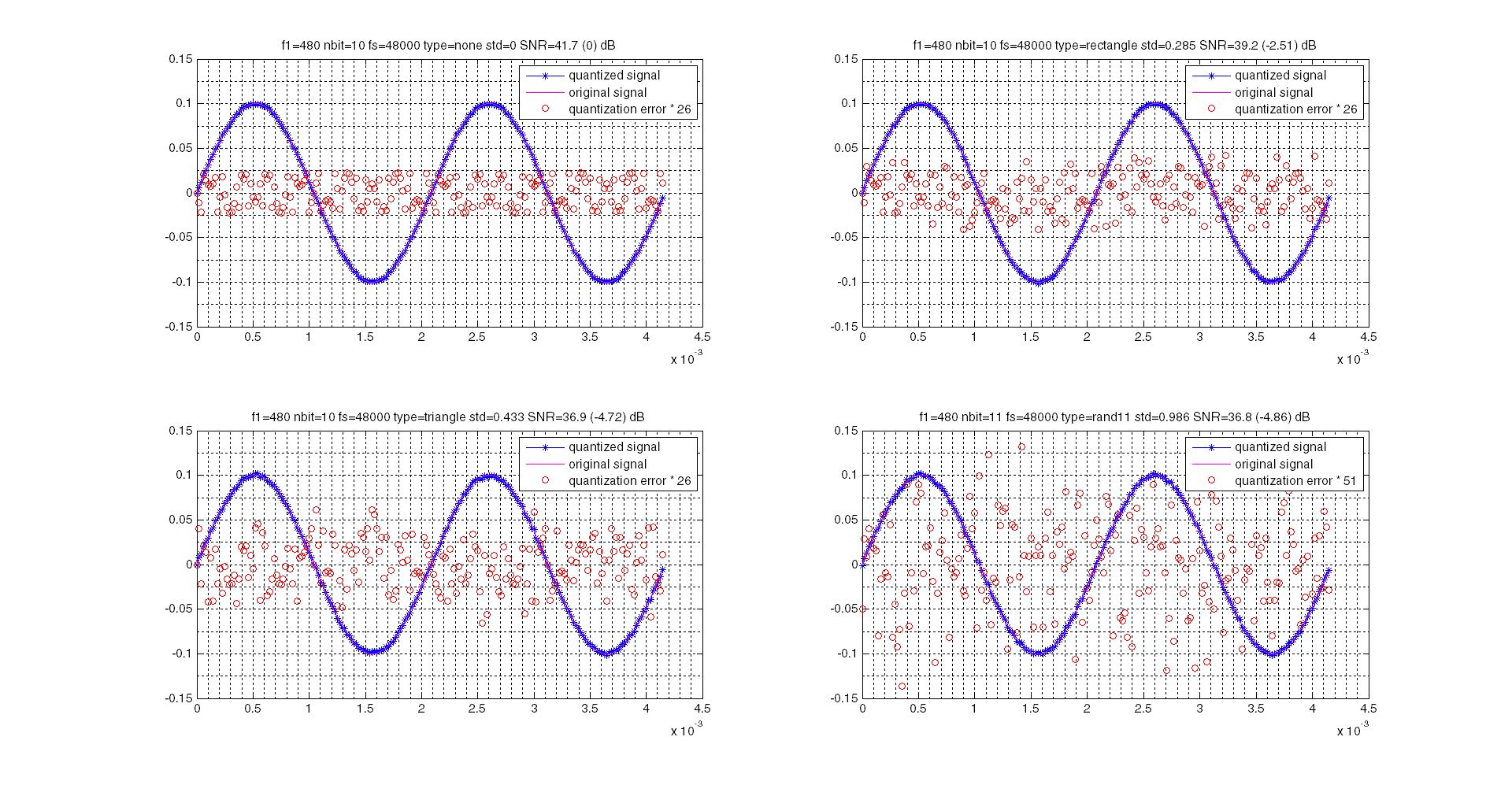

I managed to attach synthetic wav files with different dithering methods
in 10 bit quality (the 11-rand quantized file has 11 bit).
The files play a 480 Hz sine with -40 dB fullscale.
The level is rather low to bring up some correlation in quantization noise.
In the plots of the quantization error i can distinguish them.
If you are interested, try a listening test.
I added a the same files with -20 dB instead of -40 dB.
In the plot of the quantization errror the correlation is much lower.
(std in the subplot title is the standard deviation of the added noise)

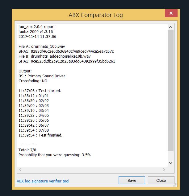

I have just tried Pavels drum file and found it very difficult. Once I had trained myself to seemingly pick a difference I could get a fairly reliable result but this was using utmost concentration.
The 12b file eluded me, I couldn't pick any difference despite a few attempts.

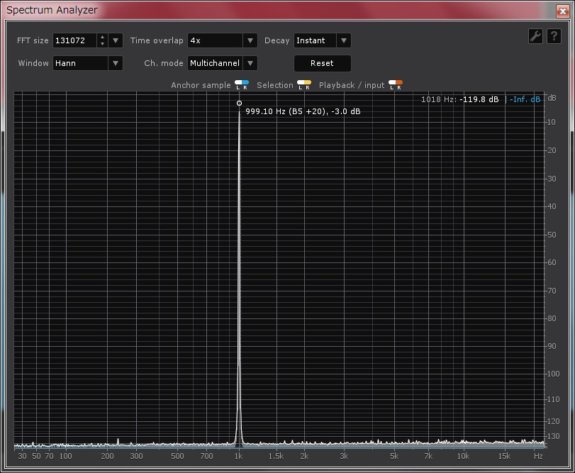

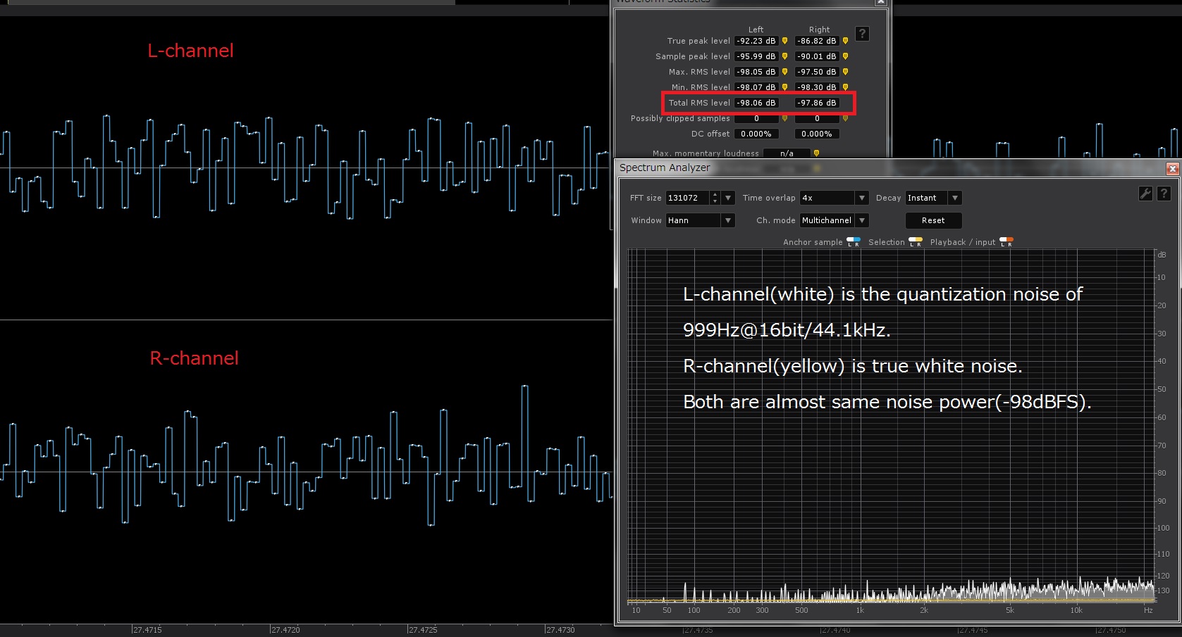

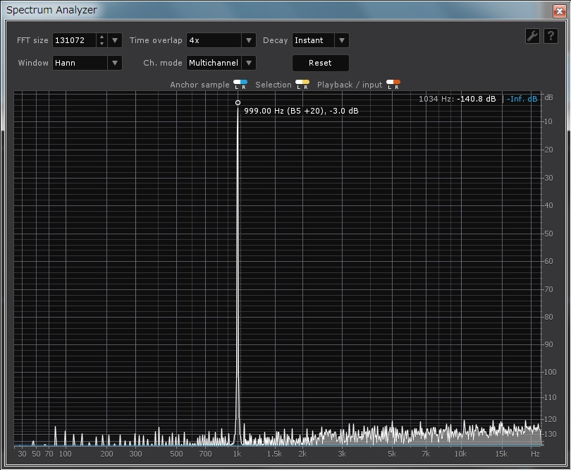

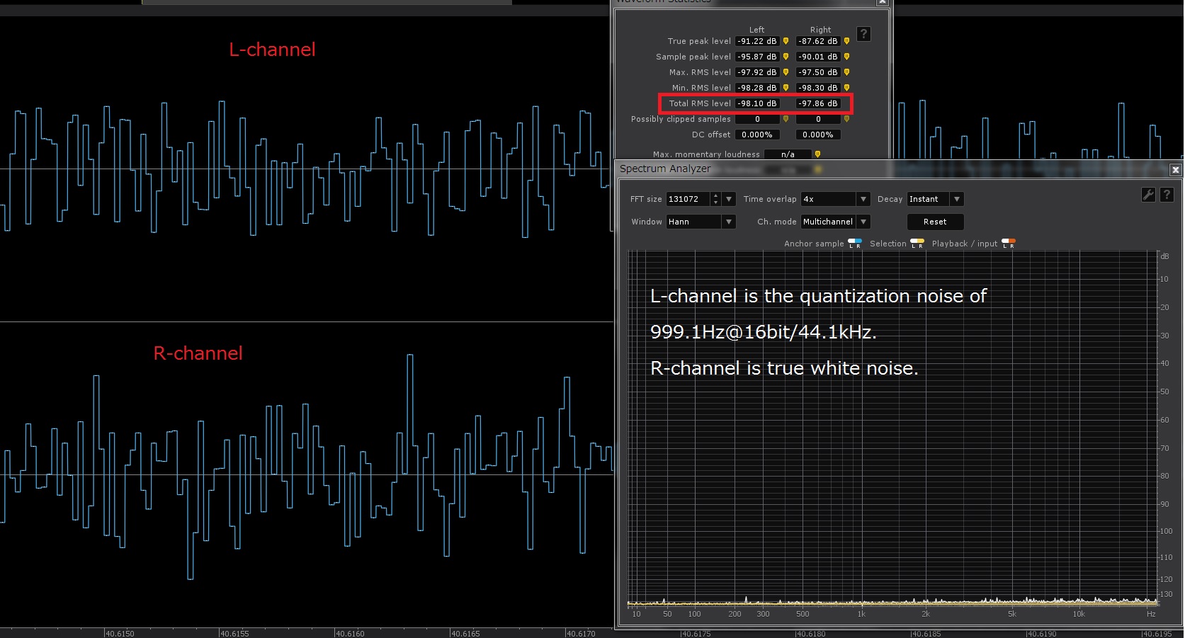

Hi, udok. You are correct. Generally speaking, the quantization noise is white noise as you say and many textbooks also say so. But as far as I tested before, everything had some relations to the input signal. That's why I thought the white noise wasn't a general case but a special one.
I usually use 1Hz resolution, i.g. 999Hz or 1000Hz. The 1Hz resolution doesn't make a white noise like the former two pics. But 999.1Hz brings me a white noise like the latter two. More than 0.1Hz resolution is probably needed to make a white noise(999.11Hz also has a white noise). I think the 1Hz resolution isn't a general case but a special one. I should sometimes use the 0.1Hz resolution to avoid misunderstanding.
Your attached file is 480Hz@8bit/48kHz. The quantization noise of type =non is multiples of 480Hz, not white noise. Other three files have white noise. I guess the relationship to the fundamental was broken by added dither.
