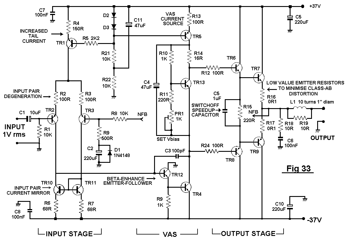

That s no more than the classical blameless refined without some limitations that are present in Self s schematic,
i stated the transistors references.

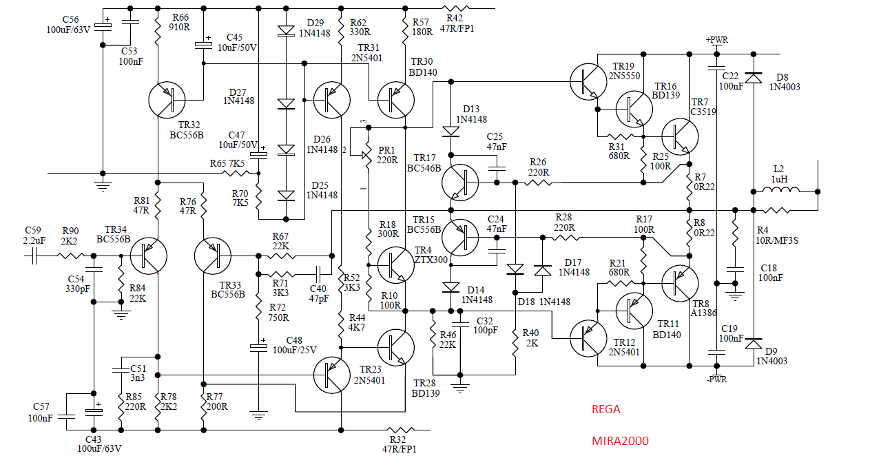

D. Self s Blameless schematic is this one, that s quite different from the Cambridge audio, he specify his improvement points,
this is a good basis that can be enhanced in some details and this kind of topology is one of the most efficient when
it comes to the perfs/component count ratio.

You have recognized this correctly Bernard, except that both perform the same task with more or less bravura as an AF power amplifier.Ok, that is a standard circuit that has exactly nothing in common with the initial schematic.
I say that always and everywhere

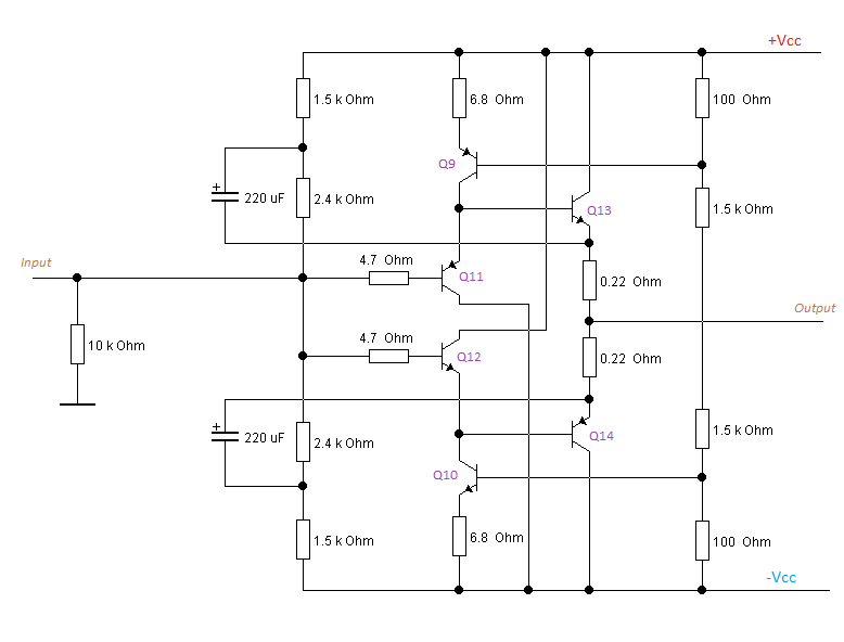

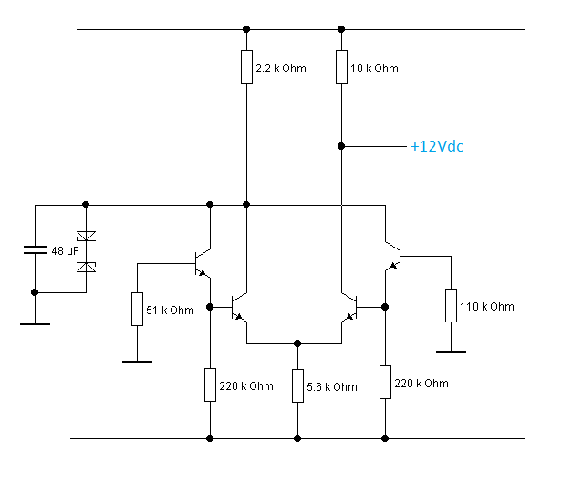

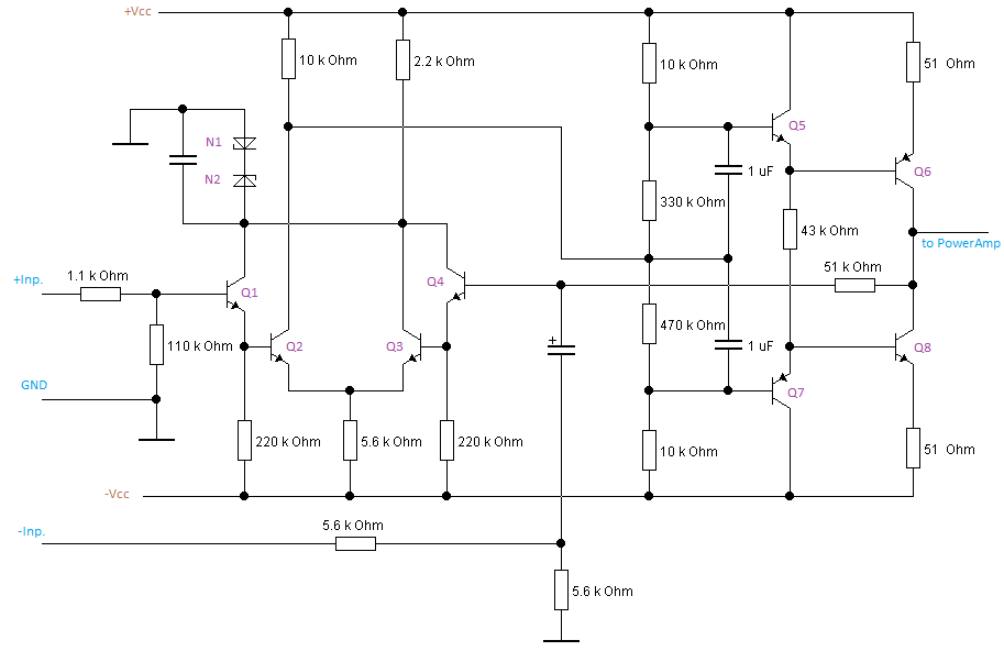

This would be my first modification, two 2.7V Z-diodes. 2SC2240-GR or BL and BC550C. Separate power supply units are a matter of course. The unloaded potential of +12V is pulled close to zero by the peculiar VAS.
But I don't want to stick to the original either, not by any means.

Tim's outputstage - the Diamond Buffer
This is a very quick modification, without any simulation. I think it's better to look at this and the first stage on the actual test setup.
I am convinced that we can create a functional Stellema, the Tim.
Some key points must be finalized in the test setup.
Have fun and enjoy it

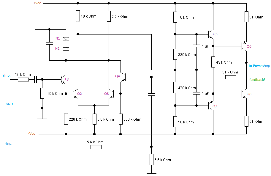

Initial Summary
Ed's points of criticism were
1) the circuit should be operated with a stabilized power supply unit
2) the dielectric strength of the coupling capacitors is not sufficient
3) the THD achieved is solely due to the degree of coupling-factor, the negative feedback!
wahab's points of criticism were
1) the dielectric strength of the semiconductors used is not sufficient
2) coupling capacitors are unforgivable
3) the entire circuit is a inverting one
4) without frequency compensation the circuit oscillates
5) strange VAS-Struktur
6) no Douglas Self's blameless design!
We then buried the original design, but someone didn't give up and exhumed the corpse - Dr. Frankenstein got to work.
His creature is now waiting to be electrified
No, of course I don't do that.There is no harm in electrifying it - just don’t expect world class performance.
<0.03% THD in the 30Hz to 15kHz range, between 500mW and 10W, is perfectly fine for me personally. Better than this scenario is also very welcome.
