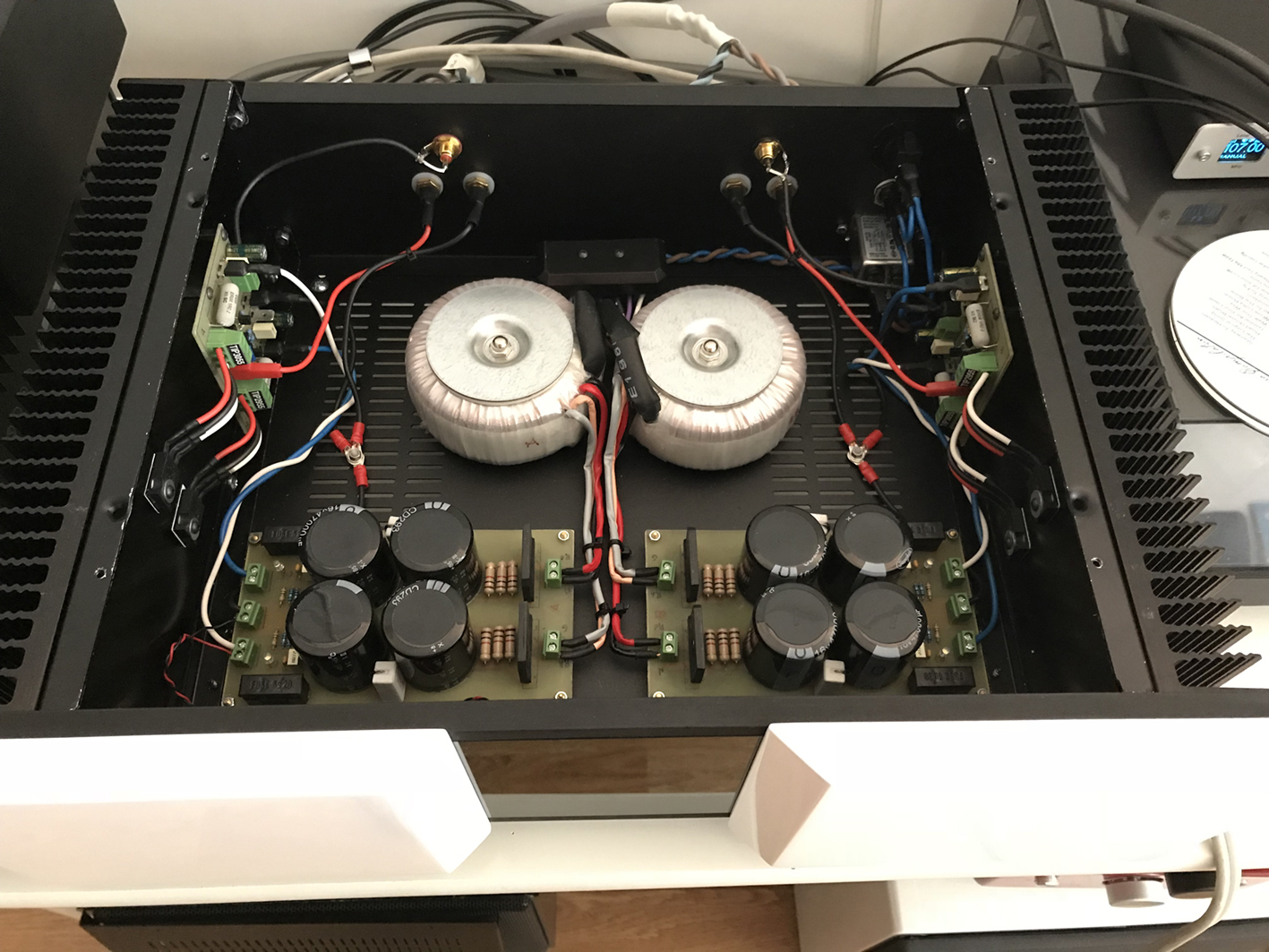

Hi, this is my "Hiraga monster"...
I use 2 x 47000 CRC in each supply rail. Transistor TIP3055 TIP2955, JFET 2SK246 2SJ103, BC for drive output.
Sound is great...
Since it is easy to change the components I would like to try other solutions. Tips?

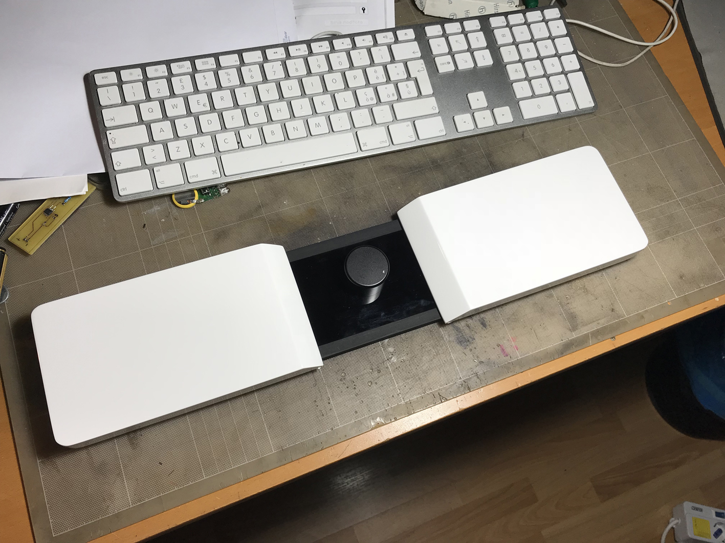

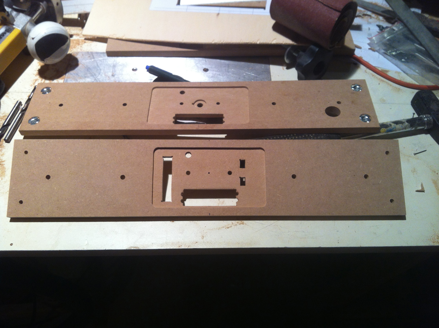

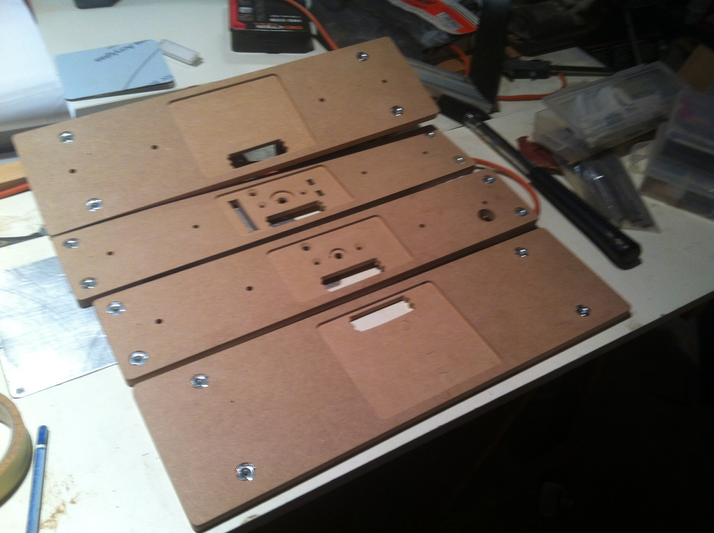

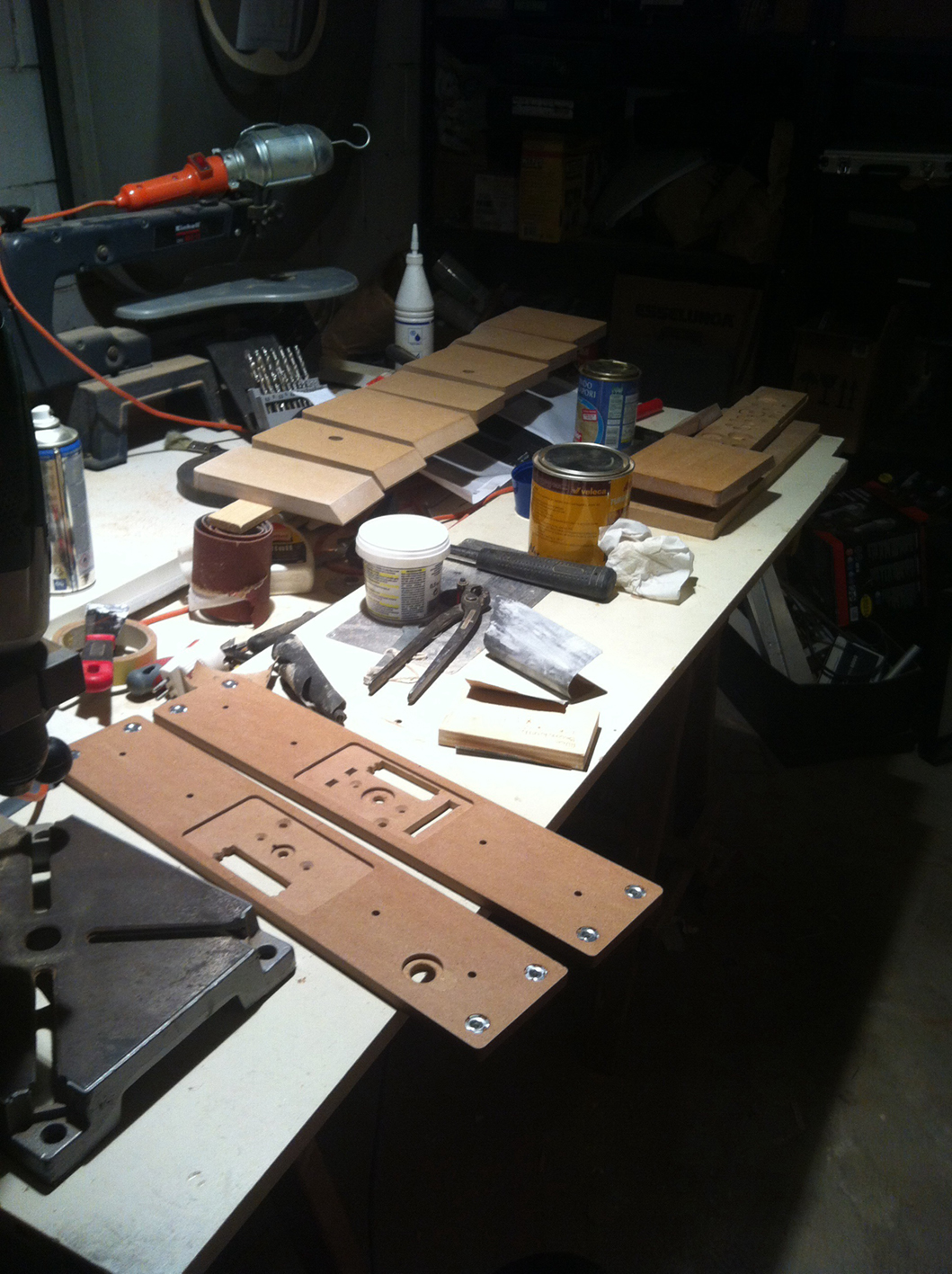

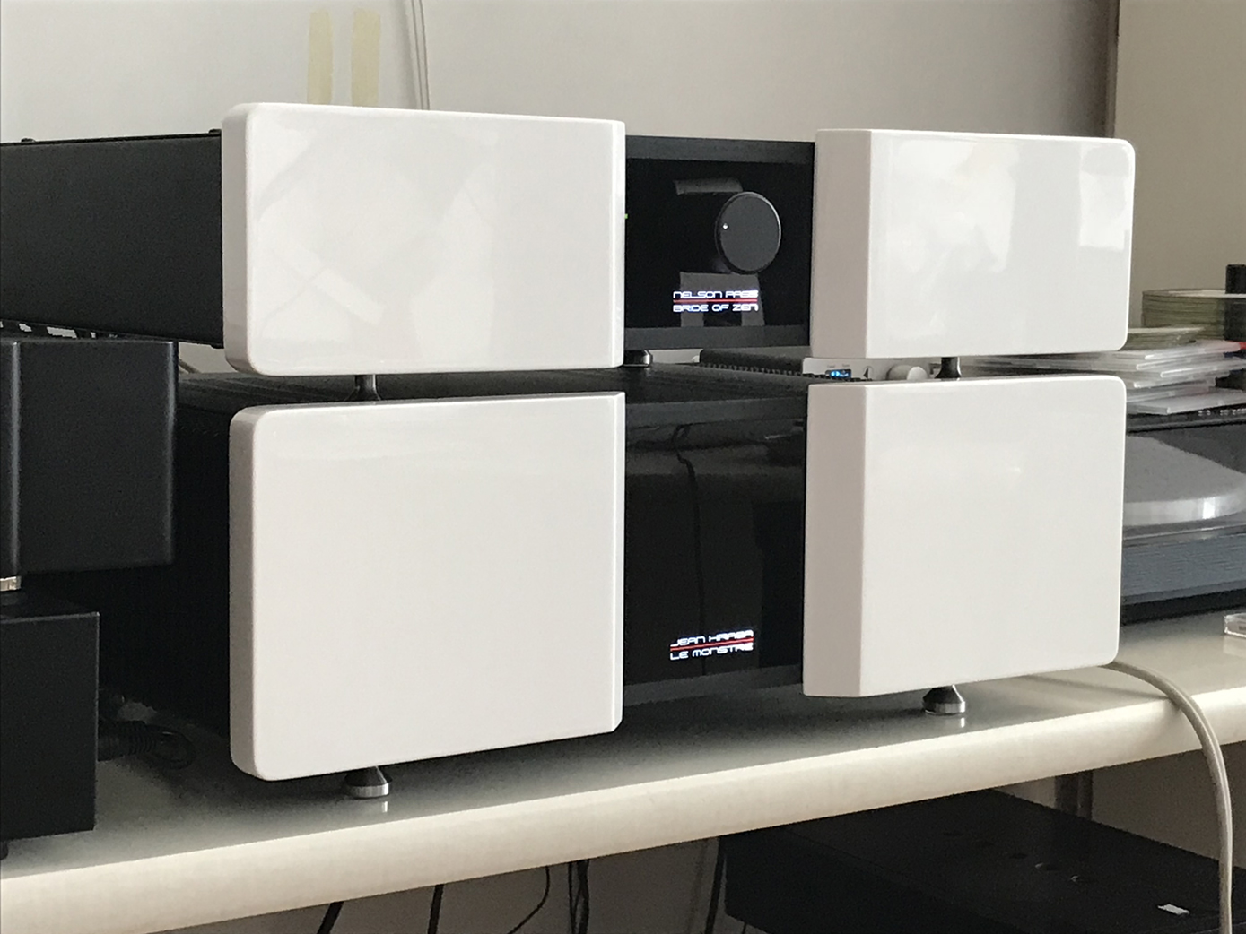

Dino that case is lovely man! Did you build and design that yourself? Lovely build!
Thank you for appreciation!
Yes... handmade homemade...
MDF, plexiglass for the front panel (in place of the aluminium original panel) on standard U3 U4 cases.

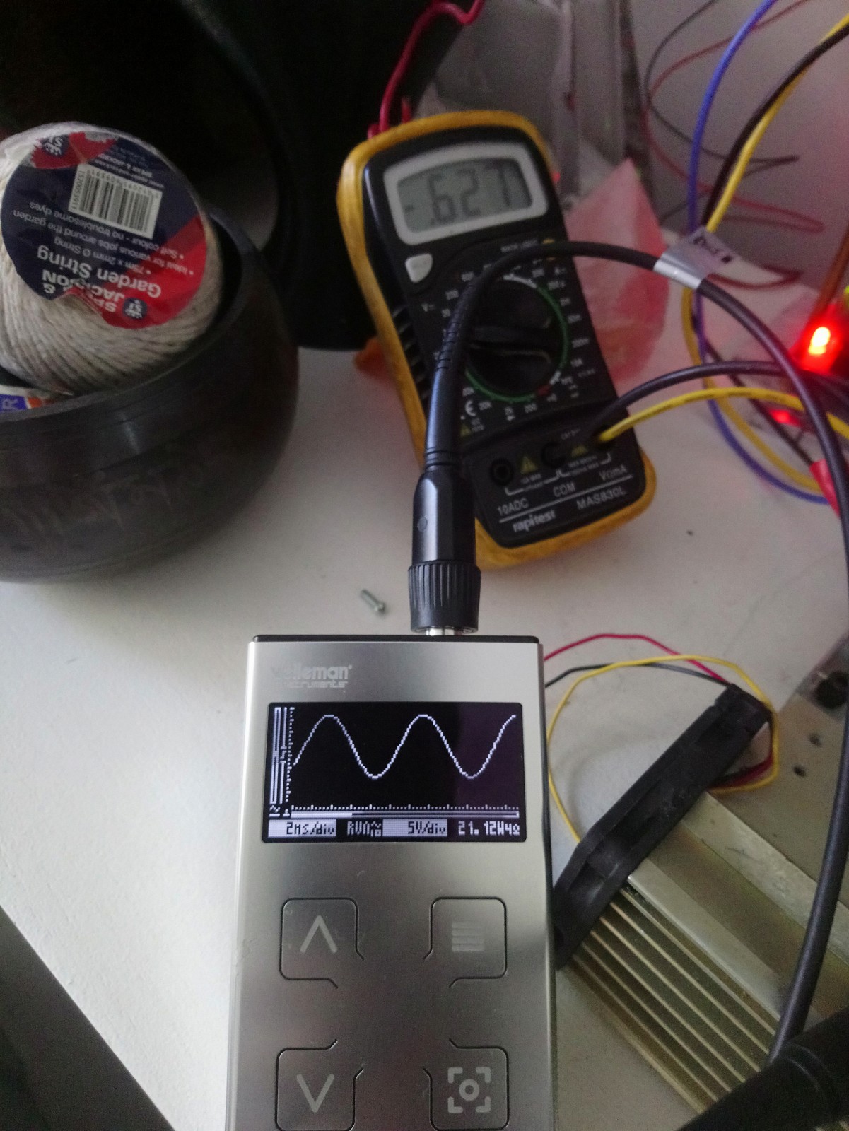

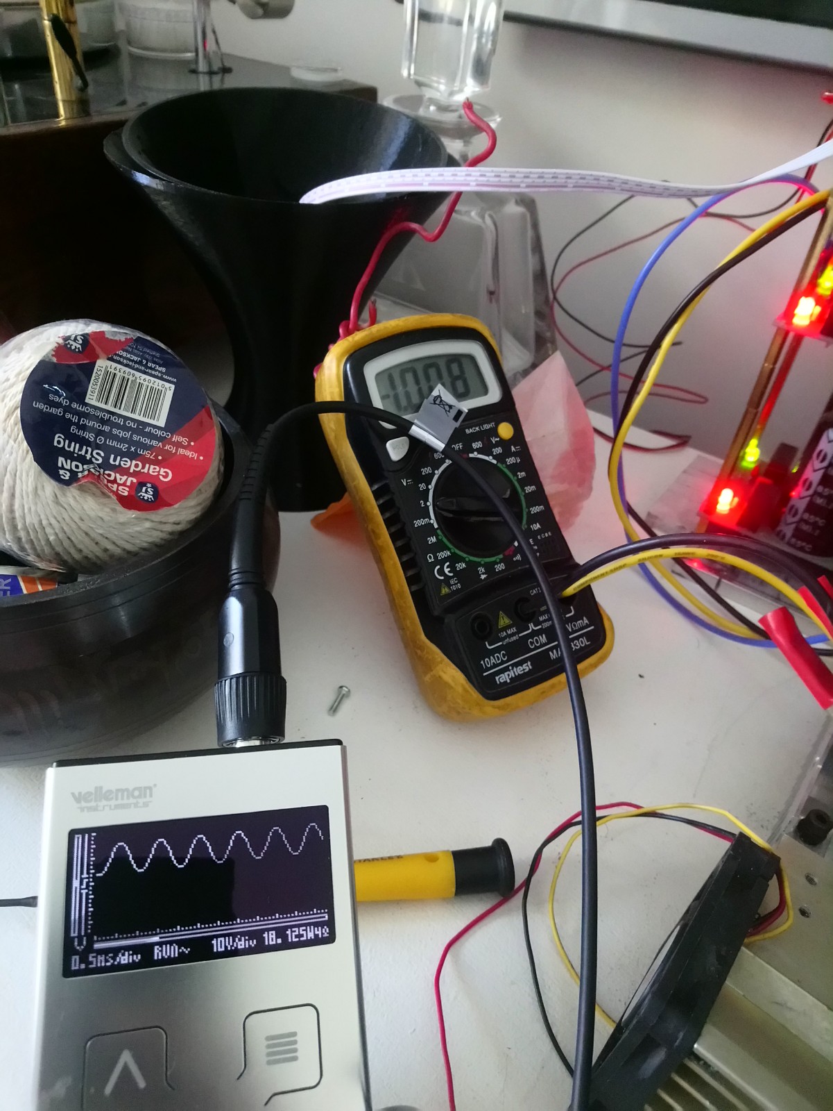

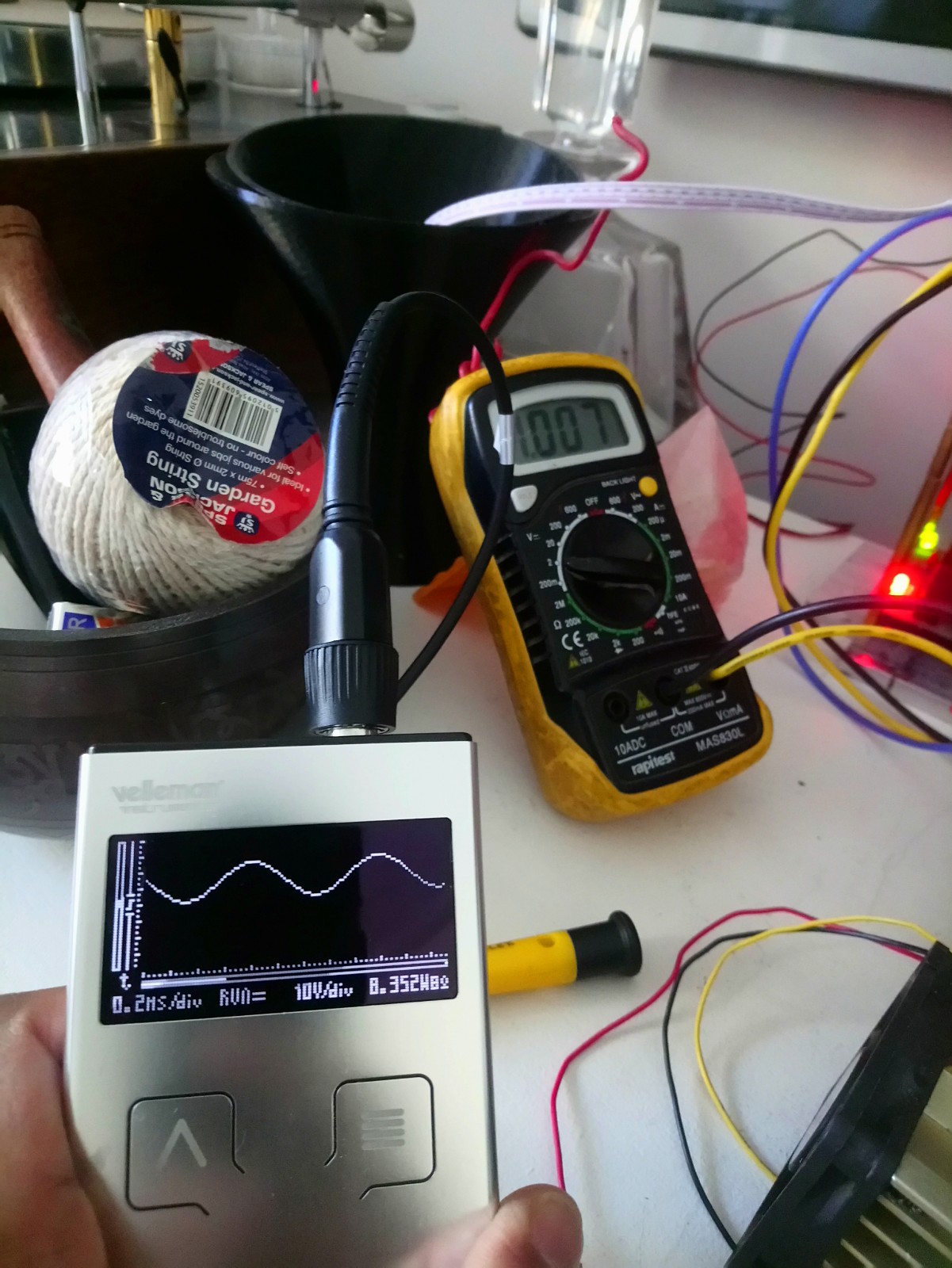

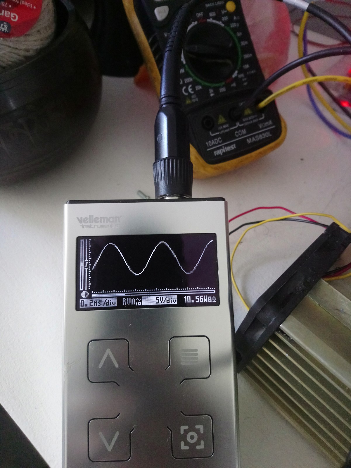

Voltages, instability, Darlingtons.
I have to agree i've been playing around with the darlingtons mainly at 0.6v, 1.0v and 1.5V.
it takes time and patience to get the bias, dcoffset stable and working together, i have to fiddle and move each potentiometer at different positions,i could never have done this without installing those potentiometers.
Dan for you the voltages
0.6V (more stable, easy to setup and sounds better)
V+ 16.31 V- 16.33
1.0V
V+ 15.89 V- 15.98
1.5V
V+ 15.38 V- 15.44
Well these do work it's a ball ache to setup but at 0.6V they do sound good!
Would i use them? Probably not!
No, they seem to work anyway. It's just that the original circuit wasn't designed with darlingtons in mind. But if it measures reasonably and, most importantly, doesn't oscillate, it's OK.
I suggest also to do an FFT, eg with a soundcard (be careful to not blow it, divide the amp output down...) and Arta, REW or whatever software suited for the task.
I have REW and a mini dsp mic, i usually use this for measuring speakers. What did you have in mind?
Can i do a frequency sweep of the amplifier and measure it?
Thanks for the recommendations on transistors.
You don't need the Mic. Drive the Amp directly with your Soundcard output, and route the output of the amp back into the soundcard input.
What soundcard do you have?
WARNING:
You must divide the Amp Output down through a resistive divider!!
Otherwise you'll fry your soundcard.....
Chose a ratio that will bring the levels back to the soundcard output level (if your Amp has a gain of 20x, divide it at least by 20), before feeding the soundcard. A good thing would be to additionally protect your SC input by back to back zener diodes (3.3V types would be OK).
Take care that your Soundcard (PC) and Amp share the same ground.
REW has Help Files, on a first glance the following apply:
Signal Generator
RTA Window
Distortion Graph
Start with a sine at 1000 Hz (you may load the amp with your preferred 4 or 8 Ohms load, of course), and look at the spectrum (RTA Window).
Start with low levels, increase them, play around. Look what happens when the amp clips. Look what happens when you measure with higher frequency, eg. 4 kHz. Look what happens when you feed dual sine.
The distortion graph needs sweeped sine, or so.
You can learn a lot looking at an FFT graph.
