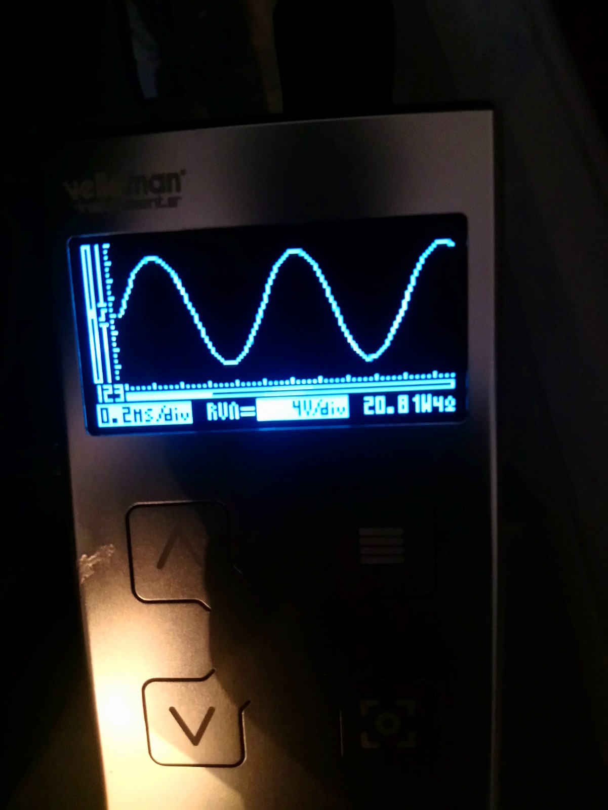

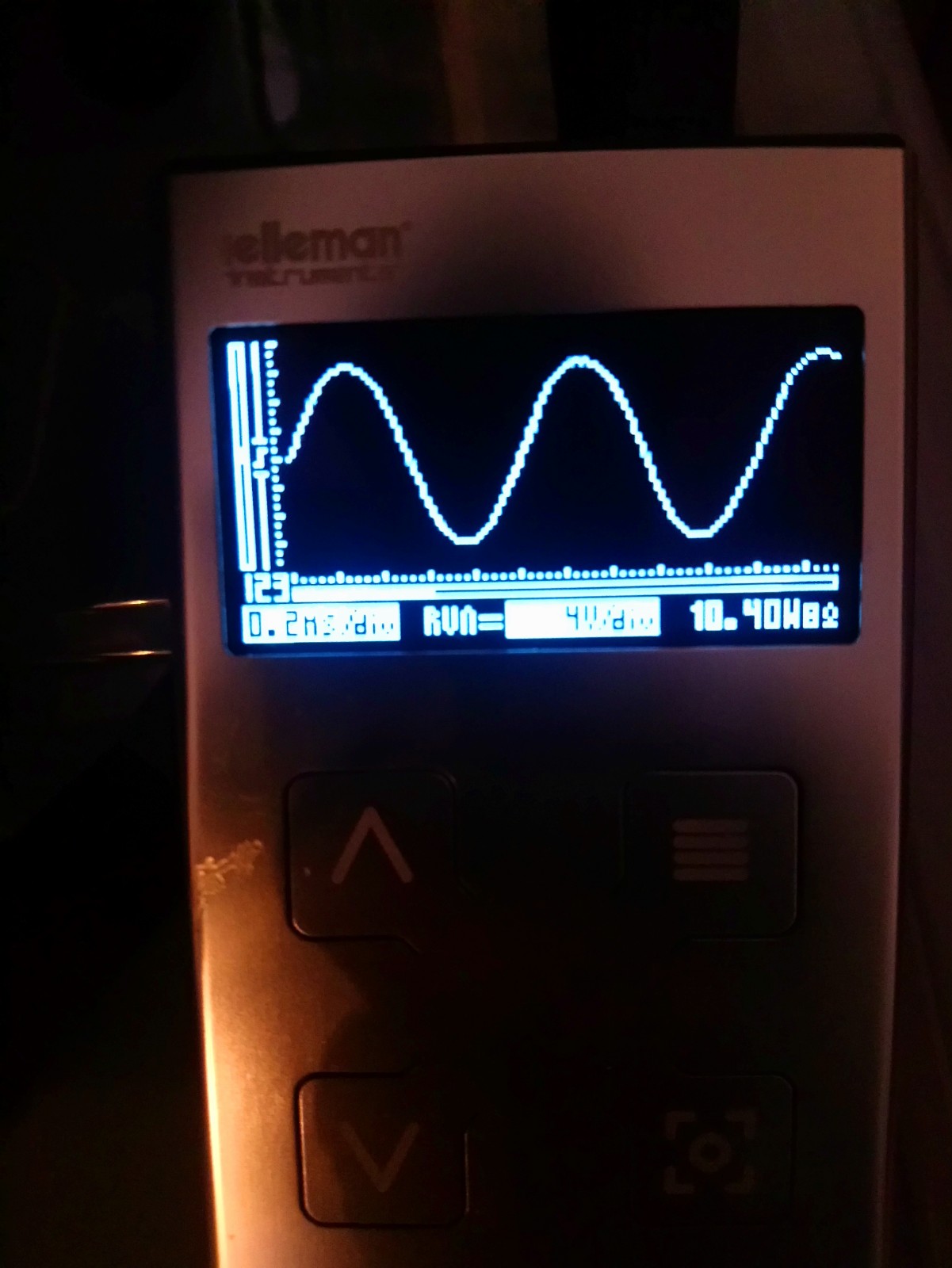

So i decided to stick the mjl21193 and 94's in. I set it up at 1.5A bias and let it warm up for an hour. I can tell you now these were easier to adjust then the sankens!
after setting adjusting everything i played music for another hour, there definitely more volume and a different sound. Those temperatures went up though hitting almost 70 degrees! You couldn't touch the heatsinks, so stuck the fan on and it brought it way back down.
What is a safe operating temperature generally? that i can use and sustain without issues?
anyway hooked up the scope to measure the watts.
i just dont get it maybe my PSU just cant handle this type of load.
I get 10wrms at 8ohm and 20wrms at 4ohm before clipping.

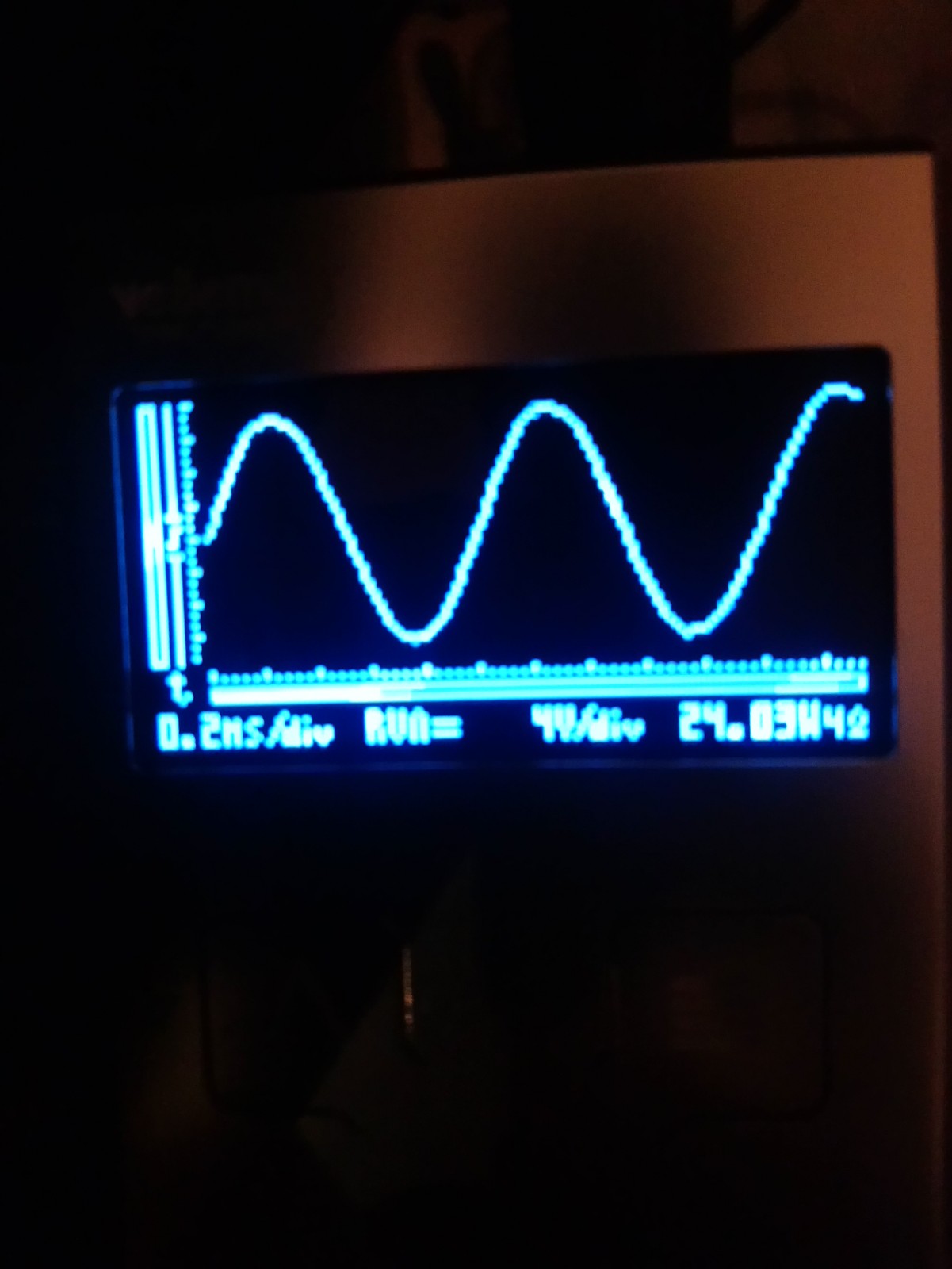

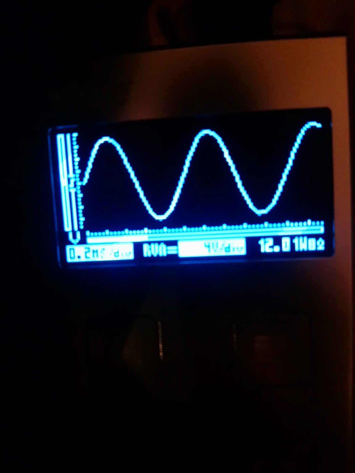

Now when i run it at 0.6A (same process, wait for an hour, adjust, wait again read adjust then test).
I get more power?
This time i measured 12wrms at 8ohm and 24wrms at 4ohm!
But to me it sounds better at a higher bias, maybe im imagining it and my analytical brain tells me more power is better!
Who knows, i think i have to find a balance between 0.6 and 1.5A.

Your maximun power reduces with 1.5A bias because your supply rail voltage drops due to the higher Quiescent current.

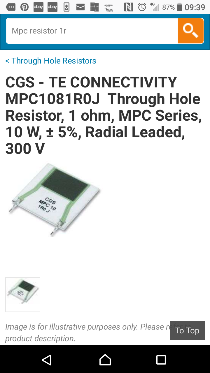

I would stick to a big nonmetallic carbon (based) resistor.

No need for carbon. Metal film / foil is good (to me way superior to carbon, but that is of course debatable, just not with me).
A short search at the Farnell site gave me these resistors:
OHMITE TNP10SA1R00FE, not cheap but not crazy expensive either.
They are non inductive, as they are not wirewound. Attach a Heatsink, however.

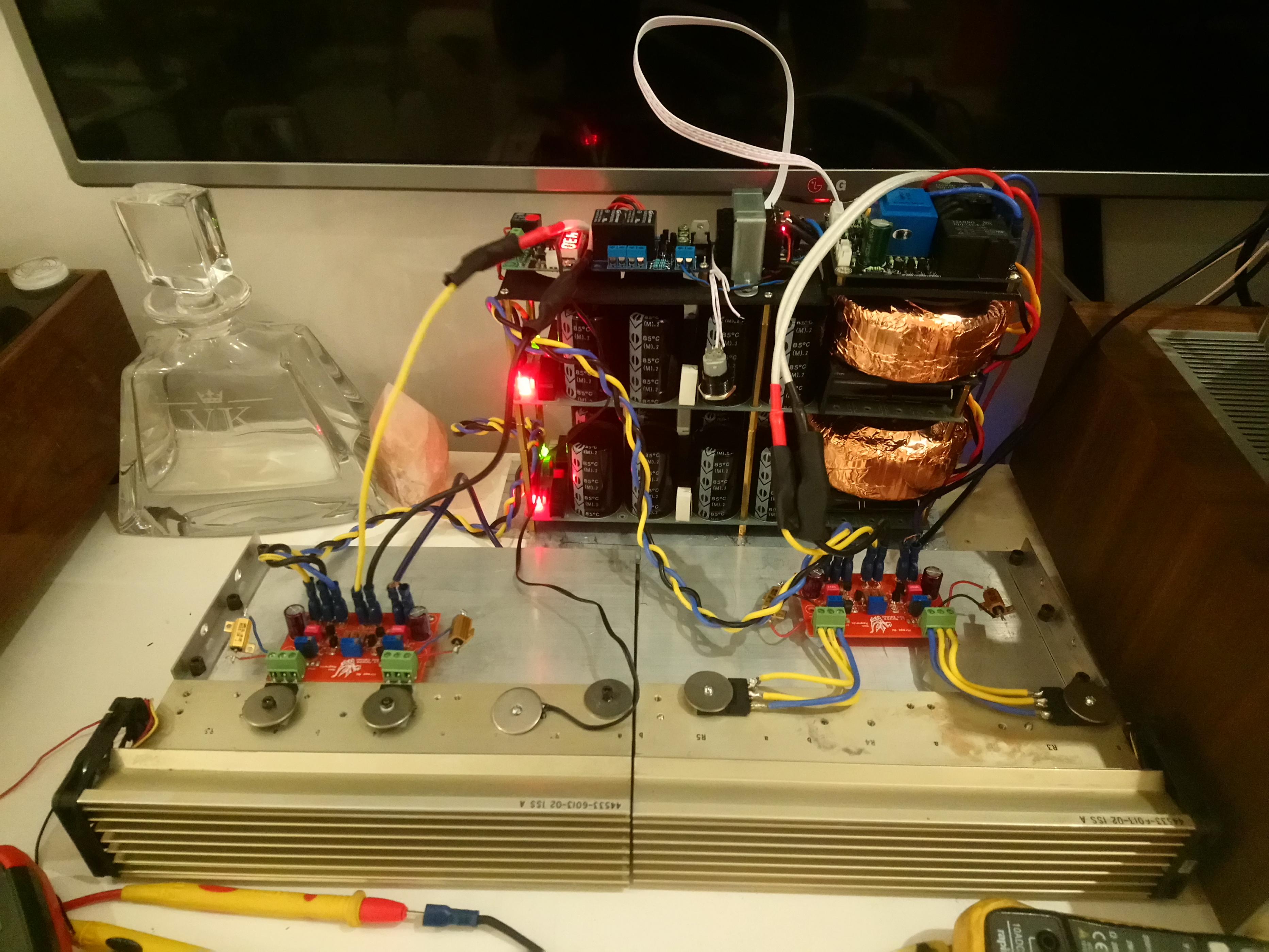

Second channel working! refining and getting it right.
Finally the new driver arrived today so i was able to solder it in and get the amplifier working again! We now have both channels working
One has the sankens in and the other has the MJL's.
One thing to note, is the dc offset affected by temperature rise?
I just want to clarify how to setup the bias and dc offset.
1. When everything is cold i switch the amplifier on and adjust the bias till i get around 0.6v. Then i adjust the dc offset which also affects my bias, i generally play and fiddle with each potentiometer until everything is level and the offset is at zero, to be stable generally means i have 0.61v and 0.63v (is that due to the transistors not being exactly matched?)
2. Leave for 1 hour come back and check bias and dc offset, check and adjust as necessary.
3. Play some tunes for an hour, recheck and adjust?
Now when i've done all this and everything is stable and the temperature doesn't move its all singing and working well.
Now when the next day when its at room temperature and been off, if i switch it on and check my dc offset its not at zero, but when the amp starts warming up its starts to slowly moves down zero as at heats?
Is that correct, sometimes its the same with the bias, and also is it me or when its warm it really starts to sound so much better.
It's like i have to switch it on, leave it for to warm up then play my music.
Basically im asking people methods of setting up so i can do the same then know i can leave it and its good to go.

Thanks for the link on the resistors i found them cheaper on mouser! So i will order them.

How much the DC offset?
Of course, you set up the DC offset at industrial warm.
I had the same issue with my LeMonstre, even the bias moved at warm up.
If you have 1V DC at cold that is not a problem as long as your speaker's protection does not kick in.

I would buy 2R and use 2PC to get 1R 10W. Did you ever tried plate resistors like KOA etc. to me those acceptable also.
