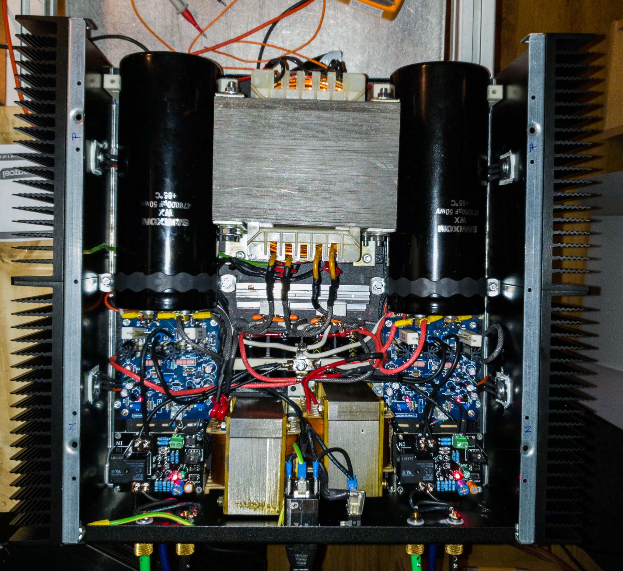

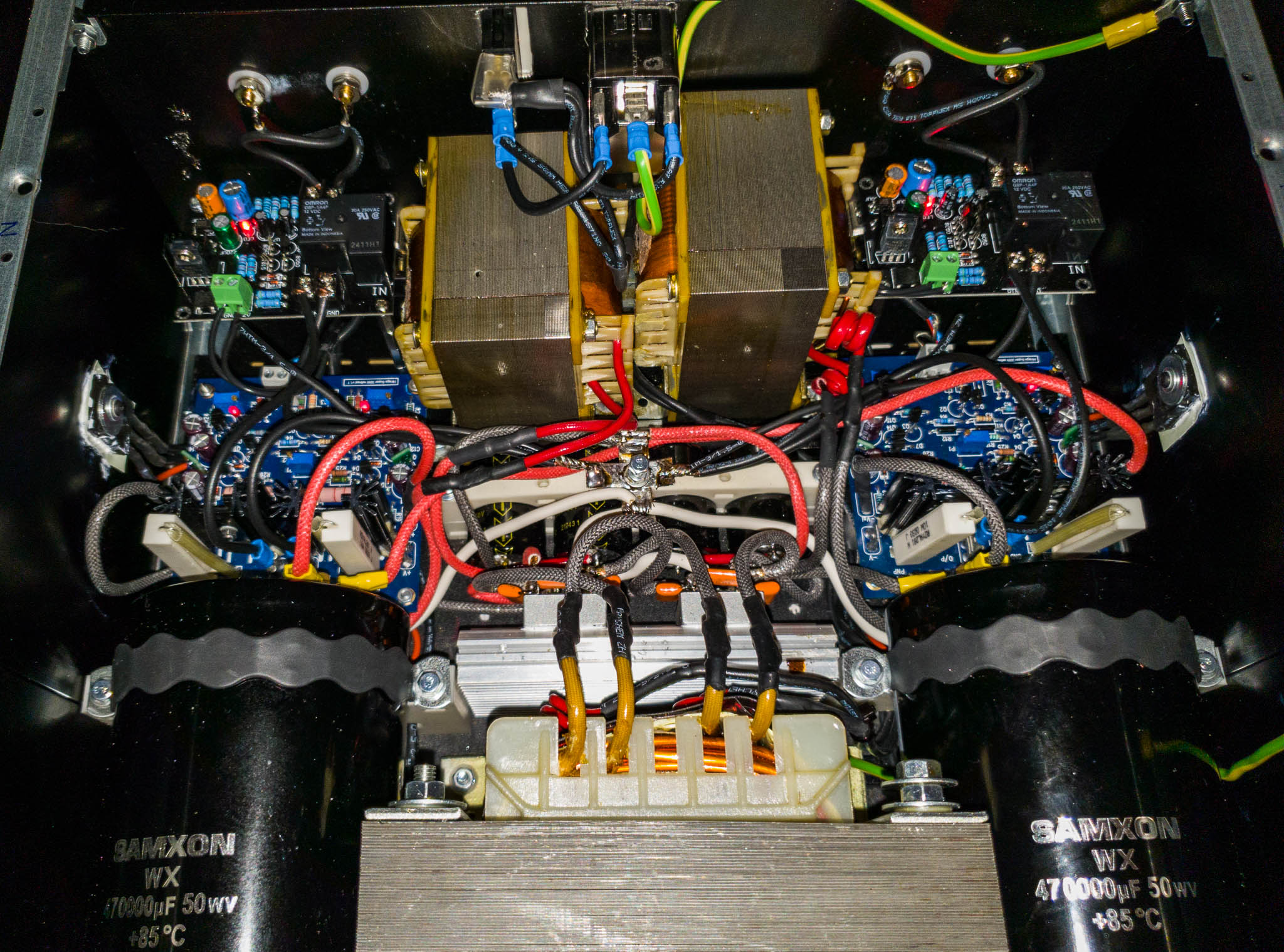

Time to rebuild this into a new chassis
Deciding where everything will fit
putting it together
Parts all tapped and bolted into place, wires laid out

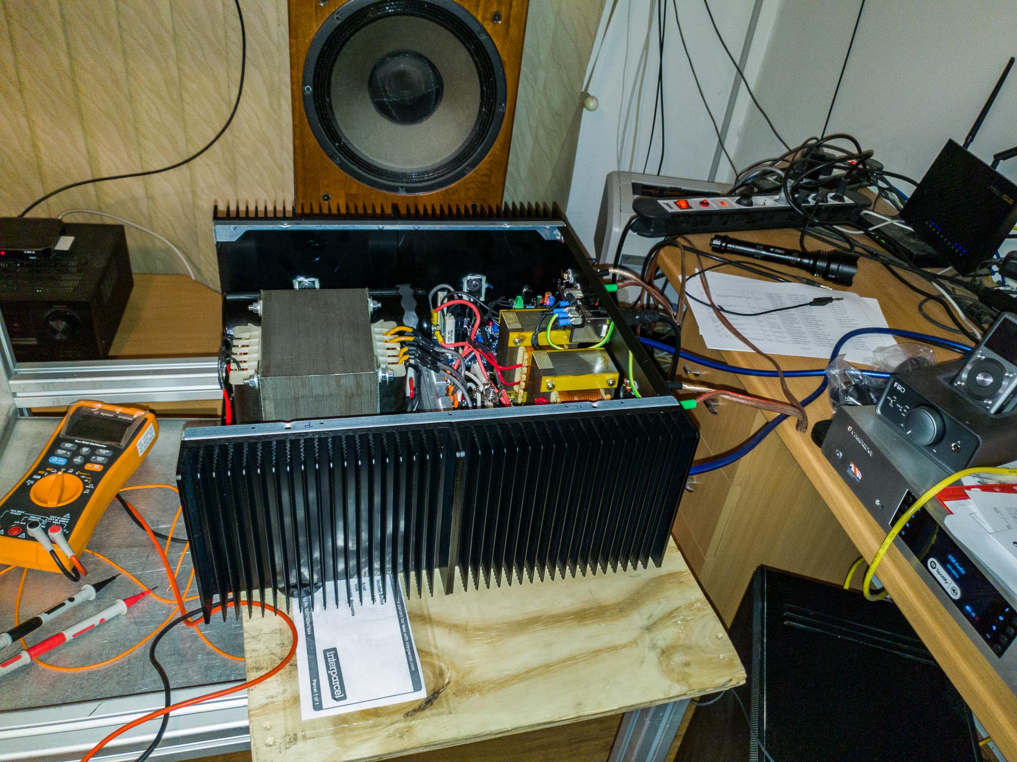

setting the bias and checking everything is as it should be
Ready to go and play some tunes!
Sounds phenomenal and came out really well, especially cramming in the large rectifier/capacitor boards.
Thanks to all who helped guide and educate to be able to do this.

Depend on your transistor choices and all the other parts. I built mine with the original transistors (the power semis was (I think) aftermarket Thosiba stamped from MCM electronics) and sounded just OK. Nothing special. When a simple amplifier like that need to spend time on testing different components to achieve a special sound. Mine also had a problem with some thermal movements. When the amp warmed up the bias climbed higher. I set up 1A and after warm up it reached 1.5A. Otherwise was stable. I built the Class A 20W (several version) and I prefer that over the 8-10W Monster. Not that clinical and more authoritative has better bass (control) Maybe with the right set up, the Monster can sound excellent too, unfortunately, I never experience that. Congrats to your amp and good to hear you are satisfied.
Thanks everyone, been playing around with it and finally decided to a quick build to finalise it and actually enjoy it.
@gaborbela
I agree with everything you say, i spent a few months playing around with bias levels, temps, parts, transistors and careful listening. I also used an oscilloscope with awg fft etc to check for all the things i was doing or trying.
I tried 0.6A, 1A, 1.2A 1.5A. 1.5A was way too hot, the heatsink temps were fine hovering around 51 degrees and in hot weather 58-60 degrees, it was the 1R resistors that were realllllyyyy hot hitting 70degrees, also suffered voltage drop so there was no point.
Anyway parts used were vishay dale rn65, elna simic II, ohmite audio gold NI wirewound resistors for the trannies.
Driver transistors are 2SB716 and 2SD756 JEFTs are 2sj74 and 2sk170.
I tried several types of transistors but for me the NJW0302G+NJW0281G and MJL21194 + MJL21193 were really nice. Here i used matched MJLs (bought many pairs and did my best to match them).
Got it running at 0.6A bias and its swwweeeeetttt and i listen to quad ii's and a leak stereo 20, this was a lovely enjoyable change.

nice build, and quite a hefty PSU. For mounting the transistor, use broad washers on the bolt head, so that there is good contact and even distribution of force and hence proper heat conduction to heatsink..

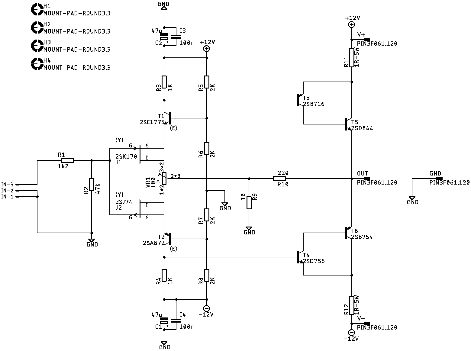

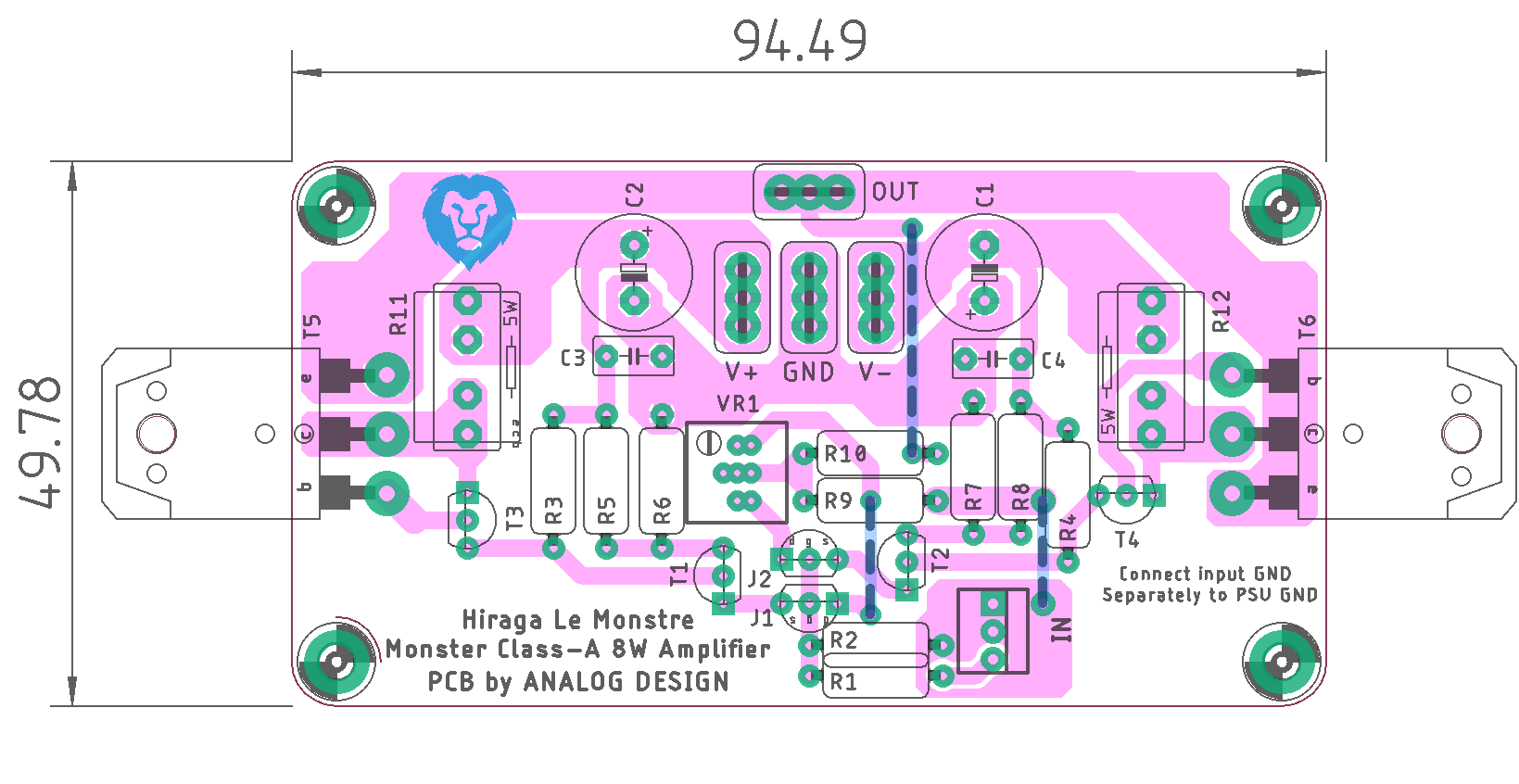

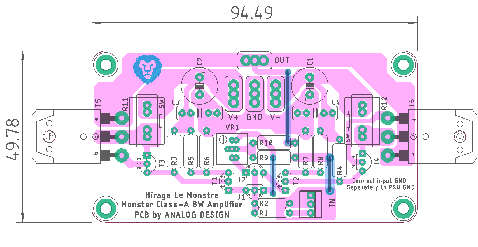

Thanks prasi but what is the today available alternative transistors?Here is my version for DIY PCBS.

Thimios, I will post version with trimmers for R3/R4. I think people have successfully used KSA/KSC transistors (ECB). They have same pin out as that of above schematic in post # 1655 . Hiraga “Le Monstre” 8W A class Amplifier D.I.Y. - HiFiStor
For the output, NJW/ MJL by onsemi are suitable.
Regards
Prasi
