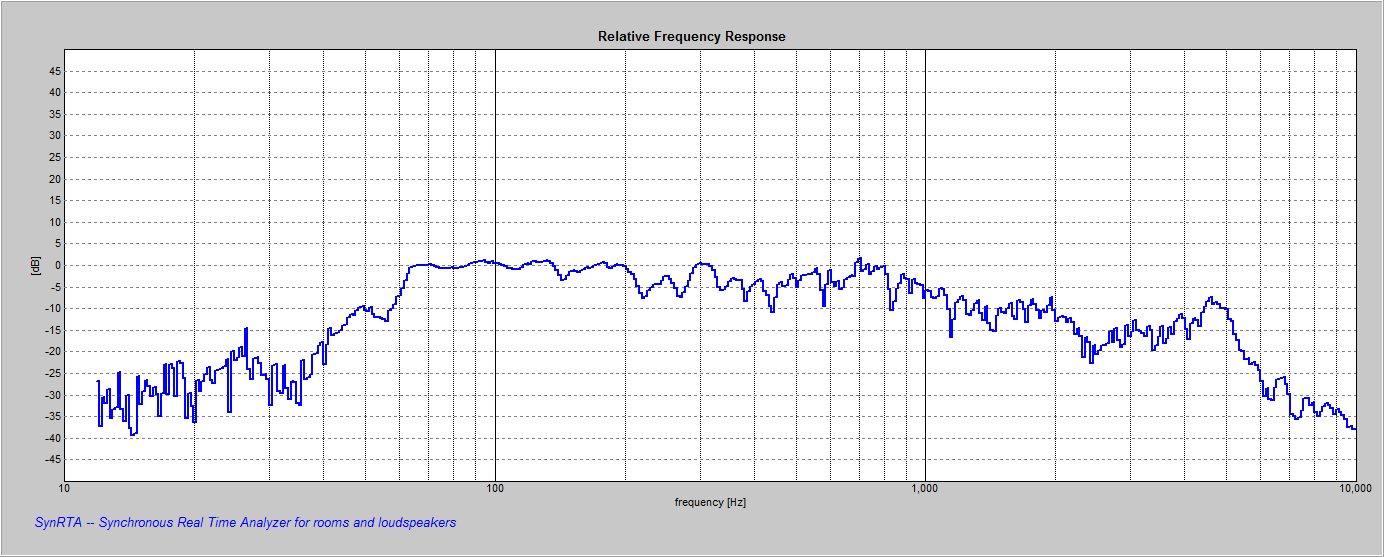

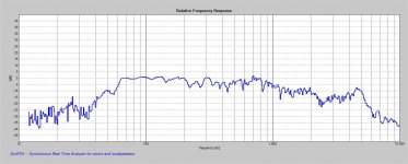

Here is the in room response of the low midrange and upper bass (heart of the system), one channel 15' away at the listening position. Here is where most of the music lives and this compact horn system is built around this range first. This range consists of two parts, one the B&C 8pe21 in a 46" long front horn with an 8 square foot mouth and 4" throat 120 - 1K range @ 106 db/w/m sensitivity. Two, the horizontal floor coupled line array stands for the midrange horn with four sealed 8" woofers wired in parallel with 103 db w/m voltage sensitivity. These two parts are biamped and the upper bass coupling stands operate 60 to 120 cycles and can be precisely aligned with the 8pe21. If you get this range right you will have a basis for a system with realistic in room sound. The bass modules are high passed 4th order at 60 cycles and operate in stereo. The midrange horns can operate up to 800 cycles realistically.

I'll take some pictures soon, it's really compact for front horn system down to 100 Hz. I've managed to reduce the weight of the bass horns to under 100 lbs each. No not direct radiator monitor size but those tend to sound fake and compressed. The midbass horns are fiberglass and I damped them with 4" of compressed memory foam. That stuff gets pretty heavy and really knocked down the noise.

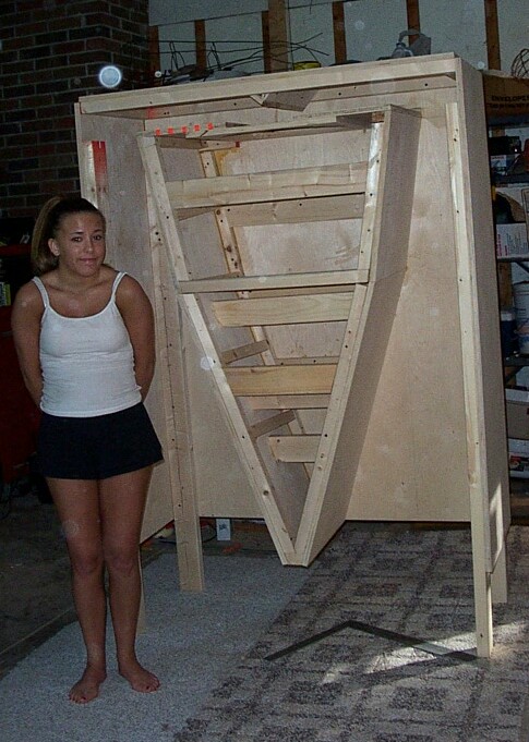

well, I'll be more interested if and when I see pix of what it is replacing, and/or what it is... but you do have a sense of humor...![]()
The picture of the midbass horns= in my moniker is about 800 lbs (pair) of it. The midbass horns I retired were filled with sand and bricks, also retired is two front loaded corner horns (twin 15's- 14' path) and pair of line arrays of four 15" - triple wall front baffles and double wall every where else. It was stupid insane
