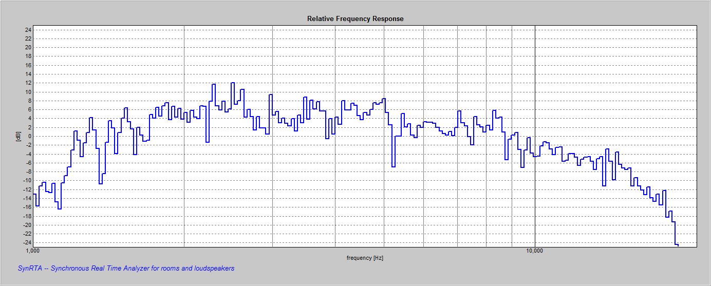

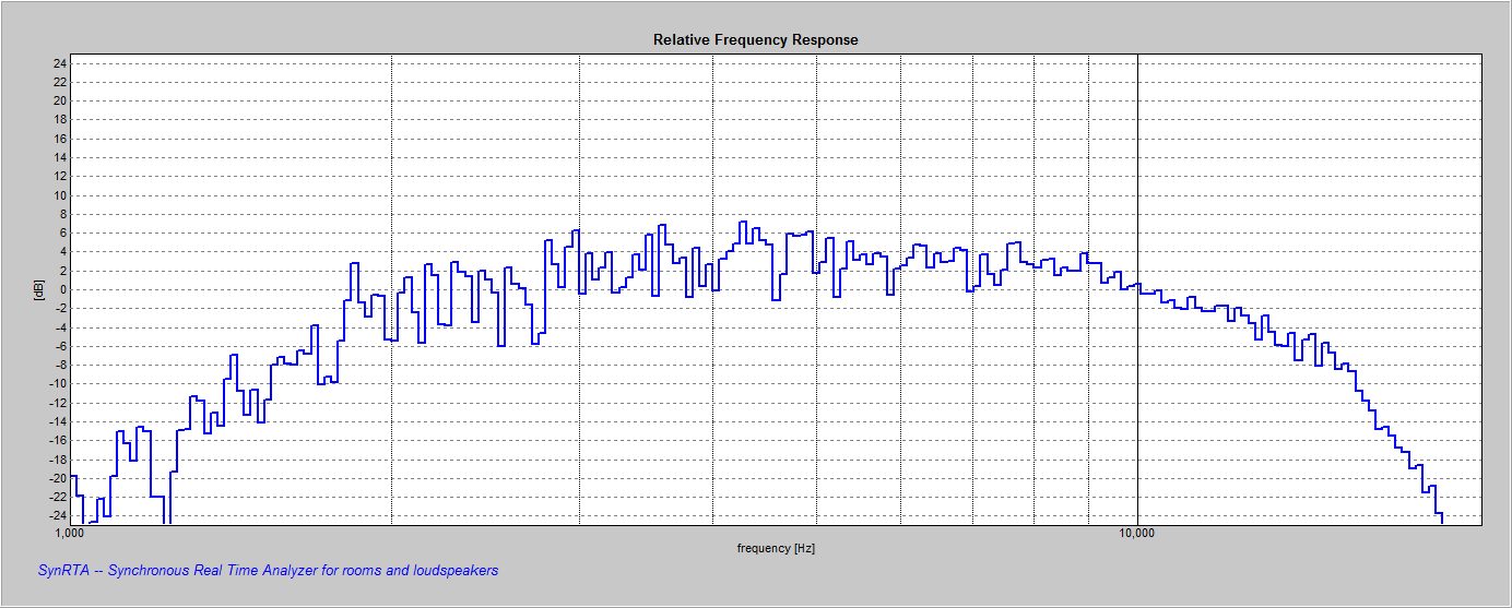

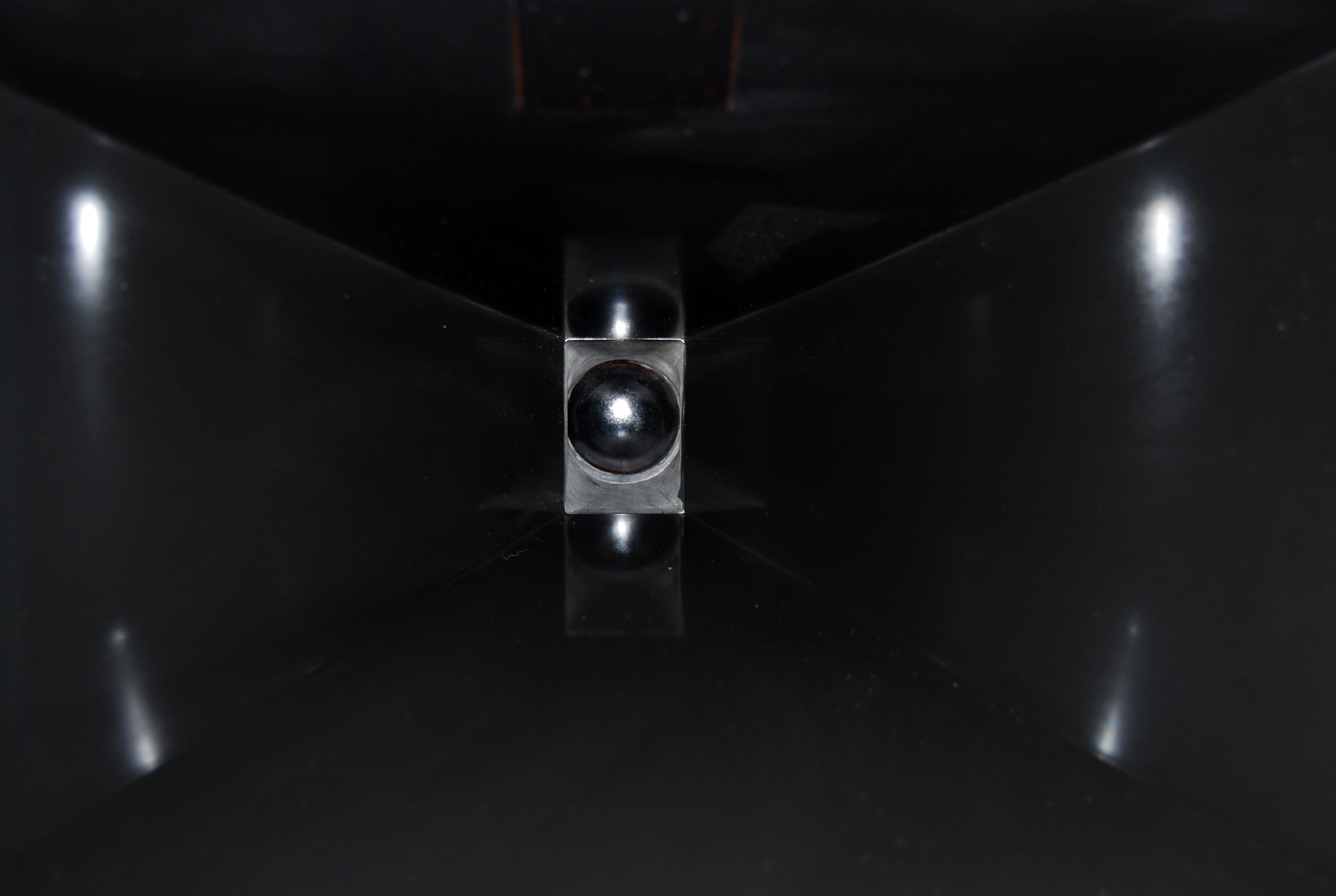

Interesting comparison of Celestion CDX1730 in cheap SEOS 12 horn and the Dayton horn loaded planer. This is measured pink noise at 5 meters in room. The treble drivers are in the horn array and driven with the same voltage. Reflections and all - lol no high pass no eq, 1/48th octave smoothing
Celestion CDX1730 in SEOS12 horn
Dayton PHT1-6 Horn loaded planar
![PlanarHorn5M.jpg PlanarHorn5M.jpg](https://www.diyaudio.com/community/data/attachments/505/505255-b6d55abc26fd0459cc900ae071ace292.jpg)
![1730SEOS5M.jpg 1730SEOS5M.jpg](https://www.diyaudio.com/community/data/attachments/505/505249-8cee8bfcbfc109e0940b9167bd1e6489.jpg)
This is the difference between controlled directivity sound crowd sound and practical in room listening purity.

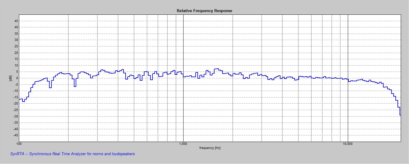

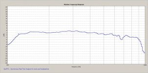

Three horn array with B&C 8pe21 to 600 hz, EV DH1 with aluminum diaphram to 6K and Celestion CDX1425 6K up - 12 feet away in room 1/24 octave smoothing - this sounds super nicemaybe a tad hot on top - until the bass is on than it's "airy" and BIG
How does look under angles?
This is at 4 meters so it includes reflections.

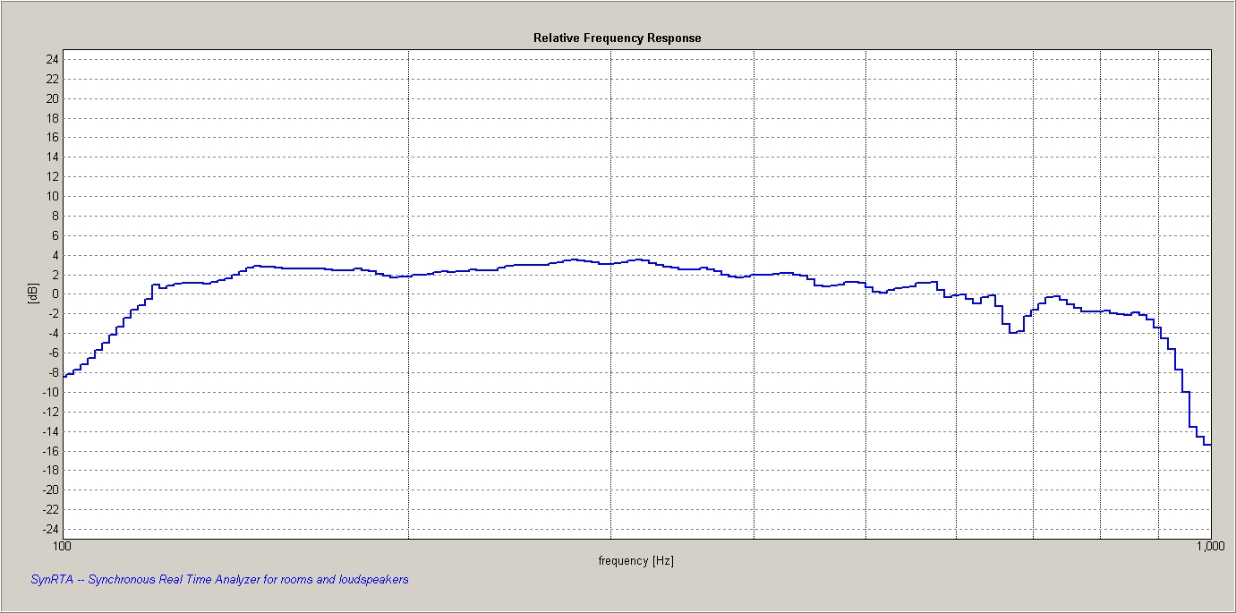

I adjusted the throat of the low mid upper bass horn and am retuning the back chamber. The horns has been elevated 6" and is angled more at listening window. The horns are coupled to side wall and am listening to it full range right now. No treble or upper treble horns being used. I am tuning for best attack and tone. It sounds very nice on it's own and is covering a wide enough range where I find it is morphing into what i seek. When this is where I want it i will bring in the harmonics. It looks like 800-900 cycles first order low pass might be the sweet spot with this. The upper bass is coming in 6db down at 80 cycles to where it is flat 120 to 1K. I am listening with no high pass, just the 8PE21 - the "bass" is really perfect within it's range and it is quite enjoyable. Really "bouncy" and deep dense rich tone of instruments. I don't worry about Xmax because this is tuning out to 108-109 db in room with a watt and the back chamber and throat reluctance keeps it pure and in line. With the high pass at 120 cycles third order a pair will have no problem at 120 db.

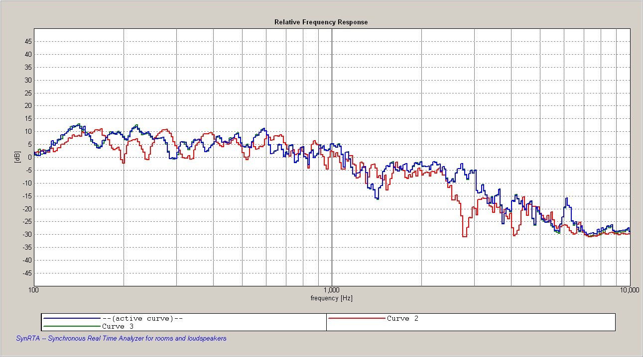

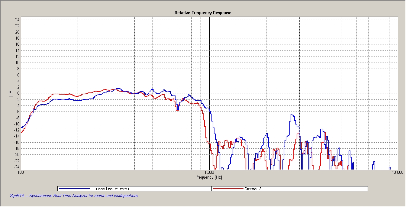

I just won in an auction a pair of new old stock Fane Studio 8M to compare with the B&C 8PE21 - I will get to see if they are as great as some claim. It will be very difficult to beat the B&C. I had an old pair a few years ago (well broken in lol) and used in tractrix horns and didn't care too much for them. With this much longer/larger Hypex I think they will be more at home.
B&C 8PE21 compared to Fand Studio 8m one meter in horn
Here is red B&C and blue Fane. 1 meter from horn mouth no back chamber used 1/48 resolution. The Fane is brand new (1992 NOS) so it might need to loosen up
The B&C 8PE21
In listening to a pair of the fane the measurements don't tell the whole story, there is something here that may or may not be "hifi" but it sure sounds real and alive - lol - need some back chambers and throat tuning to nail it down
![red BC blue Fane.jpg red BC blue Fane.jpg](https://www.diyaudio.com/community/data/attachments/499/499147-3fdbacd2db04630a99db3e0d5bf0784e.jpg)
The B&C 8PE21
![BC 8PE21 48res.jpg BC 8PE21 48res.jpg](https://www.diyaudio.com/community/data/attachments/499/499156-211f6fd39bbd925eeb66ff44c0b3d150.jpg)
