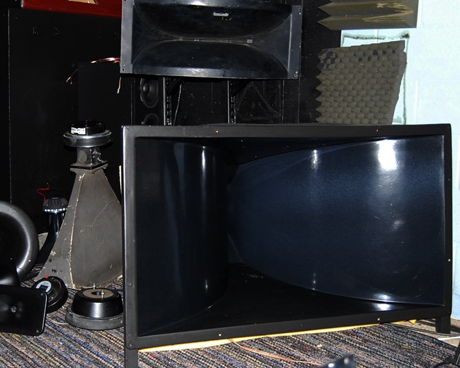

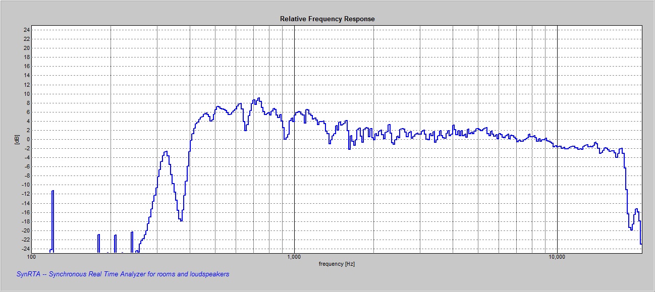

Here I will try to use the new tymphany 40 dollar driver in BIG 220 hz radial. I will listen for a while as 2 way with midbass horn crossed to the radial around 500 cycles (somewhere where it gels)
1/48 smoothing 4 feet

The Tymphany / BRH horn combo matches up real well with 2A3 amps. The Tymphany driver sounds very good. I just wish it were a bit more efficient. It's around 6db less sensitive than the large format driver/horn combo I have been listening to so it marginal with the 45 SET but what this little driver big horn combo offers is a less complicated two way with excellent tone and coherency mated with the 8Pe21 in the midbass horn. Best two way I've had including using TAD, Altec, JBL, hybrid stats, ect.. finding a small format driver that has this range, tone and extension has always been a problem. The TAD 2001 doesn't go this low and can be annoying in the treble, the JBL 242* series has poor response, the celestions are great drivers but only good to 1.5k, the B&C 250 sound is really fake sounding with spitty treble and only good to 1.5k, the Beyma 380 is close but does not offer this type of tone density and detail. Peerless has a winner for 40 bucks.
Keep in mind this is in a large horn for a small format driver and is being used below the manufacture's recommended crossover point.
horn is a community radial , this is a great driver for a 2 way - a smaller horn is fine, just crossover higher. I am pushing the limits here crossing so low. I had the driver in a faital tractrix horn and it really worked well 1200 Hz up. It very well may end up there for me. I am experimenting with this (for like 20 years lol) I have no idea what the exit angle is.
I've got some little radials - sitting out in the elements as ran out of room awhile back - made a good high xover midrange with Symbiotic Altec, ring radiator and 421-8 in a Karlson - patterns were probably weird but subjectively good on vocals - I could not get Edgar's cone driven tractrix to mesh with the K. K-tubes mesh with K.
Jamcam camera quality on a bad day
about 28" back to the bolt on 1" driver throat plate - the Community BRH must be taller - maybe wider than my SFW horns

I really like the vocals and midrange through good radials. to me they have more depth and "image density" than comparable size round tractrix. Plus they load better in the bottom range. Radials can have a sense of ease about them that other horns miss. natural softeness and 3d detail combined as a whole.

Which horn are you using with the M200?
220 Hz 60 by 40 radial horn.
