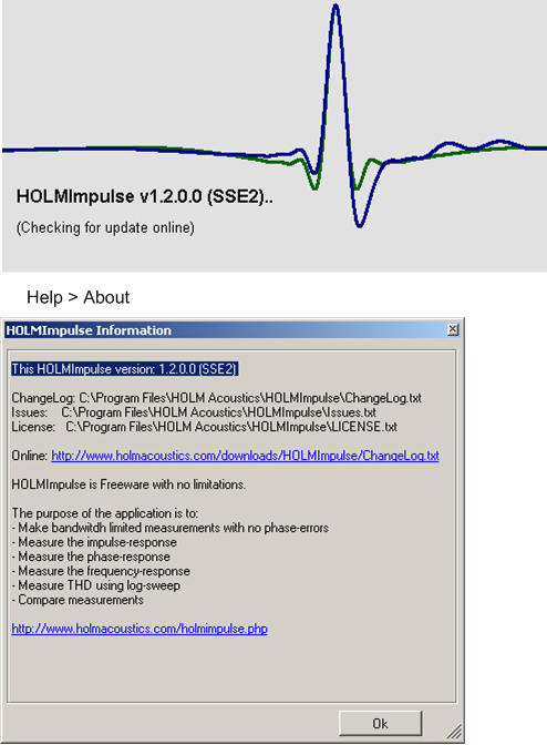

SSE2 or not SSE2
See attachment
If you are not using SSE2 then:
1. Uninstall HOLMImpulse
2. Download and install HOLMImpulse SSE2
3. Next auto upgrade will then upgrade to SSE2-version automatically

Re: SSE2 or not SSE2
Ah Ha! So I was not ussing the SSE2 version. Now I am. =) It kept all my settings, nice. Looks like my no input noise floor is lower, too. And I just see a noise spike at 60Hz, instead of odd places like 110Hz, 224Hz, etc.
Thanks!
askbojesen said:If you are not using SSE2 then:
Thanks!
