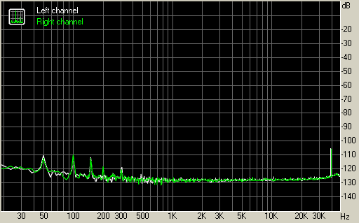

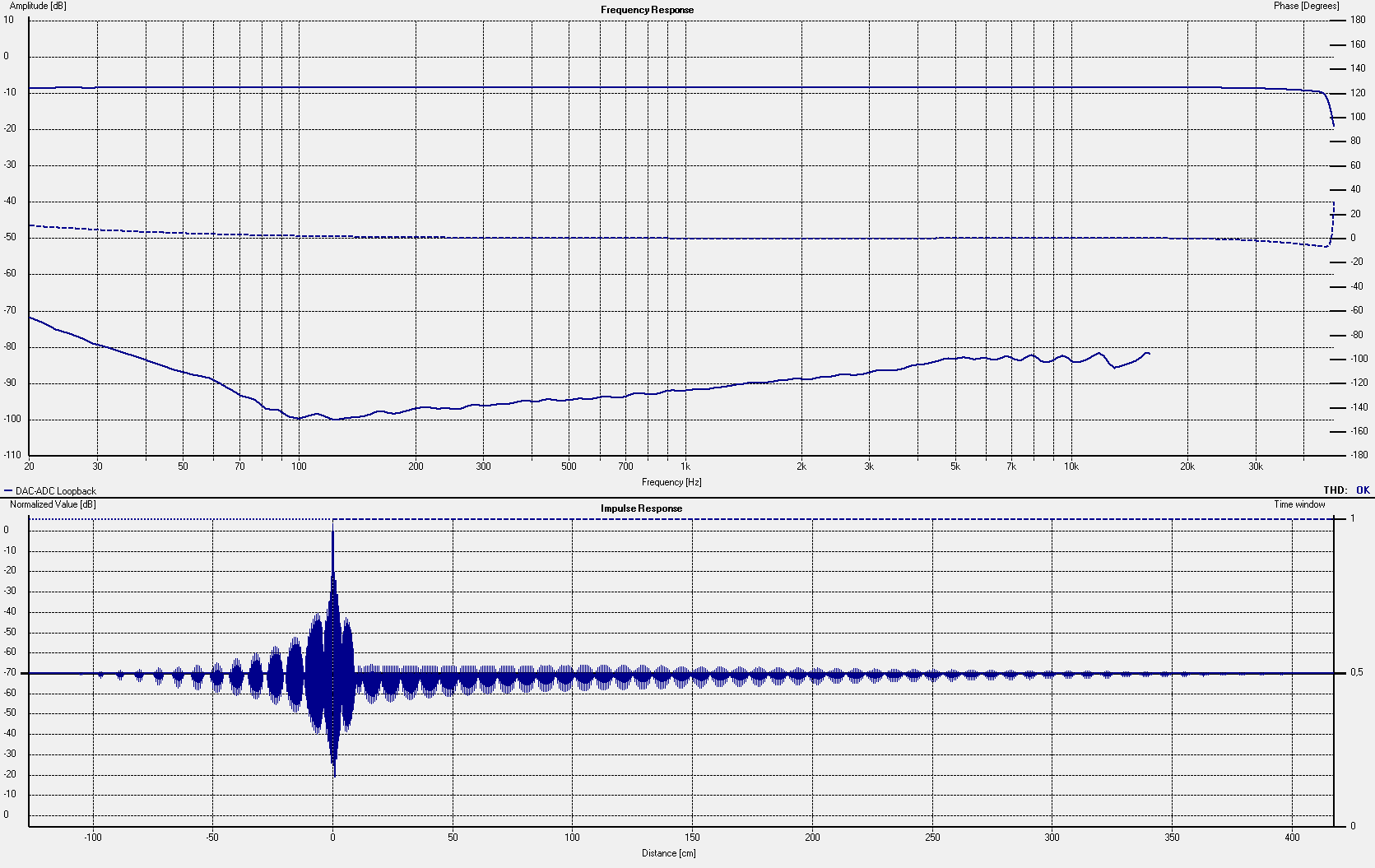

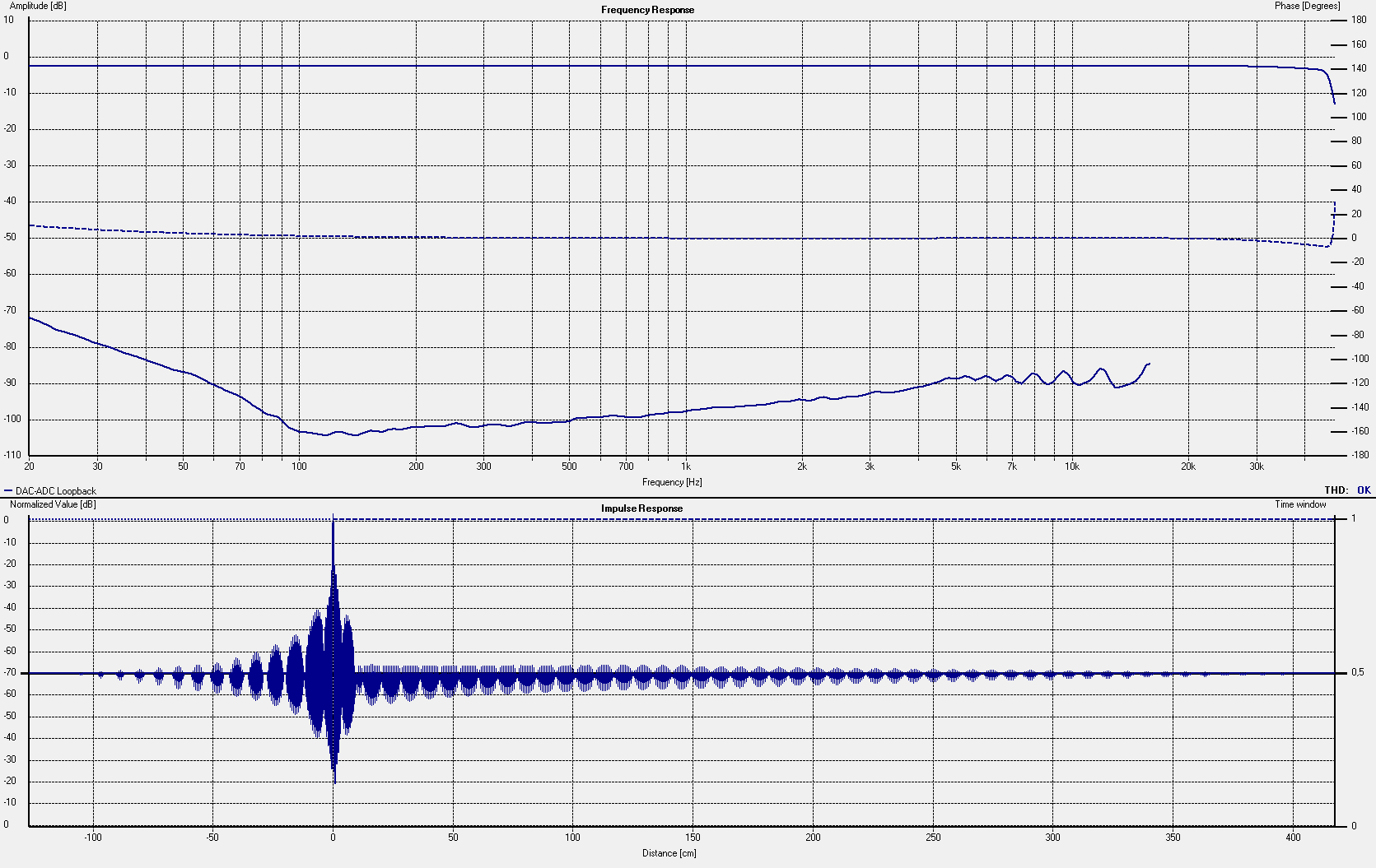

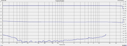

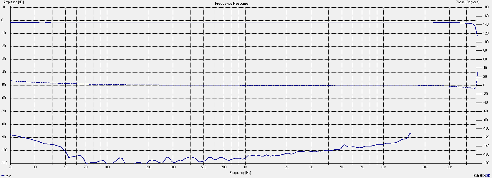

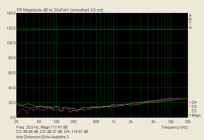

While doing that (and comparing it with ARTA) I found a few strange things I could not explain (all measurements were performed with a loop back cable on an Echo Audiofire 2 sound card, using the MME API) :
- a big difference in reported THD between ARTA and Holmimpulse. I find this strange because I thought both packages used the Farina method, so I would expect similar results also (see att 1 to 3)
- a big difference in reported noise between Rightmark Audio Analyser and Holmimpulse (the numbers reported by the rightmark tool correspond with the specs of my measurement card). This is probably due to the way the noise level is calculated (instead of an actual noise measurement), but I am not sure. (see att 4 to 5)

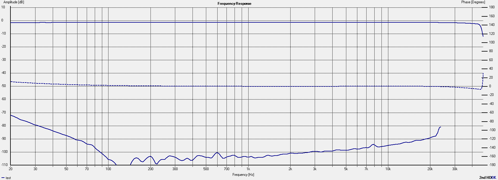

I tried to use ASIO, but my card was not listed when I selected asio. As I do not have any experience with ASIO, it could be a driver problem (when I look at the version information in the console of my sound card, it says asio driver 5.5 installed, but I have no idea if I need to do something extra).
Reinstalled drivers and ASIO works OK now. ASIO perform a little bit better (as reported by other users), but still strong rising of THD below 100Hz.

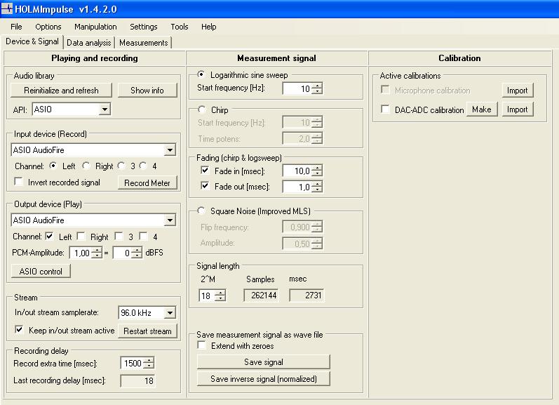

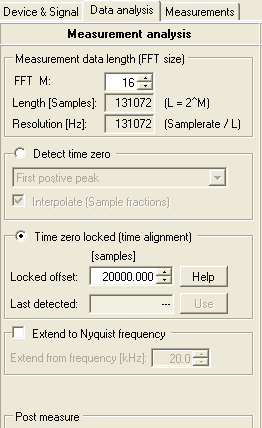

Thanks for your reply. I checked my measurement settings (see attached), and start at 10Hz (default setting I think). Checked also sample rate of my echo card. Is correctly at 96kHz. I included the frequency responce including zoomed impulse in dB. Do not know if this give any more information...

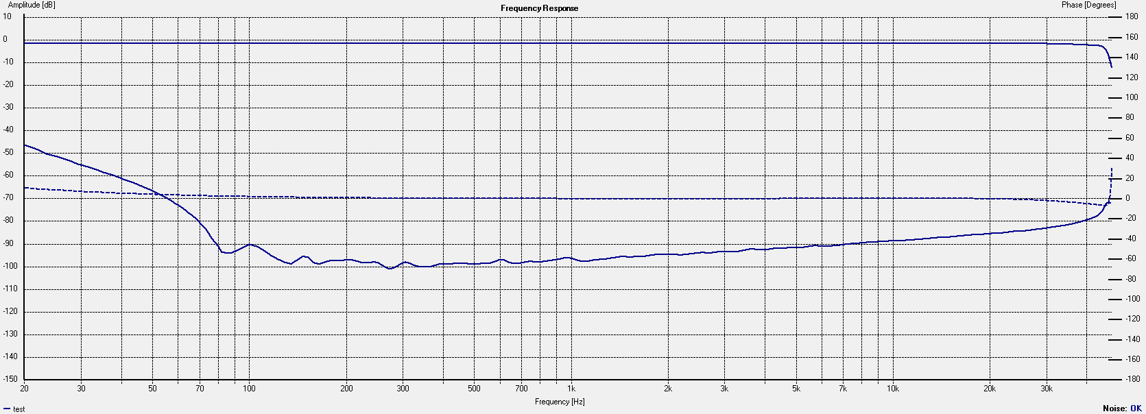

I get identical results over and over again, so I do not think it will be spiking of the OS. I am also using asio drivers now, which should also be much better in this respect.
The measurements in post #186 look very similar to mine. So you could be right on the target that this has happend before. Will look into that tomorrow. Already way to long playing around with this...

Double checked and the THD measurements don't line up with RMAA on my system either. I had suspected they were a little on the high side. Sorry if I made it seem like I was doubting your system _Wim_ I should have double checked on mine first. But also all that stuff I said about windows OSes and getting in the way of audio software is true and seems to go overlooked often.
In your case the fades sort of pre-equalize the stimulus but your inverse cancels that, forcing a flat response. Therefore, during the fades, it is obvious that there are differences in the distortion as the signal level changes, transparent to the process the way you do it. Not regarding the distortion coming from the kink in the waveform with the window you use (which you might have changed in the meantime, I didn't check this).
- Klaus
From the above I conclude that the distortion I measure is a direct consequence from the fade in part of the stimulus. This seems quite logical. When I lower the start frequency (=shifting fade-in part to lower frequencies), the measured THD is also shifted to lower frequencies.
But, lowering fade-in time, enlarging fade-in time (up to 1000ms) and disabling fade-in time does not make any difference at all!? Could it be that some where during one of the software updates the fade-in setting was fixed to a certain set point? Or am I still missing something?
