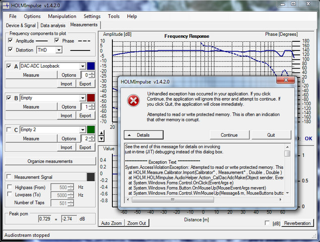

unhandled exception while performing loop-back calibration
Ask, I encountered this exception while performing a loop-back calibration. The repro step for me was to perform the test, clear the measurement, then perform it a second time. I seem to recall that someone else in this thread had the same problem. Exiting the app and performing the calibration again resulted in the same problem. The only way I could successfully rerun the calibration was to reboot my laptop.
JSE v1.6.0_17-b04
OS: Win7 Home Premium (64-bit)
JSE v1.6.0_17-b04

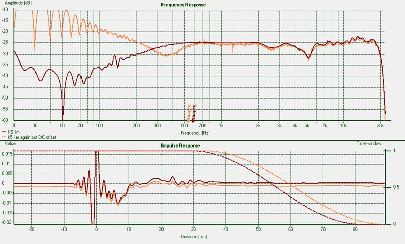

DC offset
I'm having some trouble with my measurements due to DC offset that seems to drift in value.
The attached jpg shows a system measured on two different days. For the second measurement in orange the DC component is enough to give a pretty bad LF response. The impulse can be seen to be way off the zero line and the time gating then turns that into an LF error that obscures much of the system's range.
I remember at KEF we actually measured alternating polarity impulses. The negative polarity ones were subtracted from the positive polarity ones, cancelling out the DC. Can something similar be done here?
I suppose a better quality DAC would help but I love the convenience of plugging a small mic into my Toshiba laptop without any extra boxes.
I did find that the issue is bad with Square Noise and better with the chirp. (Love to know what all the parameters are here).
By the way, I've been using Holm to make a tutorial on crossover design over at the Classic Speakers site.
Crossover mods for the AR4x - The Classic Speaker Pages Discussion Forums
Any ideas?
