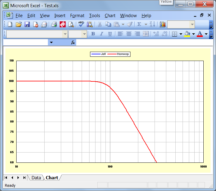

Just confirming that the Hornresp active filter results are identical to those generated using Jeff's polynomial expressions.
To illustrate, the attached screenprint compares the results for a 4th-order Butterworth 100 Hz low-pass filter.
The polynomial method results are exactly masked by the Hornresp results.

One thing that can be difficult to handle for the user is the fact that the "crossover frequency" can have a different definition for the different crossovers. Some of them have the "crossover frequency" defined at -3dB when others use -6dB...
Hi Jean-Michel,
Just to clarify - Hornresp assumes that the filter cutoff frequency is at -3dB for a Butterworth alignment and at -6dB for a Linkwitz-Riley alignment.
