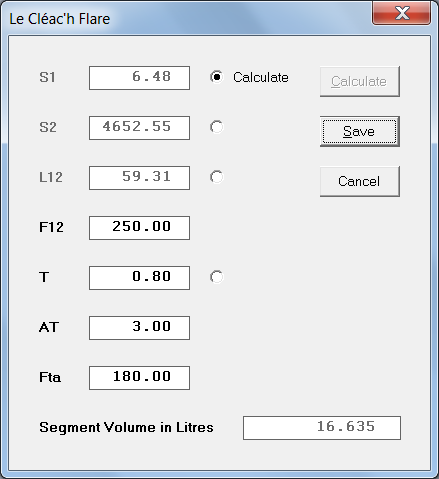

Hi Mårten,
Not sure that I understand .
In Hornresp the horn throat entry half-angle is given by AT, and the horn mouth flare tangent angle by Fta.
To exactly match a compression driver having an included exit angle of 6 degrees, the horn should therefore have an AT value of 3 degrees.
Assuming we want a fully-formed 180 degree mouth Le Cléac'h horn with a cutoff frequency of 250 hertz and a T value of 0.8, to exactly match a compression driver having an exit angle of 6 degrees, the Horn Segment Wizard can be used to find the required S1, S2 and L12 values - see attachment.
Kind regards,
David

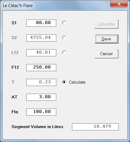

Assuming we want a fully-formed 180 degree mouth Le Cléac'h horn with a cutoff frequency of 250 hertz and a T value of 0.8, to exactly match a compression driver having an exit angle of 6 degrees, the Horn Segment Wizard can be used to find the required S1, S2 and L12 values.
I realised after posting the above that I had probably selected the wrong Horn Segment Wizard option. The input parameters are more likely to be S1, F12, AT and Fta, rather than F12, T, AT and Fta - see new attachment. Note that if S1 is specified then the value of T is fixed. A transition piece could of course being included between the driver and the horn to give a greater degree of freedom in the dimensions.
Kind regards,
David
