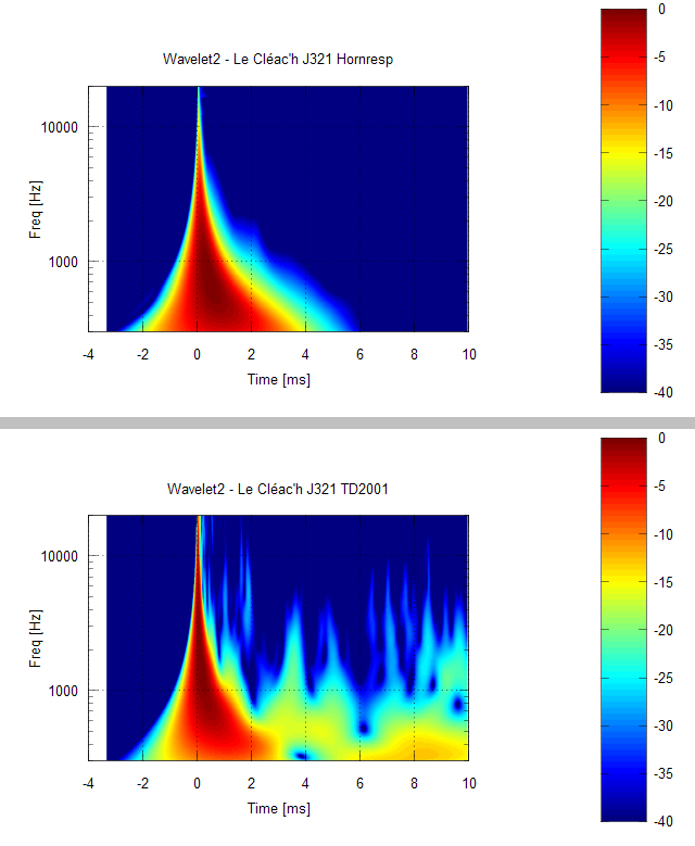

Hello,
Elias did a wavelet analysis in order to compare the Impulse Response calculated using Hornresp and the Impulse Response I used to measure at home on one of my horns (Le Cléac'h, Fc = 320Hz, T = 0.707).
The graph where the 2 are compared is at:
http://www.diyaudio.com/forums/atta...-horn-honk-wanted-le_cleach_j321_wavelet2.png
It is taken from a discussion about horns and honkness, see:
http://www.diyaudio.com/forums/multi-way/161627-horn-honk-wanted-19.html#post2118791
Best regards from Paris, France
Jean-Michel Le Cléac'h

Hi Jean-Michel,
Thanks for the comparison, and for the link. The "Horn Honk" thread is very interesting indeed!
Kind regards,
David
