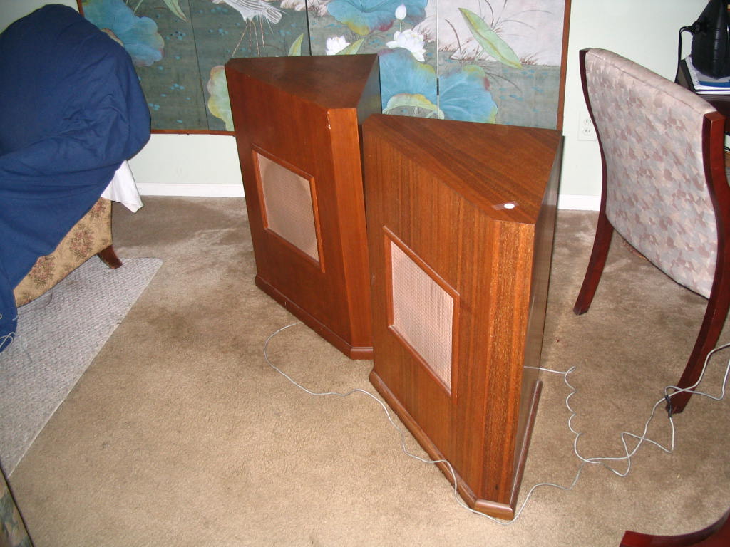

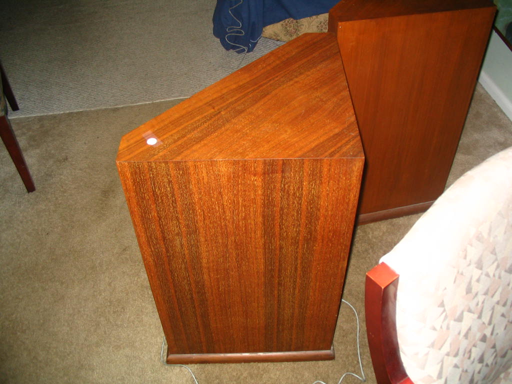

I've got two corner cabs that are 1.5" thick plywood built in the 50's loaded with 12" Martin Logan subwoofer drivers. Each cab has a BASH 300 plate amp on it. Those sit in the corners behind my main speakers. Then I have 2 KLH HT subs in the back corners just to smooth the sub signal throughout the room. Here are pix of the subs. At some point in time, I will refinish them to match my main speakers.

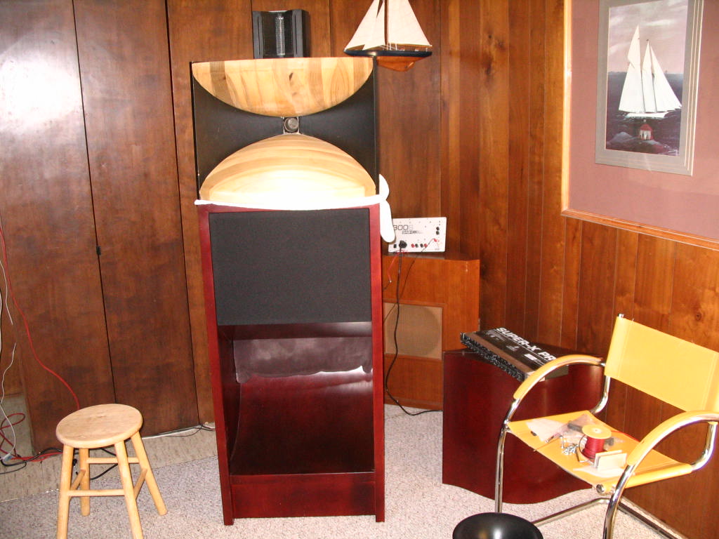

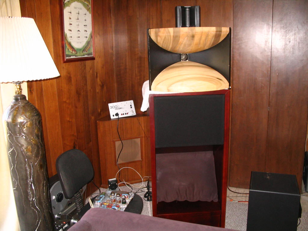

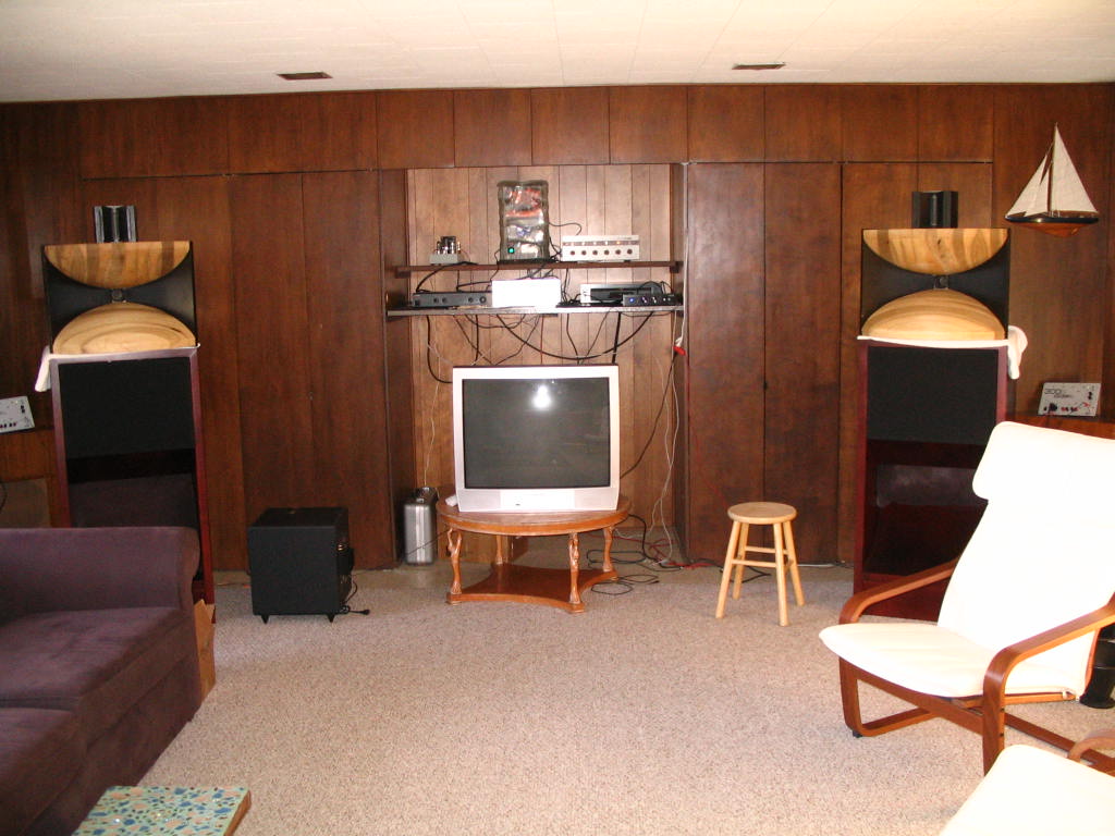

Here is pix of my speakers now. The JBL scoops just don't sound very clean. I think it is the front wave hitting the back wave that messes the sound up. They sound much better when I stuff the back horn with sofa cusions. They are also WAY too tall. So I will keep the Heil tweets, my mid horns, and the subs.

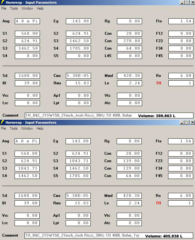

Hi David,
I think I may have found a minor bug, or rounding error: when looking at a TH designed by Josh Ricci I changed the simulation from 3 to 4 segments by splitting the area difference, and dividing the length in 2. It seems to me, that for a conical horn the volume should not have changed.
Please, take a look at the attached picture.

When looking at a TH designed by Josh Ricci I changed the simulation from 3 to 4 segments by splitting the area difference, and dividing the length in 2. It seems to me, that for a conical horn the volume should not have changed.
Hi Oliver,
To split a conical segment into two equal-length sub-segments, the radius average rather than the area average should be used to determine the midpoint cross-sectional area. This means that the value for S3 in your 4 segment tapped horn example becomes 999.85 sq cm, not 1043.71 sq cm.
Using S3 = 999.85 sq cm, the volume of the 4 segment horn is identical to that for the 3 segment horn, as expected.
Kind regards,
David

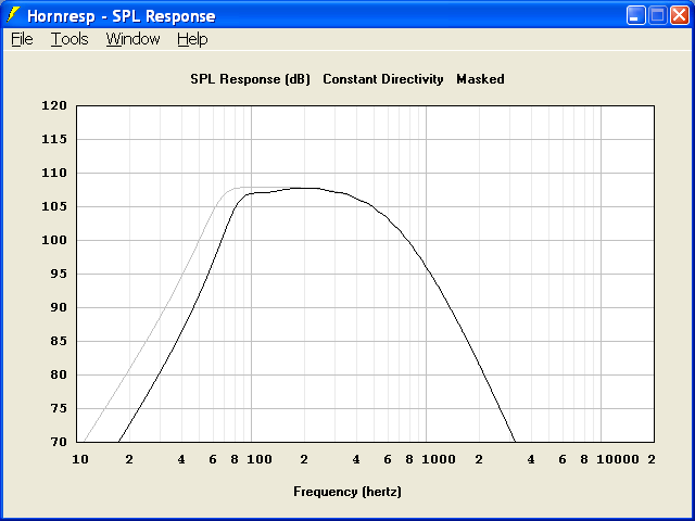

I found some odd behavior.
Using different mouth sizes on a Le Cléach horn I found that a very small change in size resulted in a dramatic change in response. Like a step happened.
Maybe some sort of rounding error?
The speed of the calculation seemed to change as well.
Also when bending the horn back 180* you seem to pick up a tremendous bass boost. Is this really true?
  • lec1.txt
  • lec2.txt
Hi David_Web,
The Lec1 horn is simulated using an isophase wavefront model and the Lec2 horn is simulated using a plane wavefront model. This is why the results are different. Hornresp automatically selects the model to use based on the input parameter values. It just so happens in this case that you have identified the cross-over point from one model to the other.

Which one would be more accurate? Lec1 or 2?
Also decreasing a Le Cléach horns mouth doesn't seem to have too bad influence in a mid horn. Would this be an ok compromise in regards to SQ?
