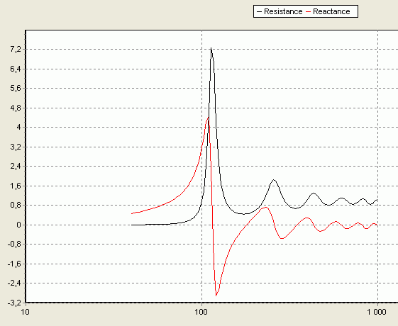

Which one would be more accurate? Lec1 or 2?
I ran a simulation in BEM (which solves the wave equation by numerical integration), I attach the results. They show the throat impedance and power response of the system. Two things are evident:
- Lec2 seems to be closest to the more accurate BEM simulation
- Hornresp results are amazingly close to the BEM results.
Unfortunately I can't simulate a 180 deg. LeCleac'h horn in an infinite baffle (2Pi), so I can't comment on how well Lec4 holds up against BEM.
The problem with Lec3 vs. Lec4 may be the 2Pi termination, but maybe David has more thoughs on this.
Bjørn

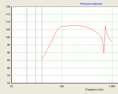

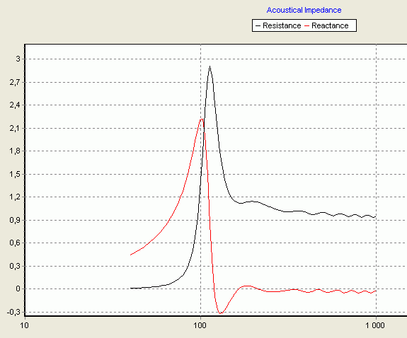

For your interest, here are the plots for throat impedance and SPL power response for Lec3. Again Hornresp is very close.
The dip in the response, visible in both the SPL power response plots, comes from rear and front chamber resonances. They also appear in Hornresp, if masking is turned off. That they are so similar, is because I use the same rear chamber model in the BEM program as Hornresp uses.
Bjørn
Bjørn

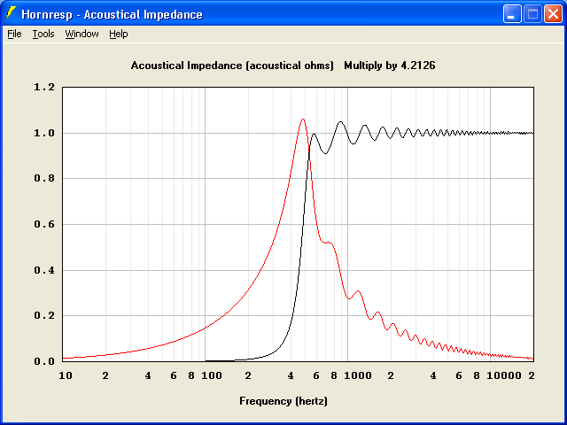

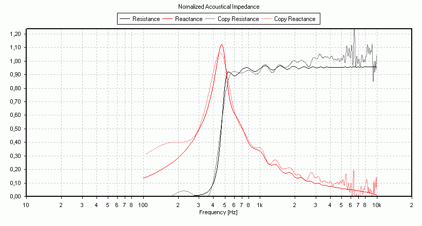

Hi David_Web,
One thing that I forgot to mention in my earlier message:
If hyperbolic-exponential flares are used for Lec1 and Lec2 (which would most likely be the case in practice) then the results predicted by Hornresp for the two horns are effectively identical. There is no longer a cross-over point issue.
The attached screenprints show:
* The throat acoustical impedance of a Le Cléac'h horn having a mouth flare tangent angle of 120 degrees, as predicted and measured by Bjørn.
* The throat acoustical impedance for the same horn, as predicted by Hornresp.
A comparison of the results would seem to suggest that the Hornresp model is valid for Le Cléac'h horns having mouth angles up to 120 degrees, at least.
Kind regards,
David
