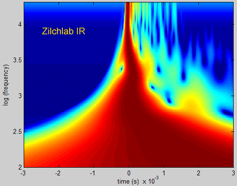

Hello,
If there is some interest for that, I can eventually adapt my quasi-wavelets Matlab routine to be used in Hornresp.
You can see an example of quasi wavelets graph at
http://www.diyaudio.com/forums/attachments/multi-way/167266d1271433163-horn-honk-wanted-zilch_a.gif
from my post:
http://www.diyaudio.com/forums/multi-way/161627-horn-honk-wanted-66.html#post2155843
Best regards from Paris, France
Jean-Michel Le Cléac'h
