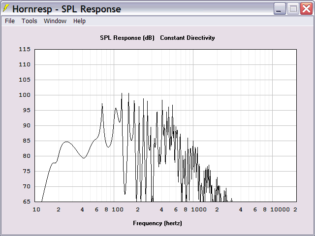

I periodically have gotten some discrepancies between regular plots and those in the Wizard, but finally got around to loading V26.40 and the first old design I loaded to copy showed a doozy of a response plot error, though from memory the Wizard one looks OK:

I periodically have gotten some discrepancies between regular plots and those in the Wizard..........

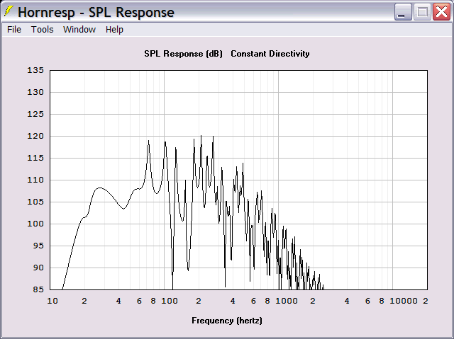

Hmm, went back and looked at this again and noticed Rg = 3.4 (no idea how this happened or why I would have inputted such), but the Wizard displays the proper Rg = 0.1. Changing the input screen to Rg = 0.1 calculated a different plot, but not the one I remember, though at least now the Wizard's plot mirrors it close enough. Still, the fact that it's so different from the previous Wizard plot implies that all's not right in Bitsville.
GM
OK, in playing around a bit more, adding series R makes a mess of the response plot and when I fix it in the Wizard and save it, it's still a mess in the main response plot window.
Hi GM,
Many thanks for the detailed description of the problem. I will investigate and let you know when it is fixed - the update I intended releasing today will be held back until then.
The thing that really has me puzzled is how the Wizard could show Rg = 0.10 when the main input parameters screen shows Rg = 3.40. When the Wizard is opened, it should simply copy in the values from the main screen.

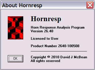

You're welcome, for sure it got my attention once I noticed it! Anyway, I noticed I was one revision behind, so installed it just now and it seems OK, so I guess my copy got corrupted somehow along the way.
Then again, I added/saved a new record from yesterday's bad one to experiment with and when I re-calc'd it just now, it's still wrong, though in the Wizard it shows both Rg = 3.4 and AFAIK the correct plot! So not sure if I should just delete it and assume the program's OK or has it still got a problem?

Hi GM,
There is no need for you to delete your record. As of yesterday, the program still had a problem.
However - the bug you reported, and the error I found earlier in the combined response for a compound horn with a throat adaptor, have now both been fixed.
Thanks again for your valuable feedback - identifying the cause of the problem for me (non-zero Rg) made things just that much easier.
The latest Hornresp release is Product Number 2640-100512. Hopefully everything should work fine now
Please let me know if you come across any other problems / anomalies.
