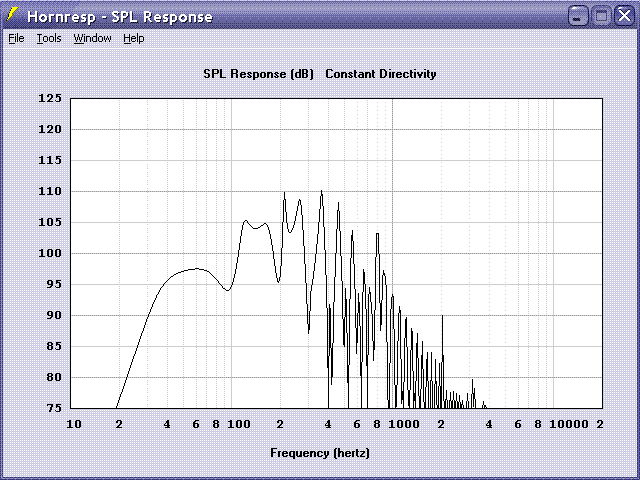

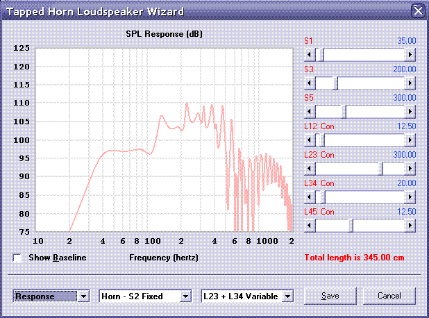

Hi, Everyone.
It's rather difficult to read 116 pages, so, please, point me to answer if my problem is already solved.
I'm modelling Tapped Horn in Hornresp 26.30. A problem is that SPL responces, displayed in standard "SPL Response" window and in "Loudspeaker wizard" - "SPL Response" window are different. Any changes are made in second case. Simply pressed Ctrl+E in "Input parameters" and selected "Response" from corresponding dropdown list. See screenshots attached.
Hi, Everyone.
It's rather difficult to read 116 pages, so sorry, if my problem is already solved, and point me, please, to post with solution.
I'm modelling Tapped Horn in Hornresp 26.30. Problem is that responses in main "SPL Response" window and "Loudspeaker Wizard" - "Response" window are different. In second case any changes made in wizard window. I simply pressed CTRL+E in "Input parameters" and selected "Response" from corresponding dropdown list. Screenshots are attached.
So, questions are: "Why?" and "Which response is correct?"
