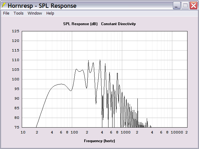

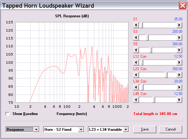

Problem is that responses in main "SPL Response" window and "Loudspeaker Wizard" - "Response" window are different.
Hi The Lamer,
Thanks for this - you have discovered yet another bug (different to the one found recently by GM).
I will let you know when it is fixed.
Kind regards,
David

OK, you've piqued my interest as to what's still causing a glitch since when I simmed his design with 26.40-100514 the Wizard plot matches the main FR plot, so it seemed reasonable to assume that it was fixed:
Hi GM,
Try this:
Exit Hornresp and then re-open
Find the example test record
Click the Edit button
Open the Loudspeaker Wizard tool
Select Response
You should see the erroneous SPL result (Hornresp assumes Atc = 0 when it should be 202).
You must have selected the Chamber input option at some stage - this sets Atc = 202 and corrects the problem
The bug will be fixed in the next release.

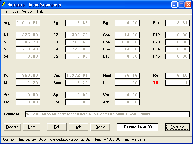

Pmax and Xmax parameter values can now be saved as part of the data record by pressing Ctrl+S when the Maximum SPL tool is being used (see Attachment 1).
Please note:
* All existing records in the Hornresp.dat data file will be automatically updated to include fields for the Pmax and Xmax parameters. The two new fields will be initially auto-populated with values of 100 watts and 5.0 mm respectively. These default values can then be changed by the user when actual Pmax and Xmax values for a particular driver are known.
* Moving the mouse pointer over the Input Parameters window Comment field will display the Pmax and Xmax values for the current record in the status bar panel at the bottom of the window (see Attachment 2).
* The Pmax and Xmax values for default record number 1 cannot be changed from 100 watts and 5.0 mm.
* When driver parameter values are copied from one record and pasted to another, the associated Pmax and Xmax values will also be transferred.

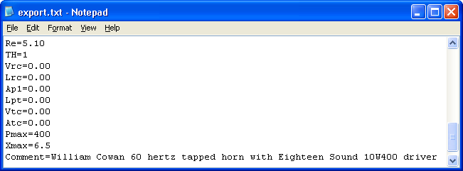

* The Pmax and Xmax values will be included in exported Hornresp record files (see Attachment 3).
The Tapped Horn Wizard tool bug found recently by 'The Lamer', has also now been fixed.
