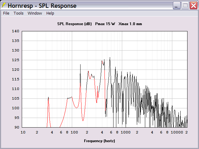

Greets part deux!
It does?
Also, I clicked on L34 of a TH sim to change it and it gave me an error and shut down when I clicked on it. Tried on several sims with the same results. Ditto in the Wizard.

Hi GM,
I should have been more careful with my wording :). What I meant to say was that the Y-axis auto-ranging ensures that the maximum plotted value does not disappear off the top of the chart.
The bug you have found is an interesting one. It only occurs for me when I double-click on an input box containing a decimal point but no numbers. The difficulty I have is that the program works fine in development mode (where I can usually track down the cause of such errors). It seems that it is only in the compiled executable version that the problem occurs. I will need to investigate further - it may be a bug in Visual Basic itself...
Hi GM,
Just letting you know that I have found a way of preventing the above fatal error from occurring in the compiled executable version of Hornresp. The fact that the problem only arose while using the L23, L34 and L45/L56 input boxes enabled me to isolate the offending section of code, and trap the error.
The bug will be fixed in Version 27.00, due for release sometime next week. Many thanks for bringing this very interesting and quite serious problem to my attention!
