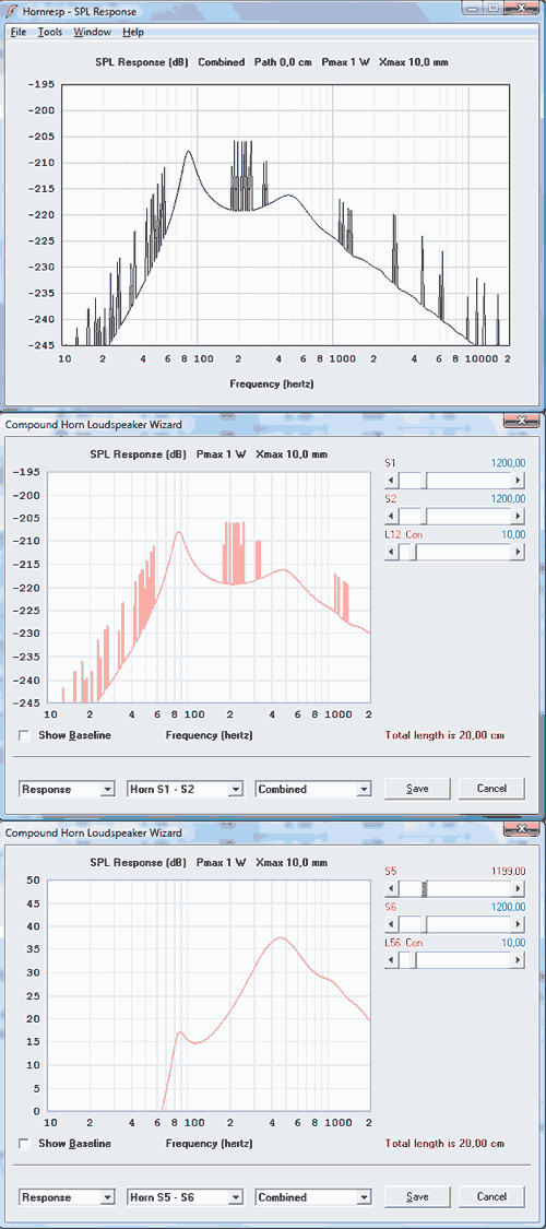

Getting some strange result in the loudspeaker wizard with this one using combined response.
Hi David_Web,
Many thanks for this feedback - I get an incorrect result also.
I will investigate and let you know when the bug is fixed.

Dear Mr. McBean:
It seems there is another bug in the Compound Horn feature. Using the Mige0 values, the results are improper, with other drivers and parameters the same effect occurs. Any even smallest change in the values S1, S2, L12, S5, S6 or L56 changes drastically the response plot.
The OS is Vista 64-bit.
