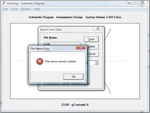

Dear Mr McBean:
There is a problem with exporting data from hornresp at Schematic diagram / export horn data / horn cross-section dimensions on option other than Con (Exp and Uni).
Hi witasso,
Thanks for the feedback. I have not been able to generate the error message you are seeing - the functionality works fine for me. Could you please post a screenprint of your Input Parameters window so that I can conduct some further tests using the same data as you.

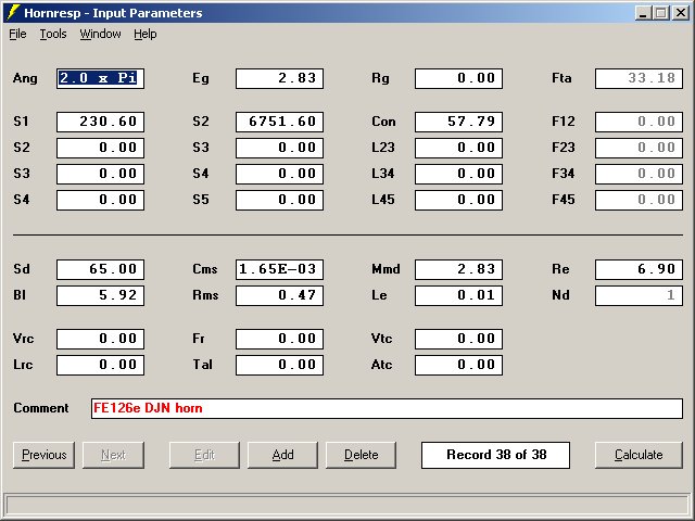

Hi All, I am here asking for help...nay, begging for help. I have a new pair of speakers that are neither fish nor fowl. I have some ideas of what direction to take them but I am just plain stupid when it comes to computer programs and in particular Hornresp.
Here are pix of the speakers. They are large horns with a Fostex FE126e driver in them. They run full range with the Alpha 15a woofs in "H" frames. They actually sound very nice. Open, detailed, live, but from 200hz (where the 126e kicks in) to around 3.5khz the signal is much lower in volume than above 3.5khz, where it REALLY kicks in.
I don't know is this is a result of the horn design or the driver. I do know the 126e has a fairly substantial peak in the higher freqs.
My options are to find a better, flatter driver like the Mark Audio Alpair7, or, turn these into true midbass horns by whacking the back plate off and putting a 10 or 12 or 15" driver back there with the proper compression ratio.
Before I do that though, I figure I show know what these will do as a horn modeled in HornResp.
They are conical flairs with open baffle
The mouth is 22.75" wide by 46" tall.
They are 22.75" straight line deep
The throat (without the back plate) is 6.5" wide by 5.5" tall.
I know this is a subwoofer forum, but can one of fine gentleman help me figure out what to do with these. Thanks in advance......much appreciated.

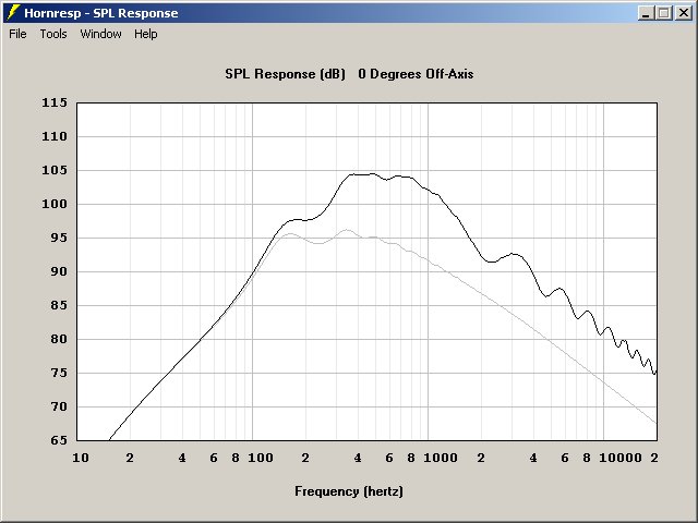

I did a quick model in hornresp, and it looks like you should get strong response from ~1kHz down to 300Hz on axis with the highs rolling off. Since this is not matching the results you're getting, I'd say the issue is the high frequency response of the speaker. I attached screen shots. The dark curve is on-axis, the lighter lower curve is constant directivity (power response).
I'd try applying eq and seeing if you can get the tonal balance to be what you want before you start swapping drivers. I'm not saying that is a final solution, but if you can't get the tonal balance right with this horn and this size driver in it, changing drivers won't make a big difference - they'd just change the eq you needed to apply to get to a given frequency response curve.
Edit - to expand on that a bit, if you can't get the horn to sound right tonally as is with eq, that could be because of the polar pattern. So if you change the driver for a new one that's the same size, then you won't be likely to change the polar pattern very much and thus the issue won't go away. What would more likely change is the frequency response without eq. Thus my suggestion to try the eq first. If the system sounds tonally right with the eq but you don't want to have the eq in there, then you could look for a different driver.

Thanks John. Yep, I am not hearing that plot at all. Almost like the reverse of it. I agree with your assesment that if the geometry is bad, then a great driver will not make a difference.
I don't know if you can do this or I should say, if HR can do this, but if I used the 6.5" x 5.6" back (removed) then stuck a 12" (or what ever size driver would make a 2:1 compression ration) on the back with a back chamber would it work as a midbass horn better than full range OB/horn.
Thanks again.....that reverse of what I am hearing plot stumps me.
Edit: I wonder if I put a back chamber around the driver if it would change things much.
Hornresp doesn't account for cone breakup, so it's not completely unexpected that the results don't match exactly in cases like this. However typically you use a horn like this to bring up the low end of a fullrange driver to match the higher level of the cone breakup, so it's weird that you aren't hearing that to some extent.
I suppose it depends on your definition of midbass, but I doubt you'd get it to go any lower than it does now. So it could potentially be a lower midrange horn with another driver but I'll leave that modeling to someone else.

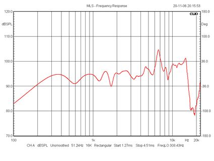

Thanks for your thoughts GM. Yep, it is that peak and the general rise after 3.5khz that is the problem. The more I work with this horn, again, that I like very much, the more I think that I need to 1. find a driver that is more suited for this app or 2. figure out a step down for 3.5khz and above, or 3. whack off the back of the horns, attach a 12" woof and call it a true midbass horn. I have a number of tractrix horns that will so up from 600 - 800hz on up.

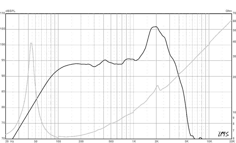

One more thing, When you said "shelve" do you mean some kind of network that would bring down the highs? Something like a reverse CD comp network for Wave Guide horns?
