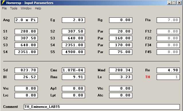

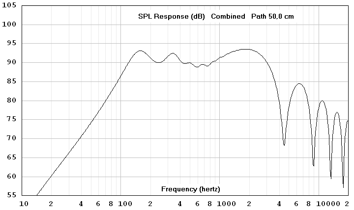

Hello,
For sure a part of the peak could be due to the loudspeakers but as I can see on you pictures (for any reason I cannot enlarge them), the loudspeaker is used as a dipole and thus, there is an interference between the rear wave and the front wave.
Here attached the combined response (front + rear waves) as calculated by Hornresp.

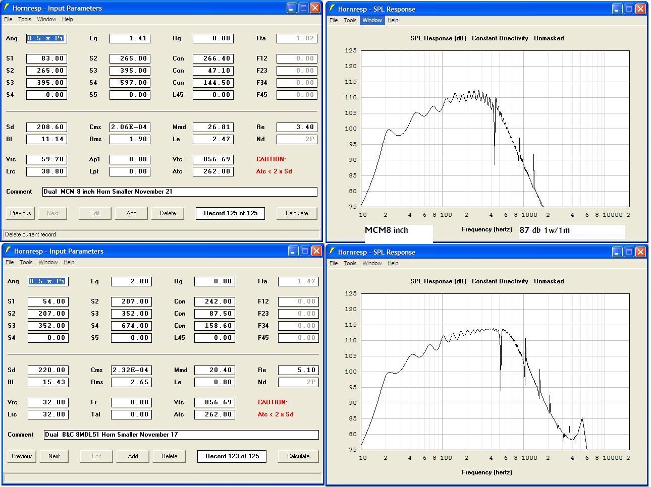

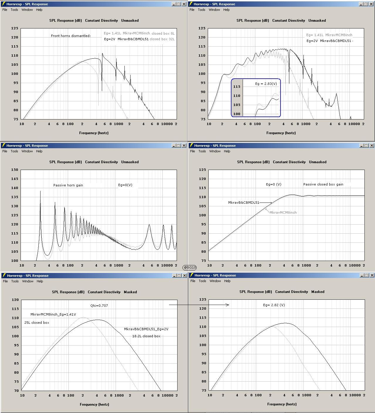

Houston I think we have a Problem
I have been recently working on a car subhorn design. The falling response is to complement the rising response in a car environment. Pretty close to the transfer function found in my vehicle.
The figures calculated for the B&C set of drivers seem to make sense as they are a baseline efficiency of 97db/m
The figures for the MCM drivers have me wondering what is going on. I have a driver with a baseline efficiency of 87db. And the resulting 1 watt SPL in Hornresp is almost the same. A horn cannot come up with 20 db of gain.
Or I'm really missing something stupidly simple.
So if it's me I'm all ears. If it is the calculations then ....

Hi Mark,
Your MCM example shows two drivers connected in parallel, horn-loaded with a compression ratio of 5.03 : 1 and propagating into eighth-space via a relatively long, very low flaring rate horn - operating conditions quite different to those under which the 87dB single-driver "baseline efficiency" figure would have been obtained. The Hornresp results seem quite reasonable to me
I think that in this case you might be asking just a little too much
. Building a useful (and robust) horn fold engine would be a rather challenging task, I expect.

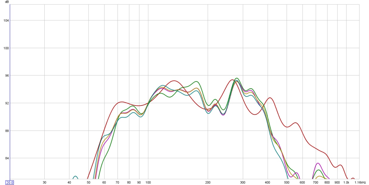

I have been working on some recent designs. I thought that the following would be a good assurance of your programming abilities.
Measured by a colleague of mine :
The red line is the simulation the other lines are live measurements taken indoors 18 inches off of the floor swept sine wave. Not gated.
Mark
