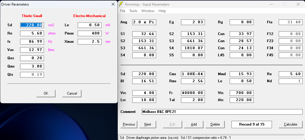

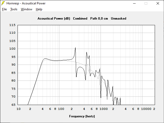

Hi! Im new to hornresp and not very good in mathematics or speaker theory in general, so pleasy forgive me, but im trying to learn
I am going to build the Inlow 135hz Horn, and in time some conical horns for double 15incc drivers. This is my rig today:
but I have decided to try out conical midbasshorns, 15inch for 80hz-250hzish, and 8inch in inlowhorns for 250hz-600hz. I want to see if this can give more detailed male vocal pronouncement than 15inch alone. Im considering several options:
But for now im trying to simulate the 135hz Inlowhorns in hornresp to understand what parameters are good, and whats not.
I think this is fairly correct😬 Inlow135 with B&C8PE21
Now, the question:
1) Is Acustical impedencepeaks up to 1.6 and down to 0.4 in the midle of the work area considered good and yield good results?
2) How much electrical impedence in the workarea for the driver is tolarated/reasonable to expect in this case?
3) In my case the speakers are placed in the corner of the room, is it then more correct to use 1.0xPi settings?

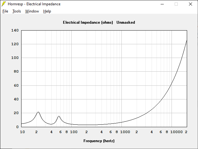

Was the net box volume (including vent volume) the same for both models?With two identical tuned vents with different surface area (in the attached example 37,5cm² and 150cm² on a 10" speaker) on a bassreflex enclosure, all other parameters (including QL) being identical, in the small signal domain (2,83V in this case), Hornresp shows different sensitivities (only talking about the frequency area of the Helmholtz resonator, not the port's own resonances) for the two vents, with the larger vent being louder.
I think that the standard vented box calcs assume that the volume of air in the vent is much smaller than the net volume of air in the box. This assumption breaks down as the volume of the vent passes about 10% of the volume of air in the box. At about that point the shape of the box and the length and volume of the vent can affect final Fb, which can tend to be lower than expected if it was calculated using the typical vent length equation. We'd looked at that effect a few pages back in this thread.
Anyway, I was curious to see if we were just seeing the Iron Law in action. The total volume of a box with a given Vb but larger vent would be larger than that of a box with the same Fb but smaller vent.

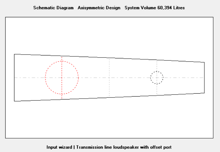

I have a question.

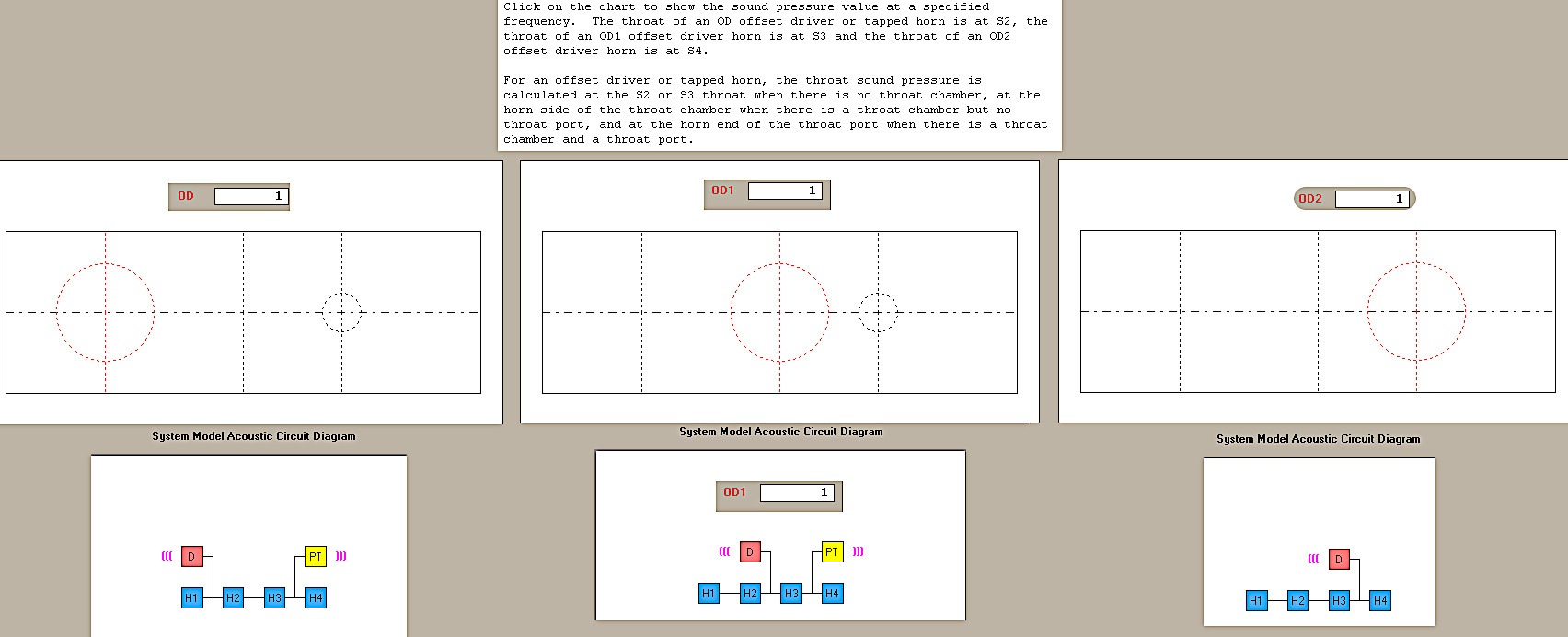

Is there a way to change the offset of the driver between different segments for a slot loaded closed transmission line with a offset driver as well as a offset port?
Like this;
By default this is always between S1 and S2
One might think to change that with the loudspeaker configuration menu.
But as soon as I do that, it's not the same system anymore.
In fact, and this might be a bug (?), but there is no way of getting this system back anymore at all?
Fb was the same for both boxes, as you can see in the comparison of the impedance curves I posted. It's hard to see the graph includes both curves, since they practically lie over each other.

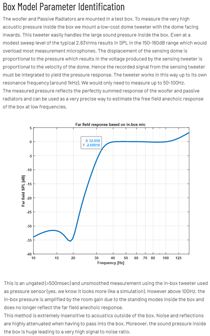

Not sure if you keep up with the Purifi Blog posts, but they recently posted measurements of a passive radiator enclosure using this technique with a dome tweeter as the "microphone".
https://purifi-audio.com/blog/tech-notes-1/spk16-reference-design-12
Attached is an excerpt of the relevant sections.
The method including use of dome tweeter to directly measure volume velocity was published in AES article by Richard Small in 1972
AES E-Library Simplified Loudspeaker Measurements at Low Frequencies

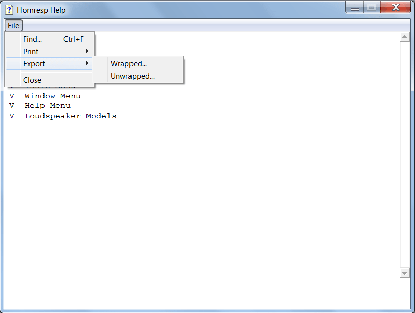

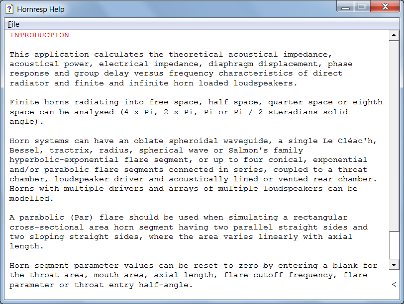

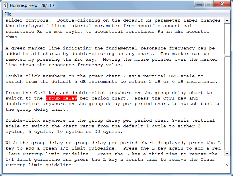

Hornresp Update 5610-240603
Hi Everyone,
CHANGE 1
The following cosmetic changes have been made to the Hornresp Help file:
a. The Contents highlight bar now has a red backcolour and white forecolour as shown in Attachment 1. (Previously the highlight bar was light green and black).
b. Section headings are now red, as shown in Attachment 2. (Previously the headings were black).
c. Search text found using the Find tool is now highlighted in red and white as shown in Attachment 3. (Previously the highlight colours were light blue and white).
CHANGE 2
The Hornresp Help file can now be exported with the contents either Wrapped or Unwrapped. The wrapped file has a format similar to that of the document shown in the Help window, and cannot be readily altered. The unwrapped file has a format that can be modified by the user if required. Attachment 4 refers.

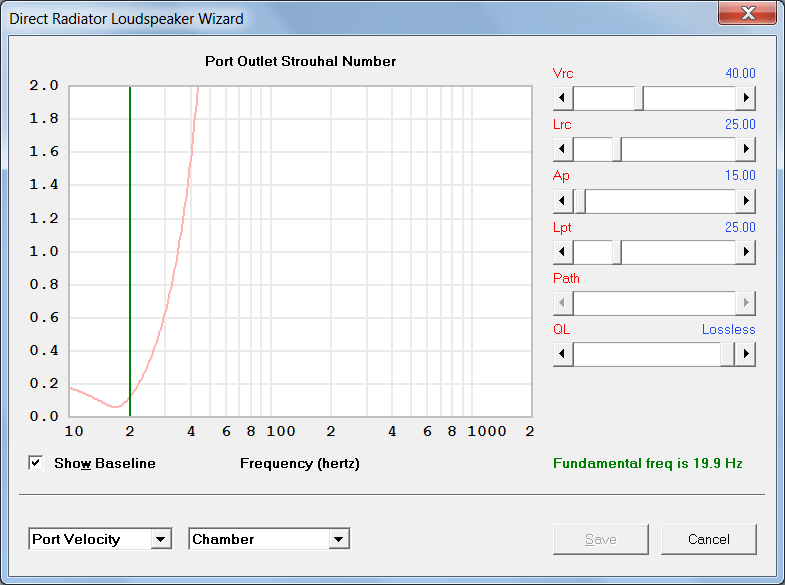

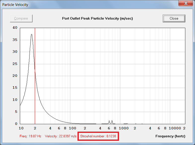

Double-clicking on the loudspeaker wizard port outlet velocity chart with the Ctrl key pressed now switches to a chart showing the Strouhal number vs frequency. Double-clicking again switches back to the port outlet velocity chart. Attachment 5 refers.
The Strouhal number is now also shown when port outlet particle velocity chart results are sampled. Attachment 6 refers.
See the thread linked below for background information. For further specific details on the Hornresp Strouhal number feature, search for the text string stro (the minimum required) using the Help File > Find tool.
https://www.diyaudio.com/community/...d-port-geometries.388264/page-30#post-7697621

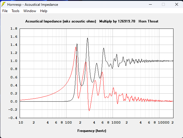

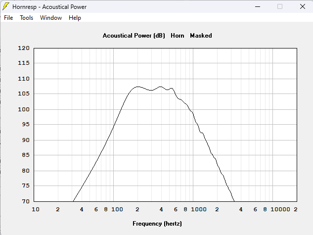

There is minimal ripple in the power response, so the peaks in the horn throat acoustical impedance are not a problem.
The electrical input impedance should not be an issue.
If tightly coupled to a corner, then 0.5 x Pi (eighth space) would normally be used.
In your case though, to be conservative I would probably just keep using 2.0 x Pi (half space) rather than 1.0 x Pi (quarter space).
