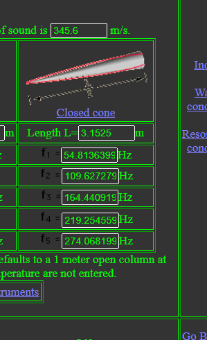

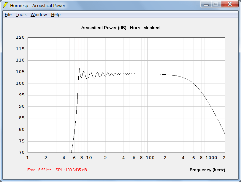

7 hertz 2Piwhats the lowest freq you can create as a real ‘horn’ (simulation) using horn response with a mouth CSA max of 99,999cm2(I’m assuming that dictates the half wave length of ~316.25 cm/54 hz?)

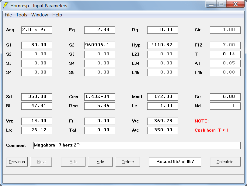

7 hertz 2Pi attached .
Not sure if hornresp can calculate a tuned pipe in the kilometer range.
Not a problem .
L12 + L23 + L34 + L45 = 99999.99 cm + 99999.99 cm + 99999.99 cm + 99999.99 cm = 4 kilometres (to 6 decimal places)

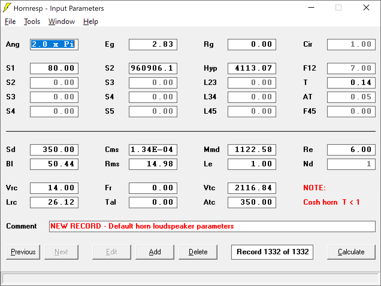

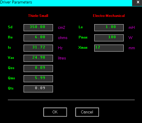

What does this input screen look like for this curious monster horn ?7 hertz 2Pi attached .

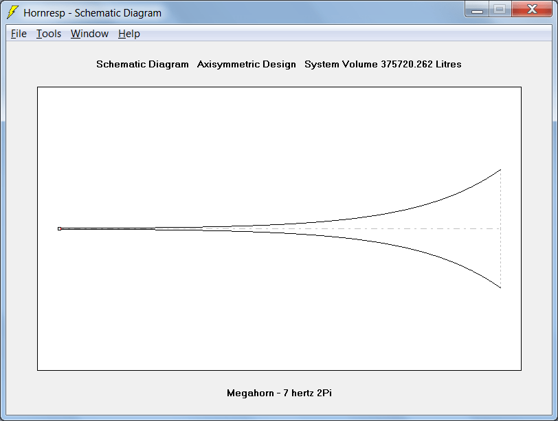

Great minds think alike - my input screen, produced completely independently, is only slightly different to the one posted by Mark .What does this input screen look like for this curious monster horn ?
The 7 hertz "Megahorn" design has an axial length of 41.11 metres and a mouth diameter of 11.06 metres!
