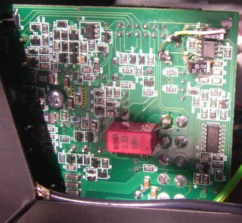

deandob said:Yes, the LM4562 can be swapped in but the CRD's need to be connected to the positive supply, not the negative supply as per the CRD connections on the circuit board. You can cut the tracks and hard wire them to suit (dont forget to reverse the orientation of the CRD).
Add tantalum caps about 4.7uf to both supply rails of the opamp, soldered across the opamp supply pins or close by.

Do you have a picture of your UCD 400 showing the mounted LM4562 opamp mounted with the CRD on the + rail?
Thanks in advance.

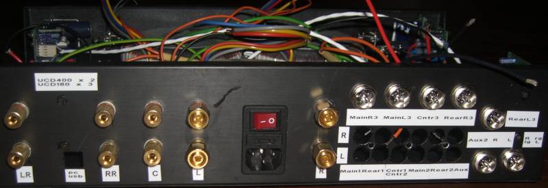

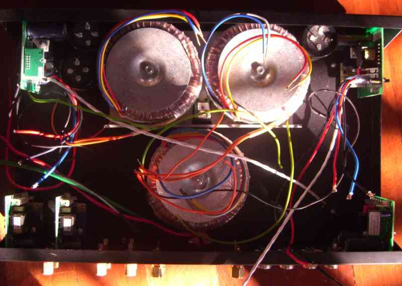

Photos of my 1/2 built UCD amp showing the CRD and LM4562 mods.
If anyone is interested in the specs for this 5 channel amp:
- 2 x UCD 400 with CRD power supply mods & LM4562 opamp with tantalum power decoupling & CRD mod (+ve rail which means I had to hack the circuit board to make it fit). Also has Panasonic FC caps and replaced the output filter with 2 x 330nF MKT caps.
- 3 x UCD180 with OPA2134 opamp, MKT output filter and Panasonic FC caps, CRD on the power supply but not on the OPA.
- L + R channel have dedicated supplies, each has a 300VA toroid with Schottky rectifiers, dual bridges per rail and T-Network 10,000uf caps.
- Center + 2 x rear have a shared supply with 300VA toroid + 10,000uF slit foil caps, dual schottky rectifiers
- Input for 3 x unbalanced + 2 x balanced inputs
- 5 channel relay shunt volume control
- Input & volume controlled by a microcontroller that is connected to a PC via USB. This amp is for a dedicated home theater PC which has an EMU 1820m soundcard for analog outputs connected to this amp (as well as TDA1541 NOS DAC). The PC will control the output and volume of the amp and I might also add IR control also.
Dean

Hi Dean
the output filter cap was already a MKT
To have an improvement , i think you must replace with MKP
Alain

Question for a UCD 400AD:
1. I think I have read that the + & - opamp power rail decoupling caps are creamic surafce mount .1uf. Is this value correct?
2. Can those caps be totally replaced (in lieu of just bypassed) with a film cap like a Wima MKP2 which goes up to .33uf 250V with 5mm lead spacing?
Thanks in advance.
Thanks in advance.
Steven,
Yes, they are 0.1uF ceramic SMD. IMO not sufficient given the distance from the regulator & the regulator design. Adding a higher value cap here should give the bass a bit more weight althought to be honest I did not try a before/after test. Yes, you could just replace them, especially if the combination of the ceramic 0.1uF and a higher value cap creates a resonant circuit with ringing (check this with a CRO).
Stephen,
You could do that also. Try it and see what you like better. Tweaking is pretty much to personal taste, and these modules are pretty good just standard so there is no right or wrong. There is plenty of info in this thread about what others have tried if you care to read back.

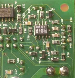

LM4562 vs. AD8620
I did the change to LM4562 an month ago and had a mixed feeling: after an hour of burning in, I was pleased with the more open mids and highs, the extreme transparency and the HF seemed to go unlimited. The ADs sounded more restricted, and as if just above 20kHz they would cut off. Not with the LMs. Most surprising was the low midrange, which had more presence and nice grain, making voices more palpable.
But the Bass was less weighted, almost recessed (although it was tight and articulated); on small speakers it sounded unsatisfying. Even some big speakers lack of weight in bass. Now, after almost a month, it seems to be better, even not perfect, but I don't regret the swap, and will probably work on the supply to get it better.
Definitively the best choice for the UcDs.

Stevenacnj said:BGT
2. What was the difference in sound quality between the AD8620 & LM4562 on your UCD 400?
Thanks in advance.

Re: LM4562 vs. AD8620
I'd agree with that for sure
sounds just like what I'm hearing here after changing the AD8620 to those LM4562's!
Yep. Same here. I'm looking for ways to get a little more presence in the bass, which I'm hoping I can tweak the source for. Let me know what you find.
Did you try additional 4.7uF supply decoupling caps near the opamp? It made a small difference in the bass weight.
Dean
