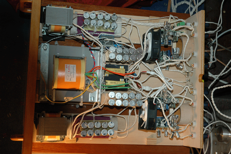

![zl_hypex.gif](/community/proxy.php?image=http%3A%2F%2Faudioprana.free.fr%2Fzl_hypex.gif&hash=f0dd76a121d48b6df9012ead5884ce7f)
matjans said:looks like an accident waiting to happen...
![hot :hot: :hot:](https://files.diyaudio.com/forums/images/smilies/hot.gif)
What in the world did they do to those modules?
![bawling :bawling: :bawling:](https://files.diyaudio.com/forums/images/smilies/bawling.gif)
They mounted them the worst way possible with the top of the T sink downward. They wouldn't even need fans if they just mounted them properly and used a reasonably sized heatsink...
