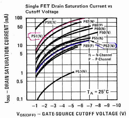

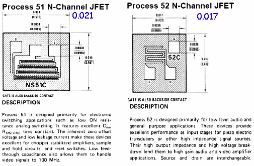

The "process" is mainly the die layout, first picture. P51 is a fairly large die with a fairly large JFET on it. P52 is a slightly smaller die with a much smaller JFET on it.
This gives a *spread* of curves, second picture. All the curves are much the same shape. Where a specific device falls left-to-right (Vgs) depends on "baking", time temp and chemistry (not precisely controlled). But the P51 curves lie 10X higher in current than the P52 curves, because P51 is a bigger device than P52.

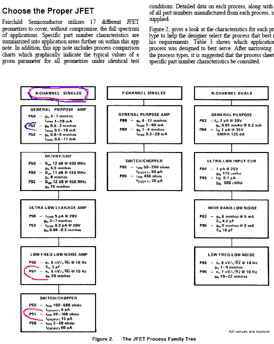

But what do you know about picking? They give you a "Proper JFET" table, third picture. JFETs can be good for 100MHz, so our <100KHz audio is Low Freq and we want Low Noise. Buying N-type Singles, we are led to P51 as one suggestion. However this is a 10mA-100mA Igss part. If we realize we may run nearer 1mA, we may look at General Purpose Amps and P52 is a suggestion.
I never found "Process" to be much help (good insight thought). There's some trends: P53 must be a teeny device which makes sense for low-low Gate leakage- indeed that is what P53's description shows and suggests. P58 is a fat beast and parts from the right end of the curve may be low-R switches (and cost more due to large 3-row die).
But we have to buy *parts*, not processes. A part is selected from a Process and the left, center, or right areas of the spread curve. Then further sorted for breakdown, leakage, or other valuable features. Then put in a Package, giving dissipation and pinout. Yes, if say 2Nxxxx is "almost right", you might look up its process and find similar parts with the difference you want. I've never done that.

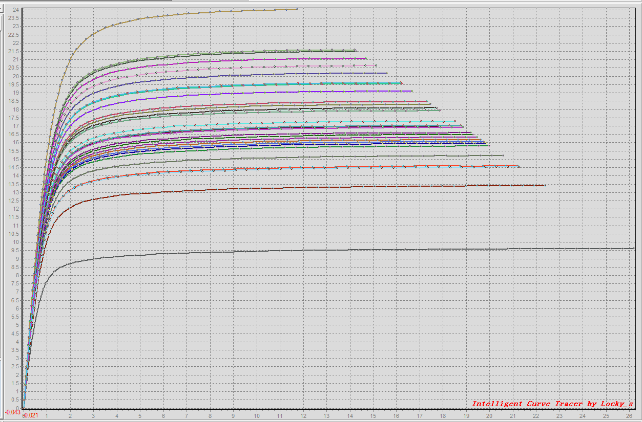

When I test a bunch of Fairchild J113s, I routinely see a 5-to-1 spread of Idss.
In current batches of that Fairchild part, I'm not seeing that. Out of couple
thousand parts, a few are maybe 14 mA, and the bulk are 19-20 mA or so, with
a few at 22 or 23. Nothing outside that, and they are not all from the same
boxes.
Maybe they learned something from Toshiba....

I asked myself, how many parts can I test in 10 minutes? The answer is: 31 parts. Here they are: VDS on the horizontal axis, IDS (in mA) on the vertical axis. Vgs=0 in all cases. The flat zone is the number everybody calls "Idss".
9.5mA to 24mA in a population of only 31 units. They must send ME the ones they don't send to YOU!

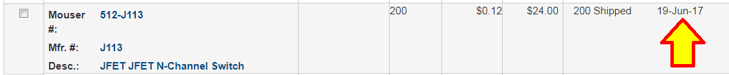

Purchased very recently, see attachment 2 (yellow)
boxes.
Maybe they didn't. Last batch Idss about 35 mA
