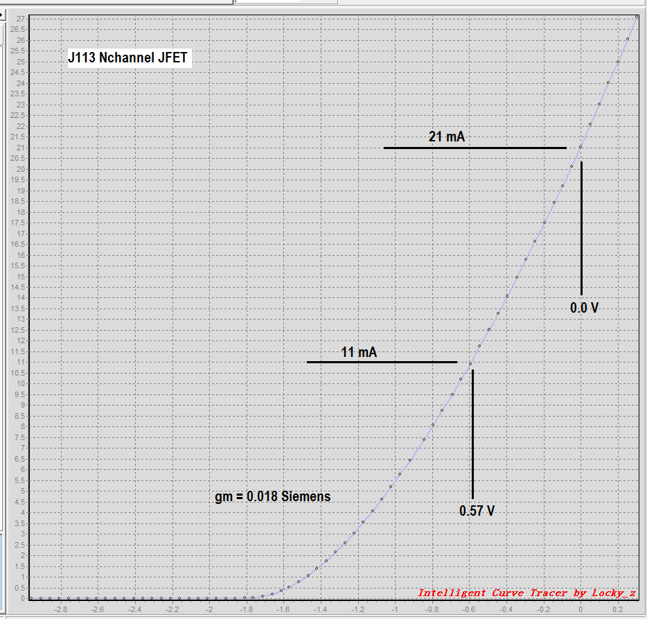

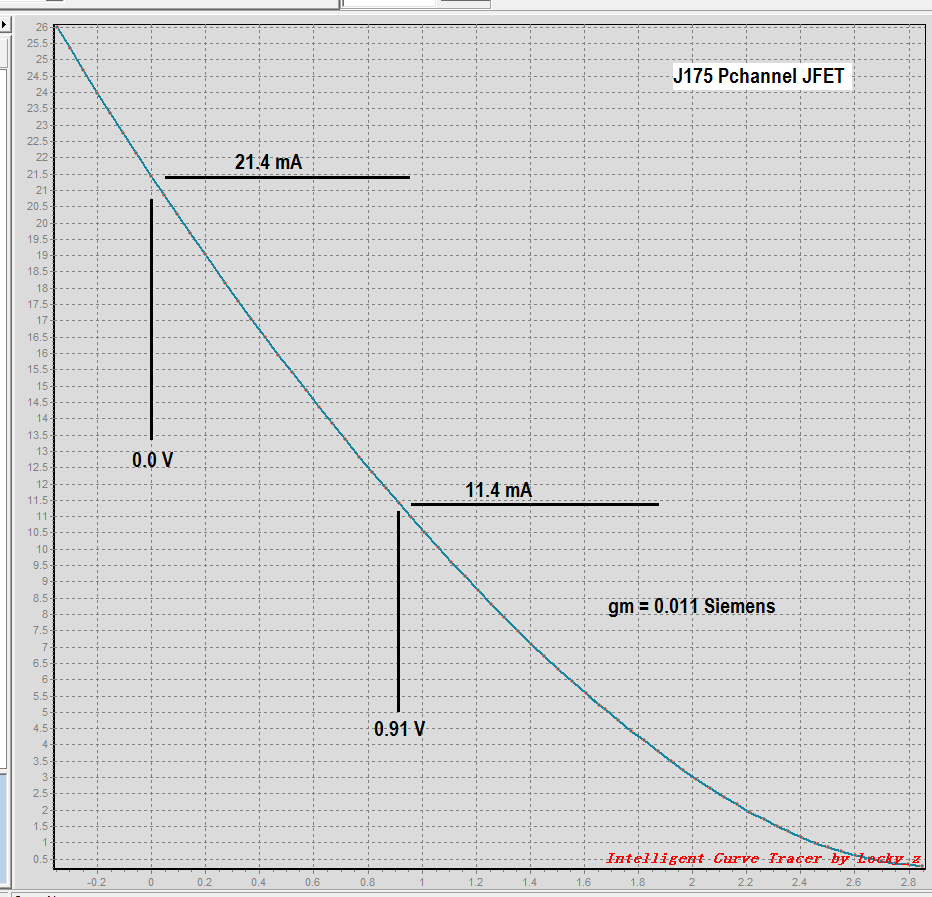

Here is an example which illustrates what Nelson is talking about. This is an Idss-matched pair of Fairchild J113 + J175. Although the Idss values are the same (21.2 mA), the transconductance ("gm" == slope == dI/dV) values are NOT the same. Pew.

What I've been saying get the beta (gm parameter) to match not Idss. I tried to make this clear to the guys at Linear Systems, the first samples of J74's had low beta (gm parameter) and trying to change things to increase Idss might only increase Vp also. Last I looked they were more on the right track.
More importantly the process on the P seems hopelessly noisy.
Having gone through this exercise previously, I found that the P's and
N's of the Fairchilds are not similar enough to easily give really low
distortion as complementary parts. If you don't mind a little 2nd harmonic,
then you're OK.
You can tweak around with them to reduce that 2nd, but it's pretty tedious
and cumbersome. The Toshiba/LS parts were designed as complements
for amplifiers, and so they perform better without extra effort.
The problem is that the P channel devices have a lower transconductance, so why not double up on them?
The best match I get (so far just in my simulator) is with one J113 and a pair of J177 in parallel.
The J177 is only available as smd though, if you need legs two J176 with one J113 or J112 also seem to work pretty well.
