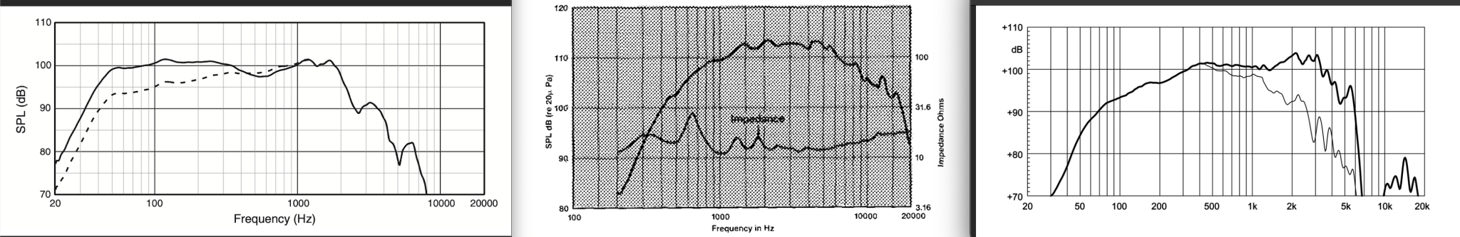

Hello, I am new here and in this topic. I have two JBL ASB6125 (each with 2 x 15") and two JBL-2450H (2" compression driver) with JBL 2385A horns. Now I am unsure whether that is all I need to cover the full spectrum, especially for ambient lush electronic music mostly from analog synths and punchy kickdrum plus additional acoustic instruments for live jams. At the moment it sounds good but I dont have a direct commparison so cant really tell if something is missing.
Now someone mentioned I should get a 10 or 12 inch to cover the midrange better. But at least on paper the frequency overlap nicely and I dont want to muddy things up. I noticed a dip in the 400-700Hz range of the ASB6125 so I was looking to cover that area with the recommended additional driver. I found the Eighteensound 12ND710 would cover it well, at least on paper. Then I heard that perhaps the dip is there on purpose to bring out voices better. So im a bit confused right now 😕
JBL ASB6125 (left) -- JBL-2450H (middle) -- Eighteensound 12ND710 (right)
I am quite happy with 2 way 15" + 1.4" CD on horns. +- 3 db 54=17 khz. Sp2(2004). How deep it your 400-700 hz dip? It may be easily cancelled out by a DSP or graphic equalizer. Much lighter to carry around than another pair of boxes, plus another amp.
Much more likely to be +- 6 db or more dips or bumps 100-500 hz due to room effect. Those have to be equalized out for each setup. If you are picky. A crowd of cloth wrapped listeners breaks up the standing waves some. Electronic instruments, nobody but the musician knows what it was supposed to sound like in the first place.
Thanks for your feedback! The dip of the ASB6125 can be seen on the attachment and is just 3-5 db or around 97 db between 400-700 hz after being on or above 100 hz. It almost looks as if it's there on purpose because at 1000 Hz it's back at 100 db and only after 1100 Hz falls off.How deep it your 400-700 hz dip?

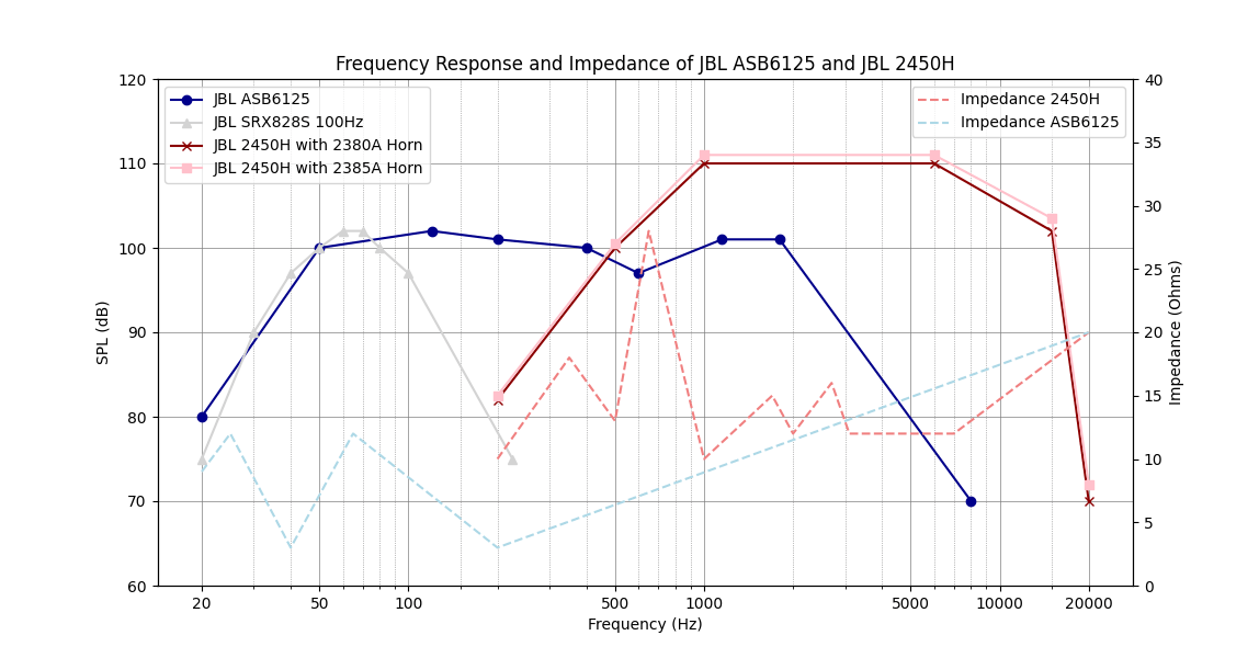

Yea thats a good question. There's lots of punch and someone said 15" can be punchier than 18". I plotted the frequency response graphs of a JBL ASB6125 dual 15" sub and of a JBL 2450H compression driver. At least in theory, I wouldn't need anything in the mids and even a dual 18" sub like the JBL SRX828S wouldn't add much.Are the 15’s providing enough bass, can it do it without strain or overload, and will more be wanted in the future?
Don't listen to "someone".someone said [...] can be punchier
Listen to your system and add some dB in the ~ 100 Hz range and adjust to get punch!

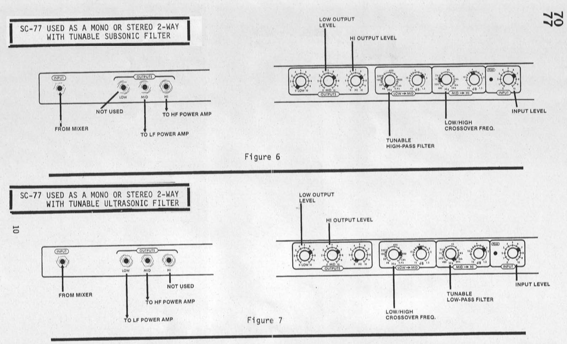

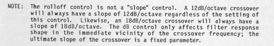

The ASHLY XR77/12 (a black-face version of the Blue 1970's era SC-77) flexibility ("infinitely-variable controls") made it grossly inaccurate ("typically within 1/3 octave").
You probably would not want to play with a musician who was "typically within four semitones" of the correct note
Identical settings result in different crossover frequencies and levels L/R.
What was called a "rolloff control" is labeled "dB":
24dB per octave filters became the de-facto choice for PA speakers by the late 1970's, the ASHLY XR77/12 brings back memories of replacing dozens of shattered or burnt diaphragms back then.
It has no EQ compensation for your JBL 2450H/2385 horn's 60x40 degree constant directivity -10dB high frequency rolloff.
The ASHLY XR77/12 has no polarity reversal switches, though it (probably) reverses polarity between low/high, and mid/hi, as required for a 12dB/octave IIR filter.

The same 15" driver (2265H) is used in JBLs AE lineup where it is crossed directly to HF horns in the fullrange cabinets, so I don't see that being a problem here. If the cab needs some internal damping that is relatively easy to add. The XTA loudspeaker processors get good reviews.. https://www.xta.co.uk/products/4-series/

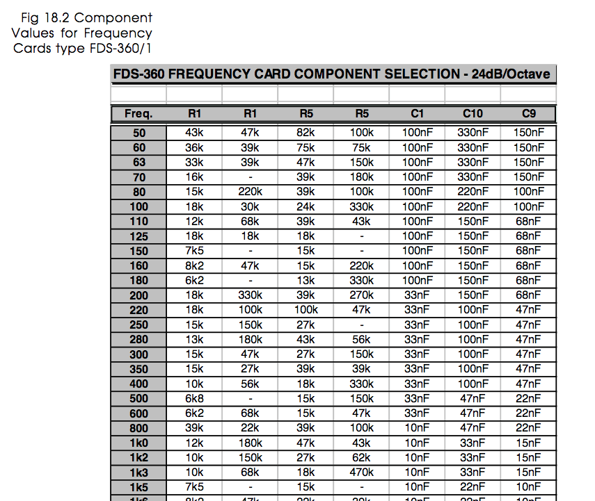

The LR24dB/oct BSS FDS-360 sounds far better than the ASHLY XR77/12, is dead on accurate and has (peak) limiters. It's peak limiters are pretty obvious when they kick in..Just unpacked the ASHLY XR77/12 and will test it once I get the XLR to TRS cables. If all goes well I can get a BSS FDS-360 for 200 and compare both
The FDS-360 crossover points are fixed, you have to re-wire circuit boards to change frequencies.
800, 1K0, 1K2 would work OK:

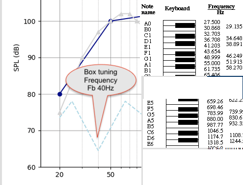

It's HP filter card (low cut) is normally set at 30Hz, a bit low for your box tuning frequency (Fb) of ~40Hz, near the low E1 frequency.
Below Fb, the output of the ports and drivers go out of phase, the driver "unloads".
A 35Hz HP would be better to keep your lush analog synth patches from uselessly flapping the cones.
The low B (~32 Hz) is several notes below your cabinet's tuning.
You could lower Fb by extending the ports, put output would be reduced. As a two way, 40Hz is a good compromise Fb.
