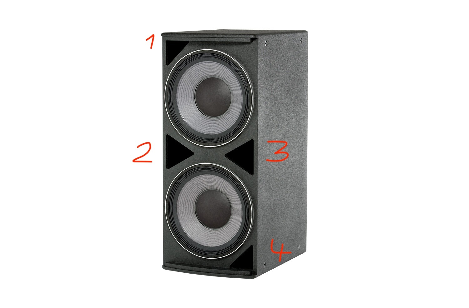

The specs of the dual 15" JBL say "1350 W (5400 W peak)" so for each of the two 15" it would be 675W (2700W peak) right? What would be the optimal power of the amp per channel? When I had the Behringer NX-6000D going half way was already LOUD and in most cases we won't need so much. The PLX 2402 was 300 and I could use it for the JBL AC18/95. So I'm still looking for a decent amp for both JBL ASB6125.700/2=350w per driver as you are running now.
350 watts is not much for a speaker rated for 5400 watts peak power handling capacity,

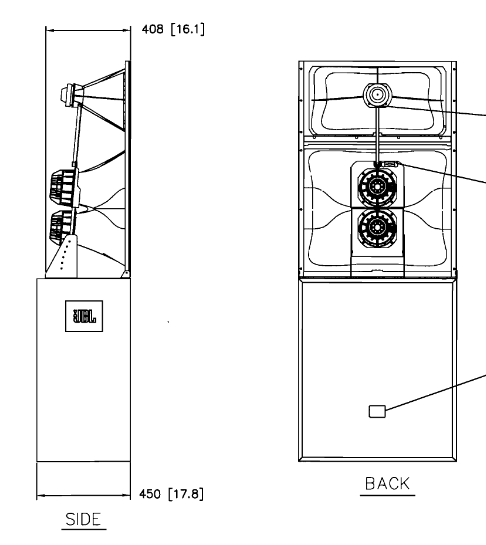

Thank you for the picture but I cannot make complete sense of it. It looks like the back of the CD is embedded in the box and protrudes outwards. But the JBL 2450H as Hifi connectors at the back and I need to connect them to Speakon sockets. Hence they can't be outside but must be inside the box with the Speakon socket facing out. How about cutting a hole in a board with the diamater of the CD at point A (see below) and mounting that board inside the box? There are also holes at point B but they have no thread and I have no clue what they are for?so a circular support would be best, like this example

Do you know how this support usually looks like? Would the board with cutout at point A (see above) be the correct approach?Yes some support for the compression driver is a very good idea.

There are lots of possibilities, you can find metal brackets that mount between the driver and horn, this drivers appears to have mounting eyelets so you could do something as simple as bolt a small L bracket to one of those holes and then attach that to a block of wood that sits under the driver.Do you know how this support usually looks like? Would the board with cutout at point A (see above) be the correct approach?
Yes, you have divided by 2 correctly.The specs of the dual 15" JBL say "1350 W (5400 W peak)" so for each of the two 15" it would be 675W (2700W peak) right?
Around 3000-6000 watts peak into 4ohms would allow the JBL ASB6125 to reach their peak output potential, which could damage hearing of anyone near the speakers not wearing hearing protection.What would be the optimal power of the amp per channel?

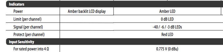

The NX-6000D can do ~3000 watts peak into 4 ohms, or 1600 watts into 8ohms per channel.When I had the Behringer NX-6000D going half way was already LOUD and in most cases we won't need so much.
It has useful power indicator LED lights:
"Limit" illuminates when ~ 3000 watts peak into four ohms is reached,
The amp will limit power to under that if the input exceeds 0dBu (.775volts) with the input volume control turned fully clockwise.
Most mixers can exceed that level by 20dB or more.
"-3dB" illuminates ~ 1500 watts (half power).
"-6dB illuminates ~ 750 watts (1/4 power).
"-40dB" illuminates ~3 watts.

The picture showed exactly that, a circular support hole the diameter of the EV DH1A compression driver at point A cut into a piece of plywood.How about cutting a hole in a board with the diamater of the CD at point A (see below) and mounting that board inside the box? There are also holes at point B but they have no thread and I have no clue what they are for?

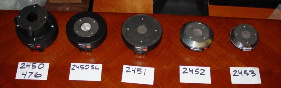

The "holes at point B" attach the 2350's 1.5" to 2" throat adapter.
Without the adapter, the driver would be a 2450SL, a 1.5" exit driver.
Horns are made to fit specific throat diameters.

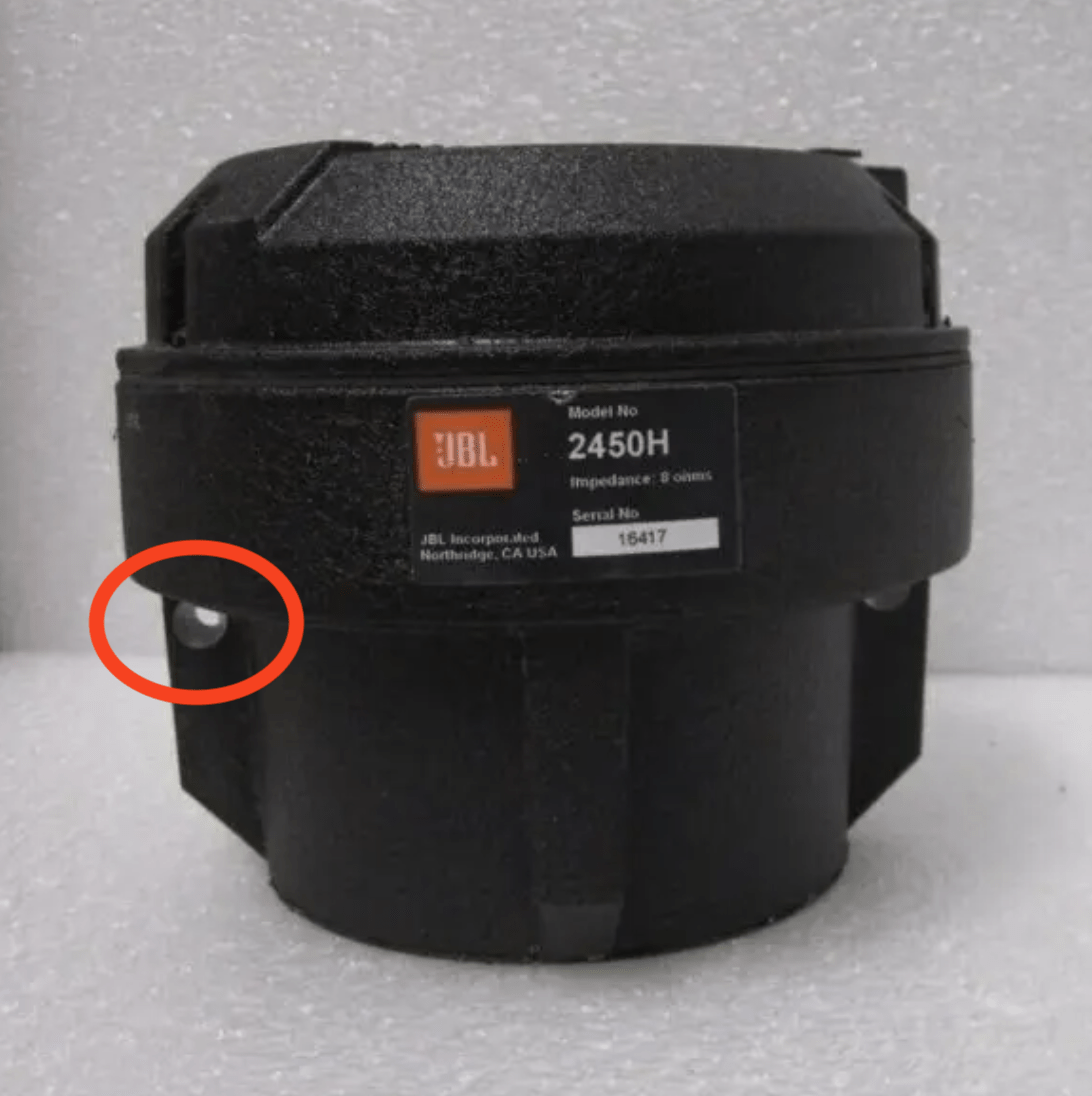

Thanks, I didn't know the difference between these. But I actually meant the holes as seen below. Do they have any purpose? They don't have threads, just holes.The "holes at point B" attach the 2350's 1.5" to 2" throat adapter.

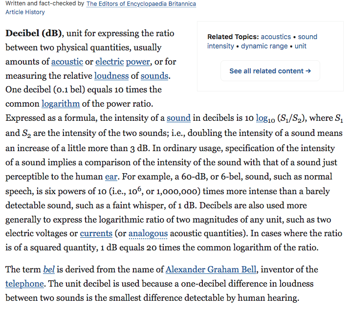

You are confused because you are not yet conversant with the inverse square law and the concept of the decibel, a unit used to measure the intensity of a sound or the power level of an electrical signal by comparing it with a given level on a logarithmic scale.
The decibel and inverse square law are as basic to sound as the 12 note octave scale is to western music.
The decibel concept is now 100 years old, I only became aware of it about 50 years ago (-3dB)Also your dB > Watt chart shows extreme diminishing returns beyond 1000W. Should I not scope the amp to this level, i.e. a little above 1000W per channel?
What you call "diminishing returns" is inherent in the logarithmic nature of sound propagation and perception.

They can be used to attach shackles or support brackets similar to this JBL cinema system:Thanks, I didn't know the difference between these. But I actually meant the holes as seen below. Do they have any purpose? They don't have threads, just holes.
